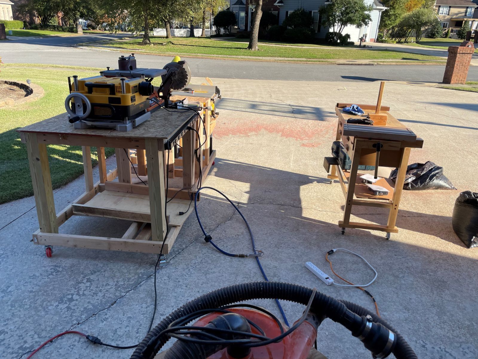

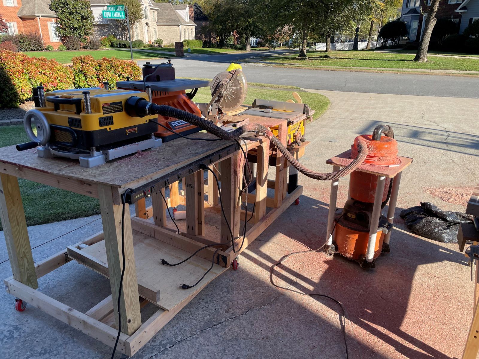

Today I was milling a ton of Eastern Cedar boards that I am going to use for my grandson toybox Christmas build. When I went to empty my dust collection I got the snot shocked out of me. It was loud enough that someone across the street asked if I was okay. Notice my bucket was charge pretty good with shavings clinging to it. I thought maybe my hose was touching something that was not grounded so I changed it's position. The next time it was time to empty out the bucket with gloves on I got bit hard again. I had everything plugged into the same power strip so i decided to unplug everything in that power strip except the planer. I plugged the dust collection into a separate power strip that was plugged into a different power receptacle. Samething happened two more times.
I know this can be a very dangerous situation if indoors and dust is in the air. Are there some woods more susceptible to static than others? What should I look for to keep this from happening again for safety sake.
I have enclosed some pictures of my setup. In one of the pictures you can see the shavings "clinging" to the chop saw and hose.

Judging from the amount of sunshine, I think you are probably experiencing very dry air which can contribute to static buildup. Secondly, it looks like you have plastic hose for the collector runs. Plastic will also contribute to static development by air movement.
l don’t know if some species are more prone to static. I’m guessing that really dry wood might be more likely than wet wood.
A grounding wire setup should help drain the charge.
I am thinking along the lines Lew was. I would say somewhat like computer experts do and even in some offices before touching the computer they touch a grounding pad to discharge the static electricity. For your case use a grounded wire and touch it to the canister before you touch it. That would be easier to do than permanent grounding a mobile setup you appear to have.
One issue is that both the planer and the vac are double insulated and therefore not grounded. As the sawdust travels down the plastic ducting the friction between the duct and the sawdust produces a static charge which builds up in the entire system. The plastic ducting can build up a pretty decent charge which is transferred throughout the system. When you touch it you are essentially grounding the system. This is the reason all ducting needs to be grounded. The easiest way to do this is to run a small piece of copper wire through the ducting and attach the copper wire to grounding system. It is very important you do this before you use this system again. A spark from the static charge mixed with the sawdust in the ducting can result in an explosion.

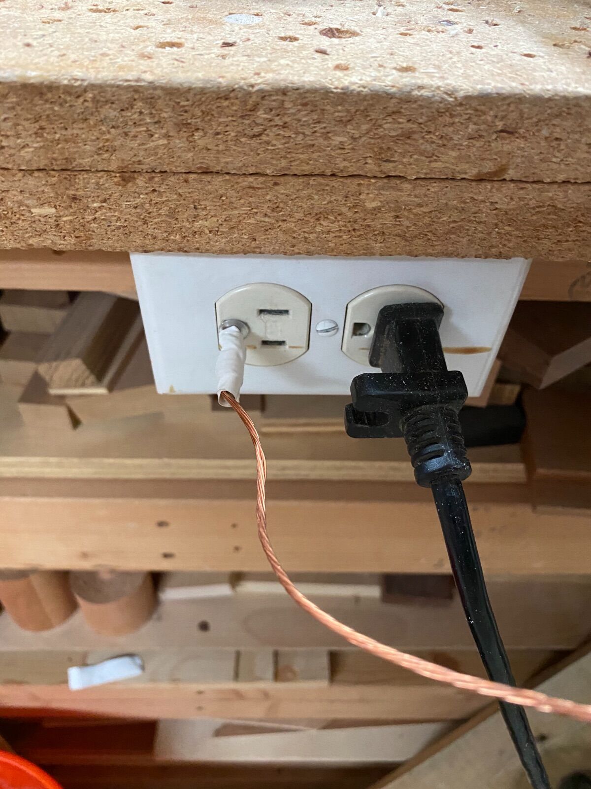

The best ground point would be a METAL COLD WATER pipe- assuming your house is plumbed completely with metal piping. The next best point would be the electrical ground point on a receptacle. You can make a grounding wire from an alligator clip and a banana plug- or purchase one.
The banana plug goes into the "Third" hole in a receptacle and the alligator clip attaches to the grounding wire of your plastic hose

The copper wire will be inside the ducting. One end will be grounded using the above mentioned methods. The other end doesn’t need to be attacked to anything. To keep it in place disconnect the duct from your tool and run the wire out of the duct and use the clamp on the duct to hold it in place.
