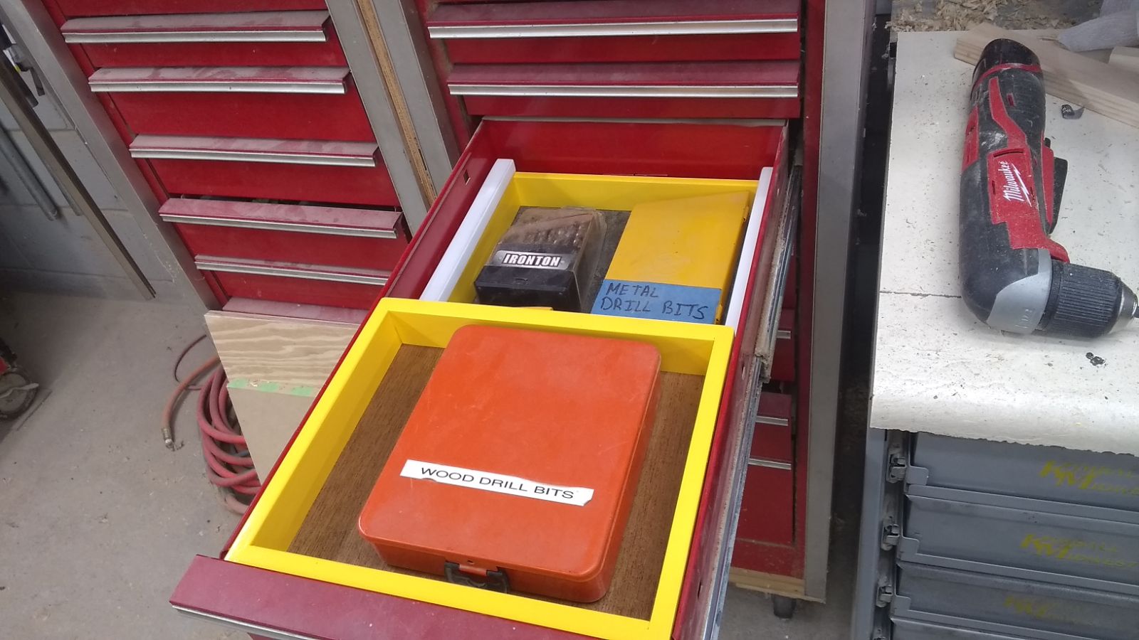

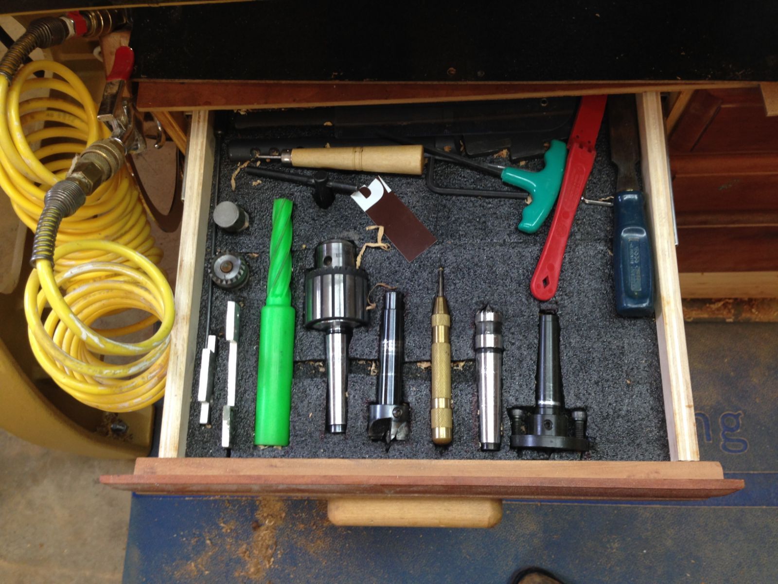

I have a suggestion . Add some Kaizen foam and cut out for jaw sets. Like this but do not have pic of the chuck drawer.

Don't have everything in it but do have two drawers of accessories like the one above and chucks, two drawers of gouges, two drawers of wood planes, chisels, and another of flat ww measuring tools. Out of two 2 inch thick sheets only have less than half of one left now.
One thing is if you decide to move or sell a tool just cut out a square and fit another piece in its place.

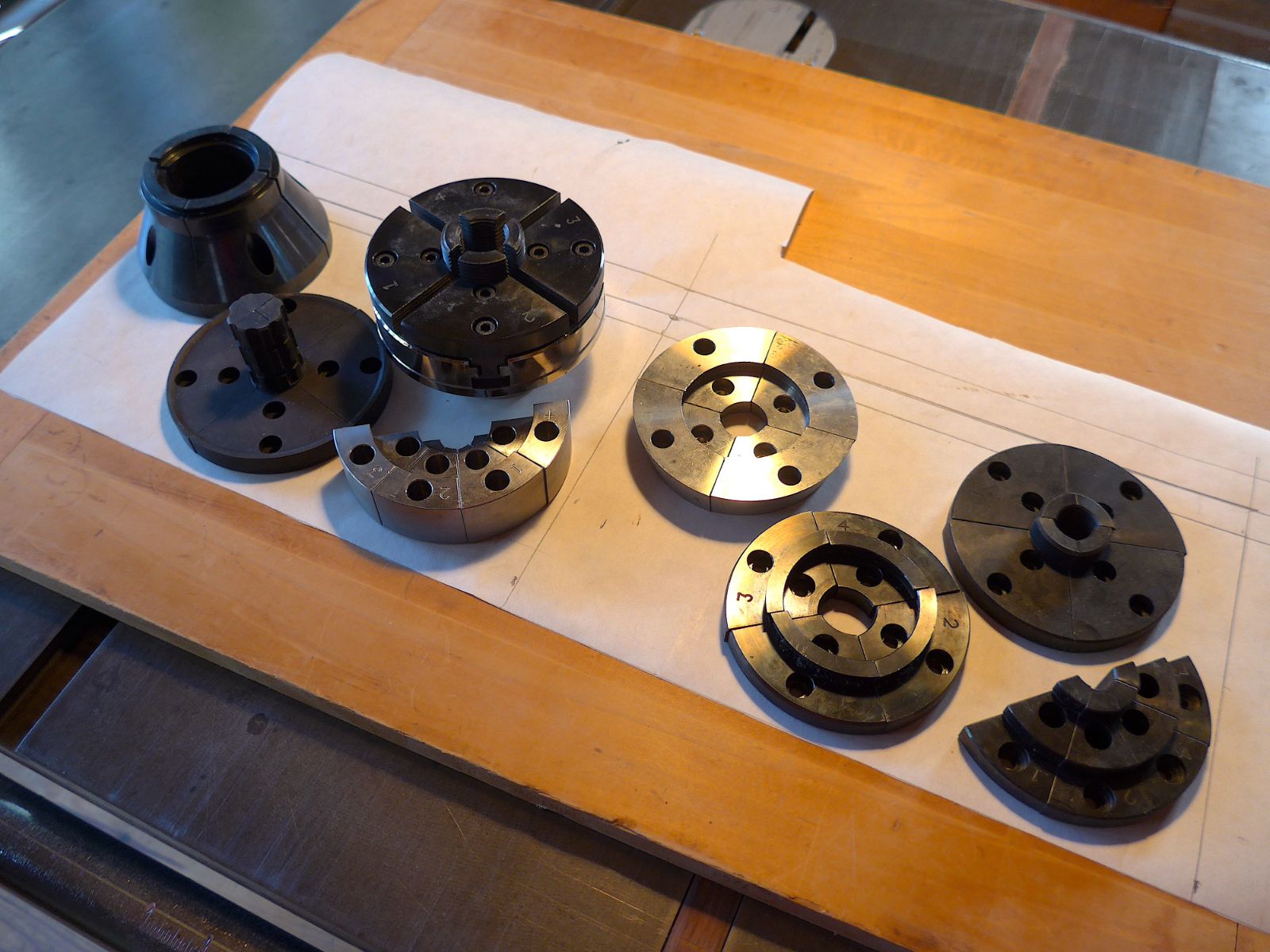

Here's the plan. I've got the jaw sets and chuck laid out on two tray drawings. These will fit into the interior of the box. The first photo shows the jaws sets that I picked up and the second photo shows the layout of everything, given the interior dimensions. 3/16" dowel rods should act as the 4 "posts" for each set. The chuck itself will fit into a drilled hole and won't be in the box for storage but for future storage. I've realized that these two trays will be the equivalent of making another, smaller box( 8 sides and 2 bottoms), to fit within the bigger one.

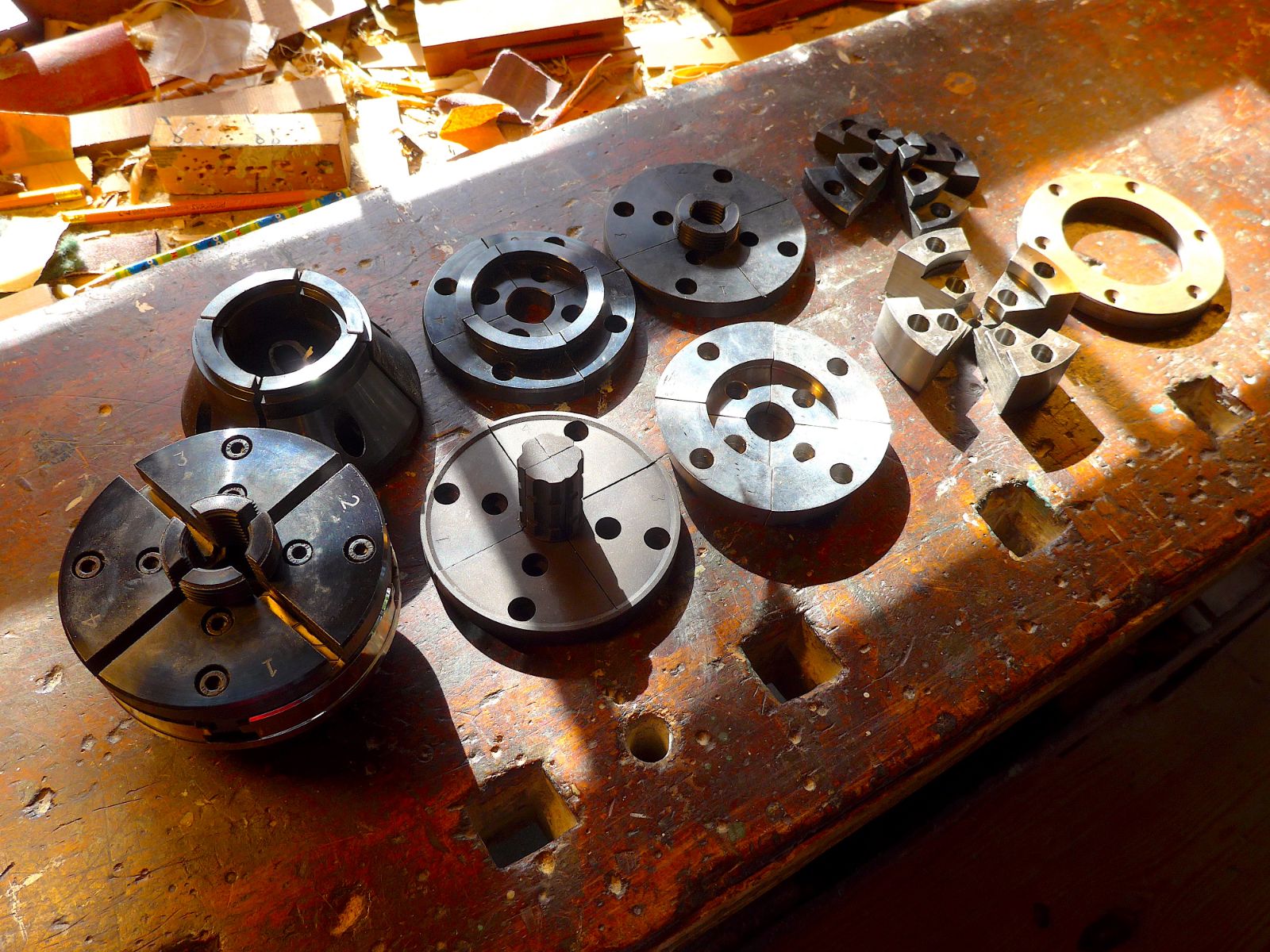

The first photo shows the layout of the drawer bottoms, with the dowel pins in place, the second is showing the jaw sets in place, and the last photo shows the two inner boxes, ready to be placed into the larger storage box. All done! Thanks for all of the suggestions everyone!!!
Had wondered how you would lift out the top layer, but now I see and that is superb. One suggestion is instead of dowels another layer of ply with circles cut out in the diameter of the jaws. Another thing you can do is to turn a flat bottom bowl for each set of jaws. I think placing them on those dowel will get old.
