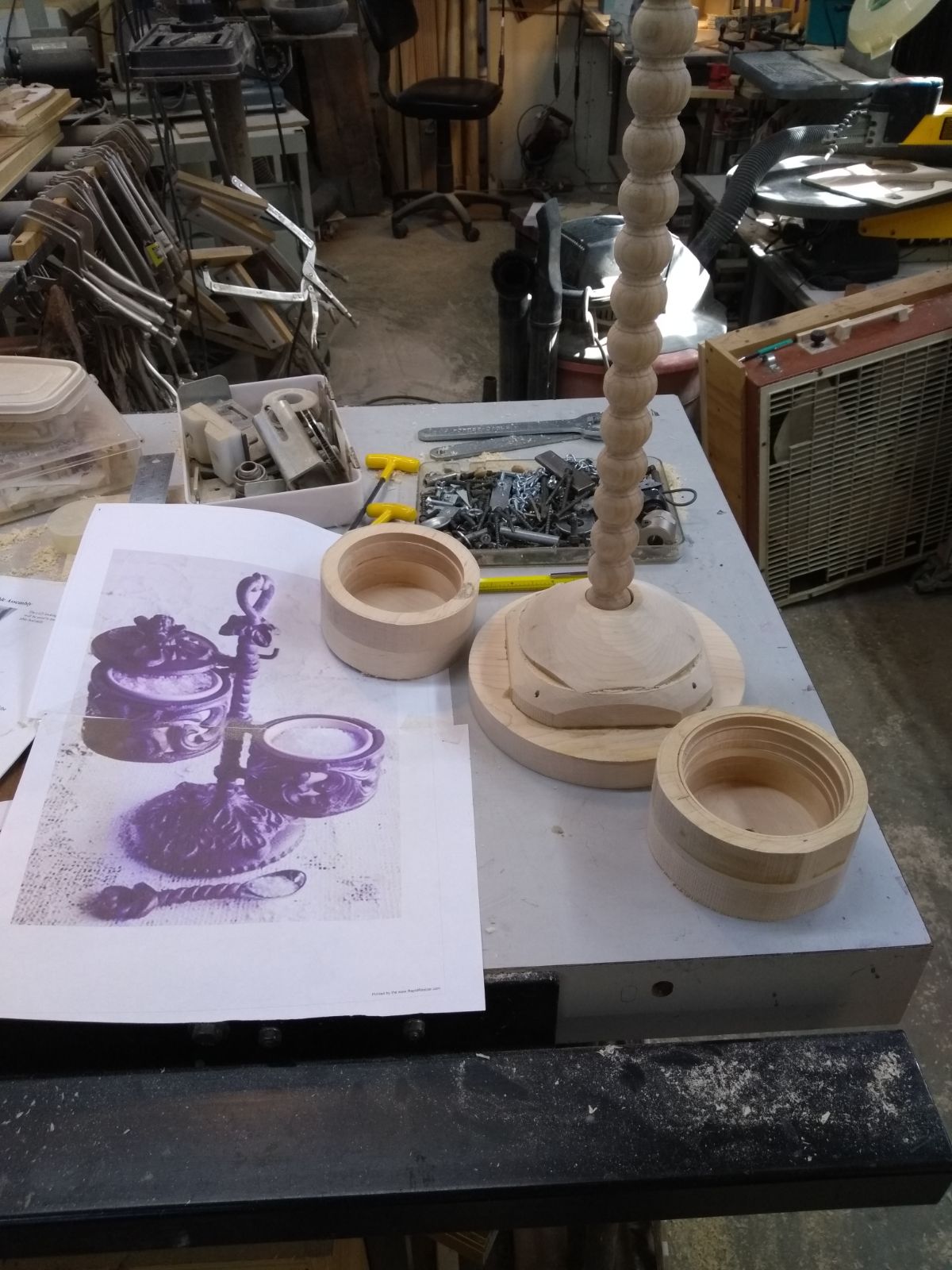

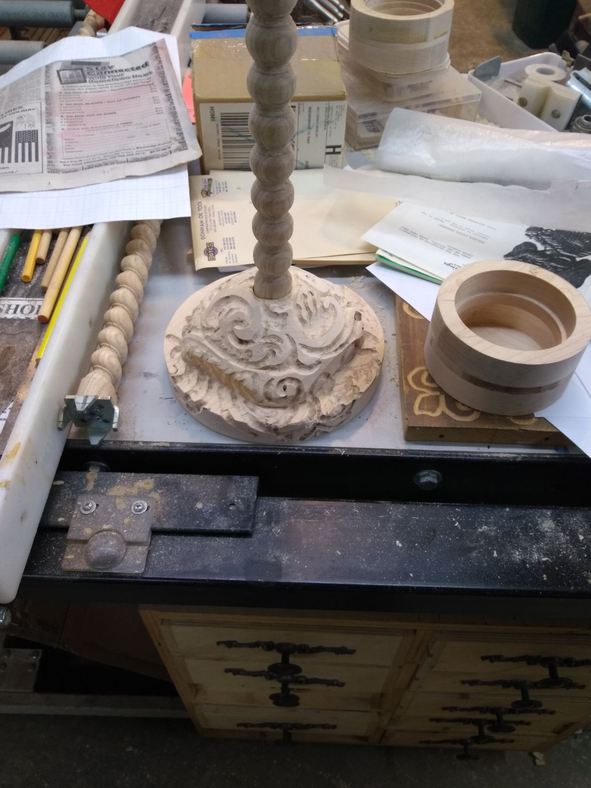

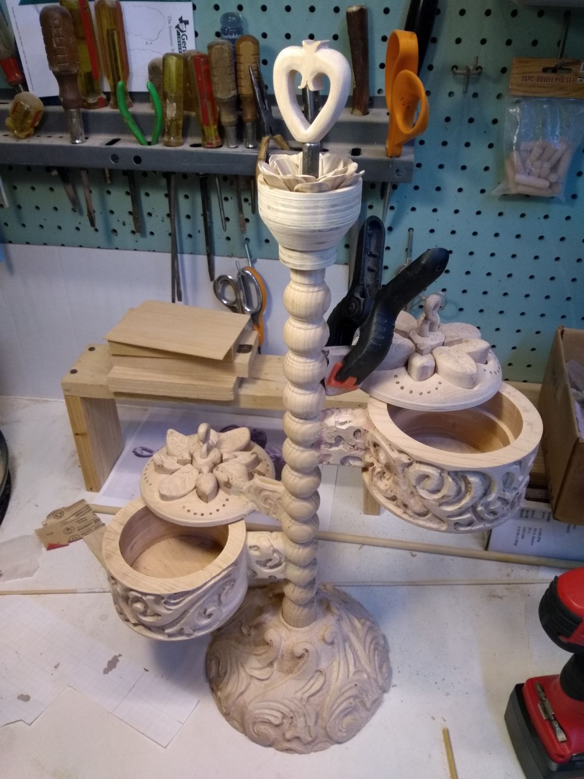

The picture is about shot but maybe I can add other shapes and goodies???? I did find a couple of glass containers to hold the sugar and what ever that other stuff might be? No idea yet? Even though I had the big vac and the outside dust extractor going the mill really kicks out the shavings.
  And now after looking at the picture real good I think I need to make a different shaped center pole every thing will be stacked upon.

    Don't give up on it for what you have shown so far looks great!!!! I only had this morning to carve for this after noon we we would get our virus shots so I got in a hurry and did a terrible star

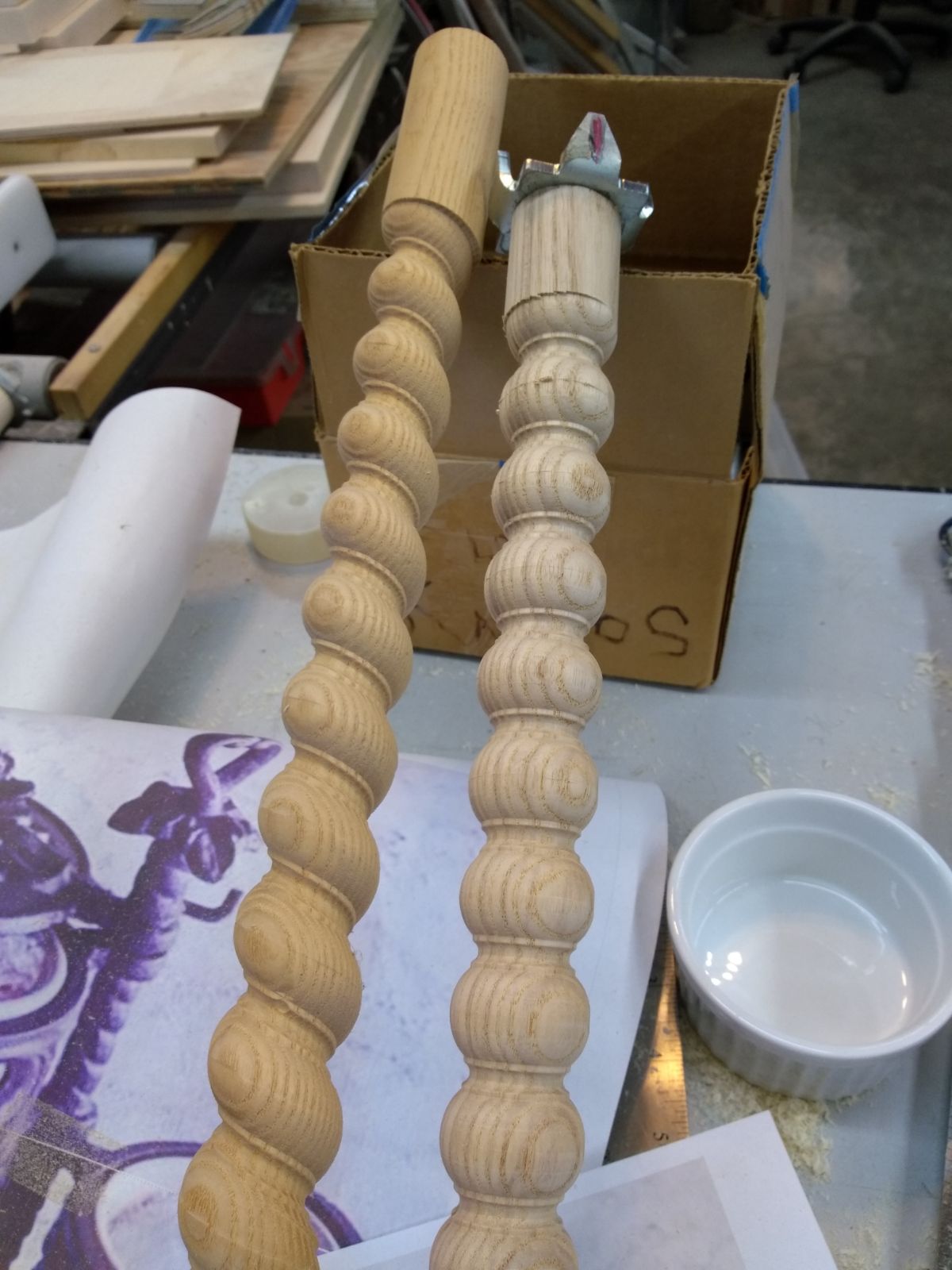

These are better.1904279516_IMG_20210303_145109241spindlesmadeeasyMarch2021.jpg.3d60b8f65be0bae351510fc7c83c4533.jpg
Trying to decide which spindle to use for the center of this thing I'm thinkin of building. I'll make me up a bunch of pieces before I decide if this project is a go or not.

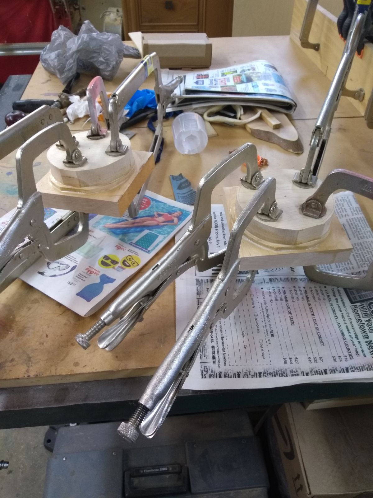

Next I glue up for the base and the two bowls these will be carved hopefully.1513686052_IMG_20210304_105620028thebase.jpg.4e008af0bef5dba4bf856e9b065250d8.jpg1132914280_IMG_20210304_105614119thesetwoareforthebowls.jpg.fdf57720bffeea6adc38ab7a42e219c2.jpg
When glue is dry I will put these on the mill since I don't have a  3 5/8" forstner bit and hole saws make the wood look like heck so I will let a router bit make the holes. This is why the bottom piece is not rounded yet for this is where the screws go to hold the pieces on to the rotary indexing table on the mill..17212209_IMG_20210304_112228690rotaryindexingtable.jpg.00ac09570e2479620b6b0db6ebb0e562.jpg

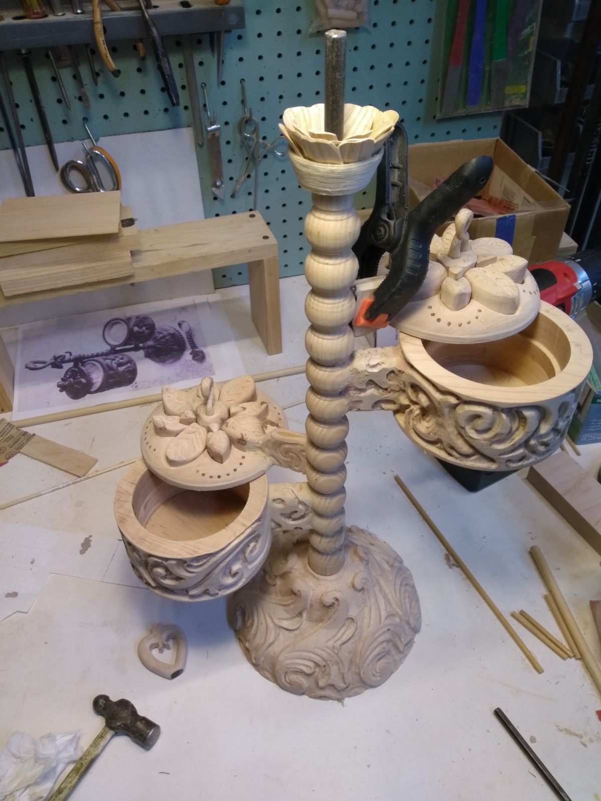

Now I need to find some small carving pictures to fit around these three pieces.1739892179_IMG_20210306_104840378carvedsugarserverforcenteroftable.jpg.f4aadd4c566357b03a8e3efcba15b61e.jpg
This thing is still looking terrible and it better start looking better or else I'll go outside and play. I still have to fashion some swinging lids and figure out how to attach them.
 I'm thinking I might add a tooth pick holder on this pole if I got room...
Now this should get real interesting.  You get to do a woodcarving that wraps around the bowl holder.  Is this like 4th dimension or something?  You're the man on this type stuff Jess!

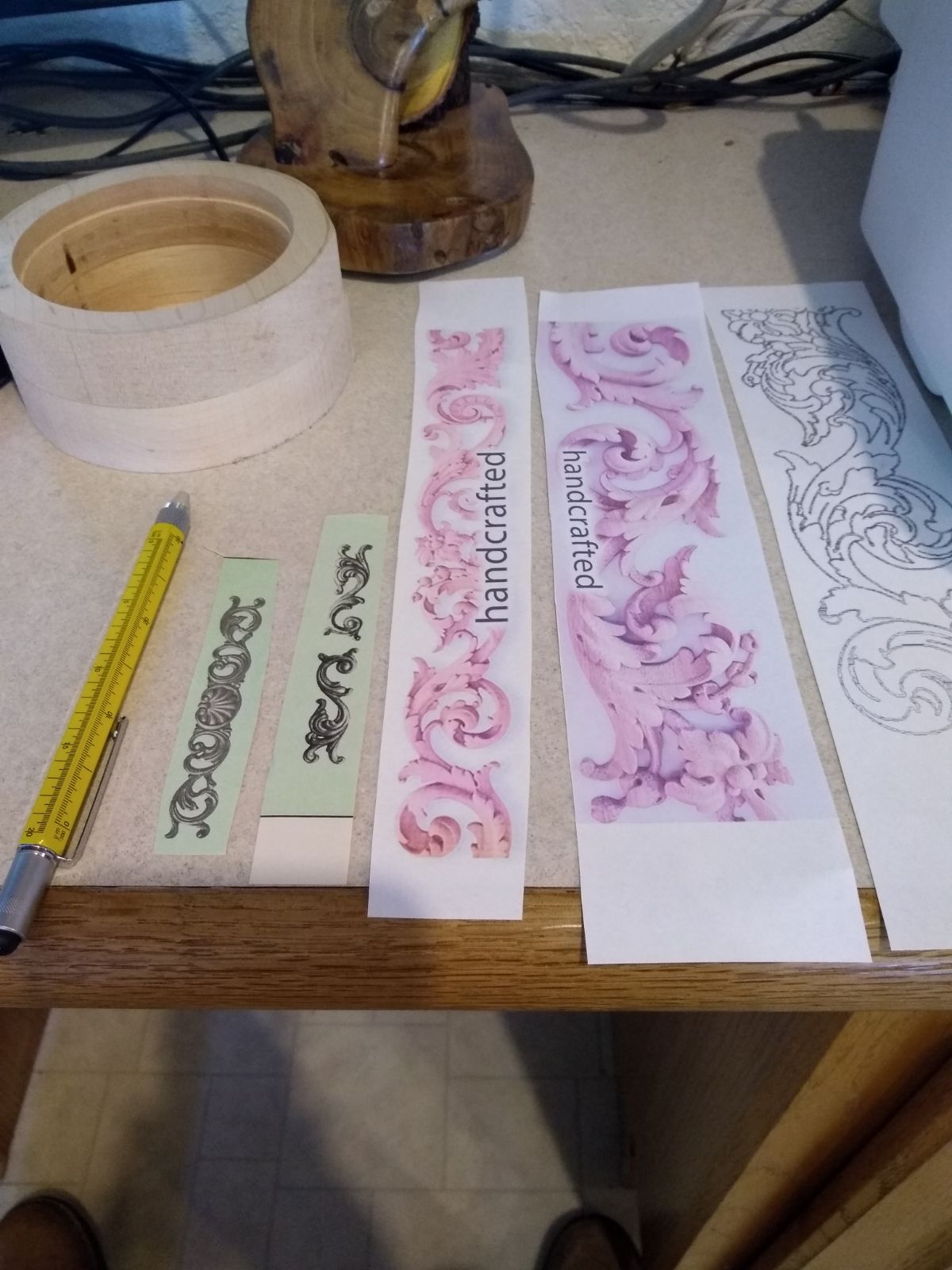

Cal I have been saving wood trim advertisements for years like the two small pieces here in the picture.1826003155_IMG_20210307_085428165carvingaddsfromorderbookssentyearsago.jpg.b90a52934c04750ccc18b4eb9dc7cae7.jpg
  If the pictures are clear enough to enlarge the size I will then just glue it on the wood and I start with a very small bit to grind the outsides of the carvings then wing it from that point on. And like the other three carvings in the picture I am reducing the sizes of these then kinda pick and choose which is easier to carve  but look the best when finished.. That is a double biting statement. Anyway, lots of fun just trying to figure out how the lids will move freely while being attached them to the pole.. I think I will drill a hole all the way down the pole for a metal rod 3/8" to 1/2"  for the lids to swing on. This was my thinking when I decided to not use the spiral for I will be sawing the pole in two in many places and cutting the spiral straight across would look bad???

I only had this morning to carve for this after noon we we would get our virus shots so I got in a hurry and did a terrible start at carving this pole base..1756709716_IMG_20210307_185045686Iwilldiscardthisterriblecarvingonthepole.jpg.5ddff08302ced2162c18c64abdf5115a.jpg
 I started this morning with no pencil drawings on the base thinking this would be a snap. It was a first step starting to carve.... bad, bad, after we got home and I couldn't even tell what I was doing so I decided to scrap it and glue up another base. so Tomorrow I will start again. So with a new base in the clamps I will draw out something and give it a go again!!!!

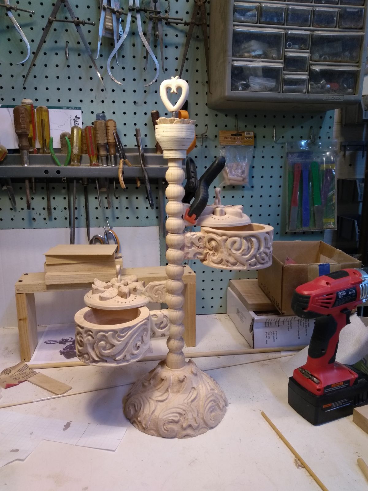

Okay I started the second base and canned the first one.2018763970_IMG_20210309_164926950startednewbaseforantiquesugarcontainerforcenteroftable.jpg.0b26b1e0096ad05798d66d67d22e8009.jpg
Still trying to learn. Sometimes my thinking don't match up with my doing!!

Or, visa versa. I can usually see the final result but, it never ends up like that.
Gene I'm trying one of the little store bought pressed wood thingies. Hard to trace around since I made a different shape on the outside of the base. Just another learning experience as to how the same thing over and over looks to some people????  Kinda like some of the wall paper we use to have. I remember some use to drive me nuts.
