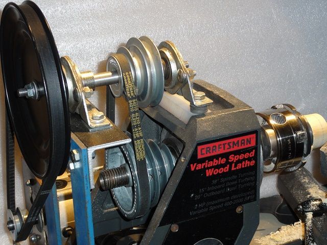

You could add a jack-shaft, and pullies below the lathe and get more speeds both higher, and lower.
I did that to this one.
Nice job Dan! :TwoThumbsUp:
With mine I'll be using 2 shafts and 10 pullies, below the lathe. If I did the math right my slowest speed should be 37.5 RPM.
One of the shafts will also drive an 11" drill press so I can get more speeds out of it also.
Have to wait for the outdoor shop to warm up a bit first though.
Thanks.  This was a VS lathe but had a planetary gear drive which was poorly designed and the spindle shaft wobbled in the rear bearing.  I retro fit the spindle from a Rockwell 46-111 wood lathe for it.  Took an old aluminum forklift wheel and turned it on the metal lathe to fit into the lathe and fit the spindle shaft to it.  Turned out the VS motor turned at high rpm and had to be cut back by the pulleys.  Works very well but was a lot of work.  I could have cut the motor speed with a different control but feared I would loose torque.
