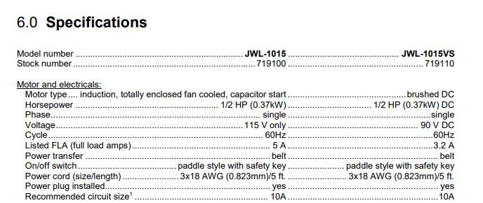

The label on my Jet mini motor shows  half horse  60 Hertz and below shows 162 vdc 3 amp. A contradiction of info. Is it a dc motor that gets is source from the speed controller?
Edited by Ron Altier
You're right Ron, the label is a contradiction. If it's a DC motor it should not have a 60 Hz. rating.
Thank Larry. I figured that is what it was. Do you have any ideas on lowering my speed?
Very strange they would list a DC motor as single phase 60 Hz.

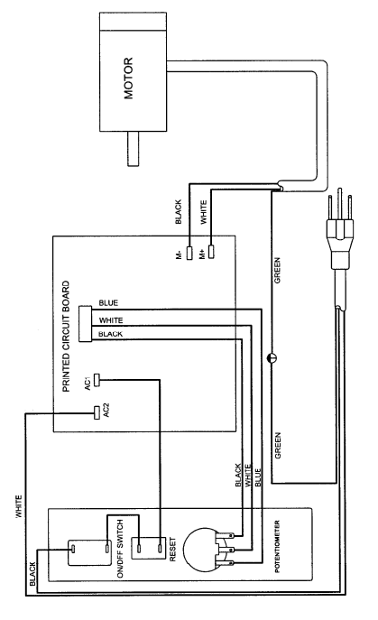

 I think maybe the single phase 60hz is in reference to the potentiometer. The AC to DC conversion is happening somewhere within the circuit board.
Without a complete schematic it is hard to determine if it would be possible to lower the voltages to the motor so speed could be reduced.
There has to be some sort of diode rectification to convert the AC to DC.
May or may not be possible to change the value of the potentiometer to lower the output voltage.

I did locate the model number 1014VS and tomorrow I'll search for the manual
It is already variable speed. Not much more you can do other than change pulleys.
