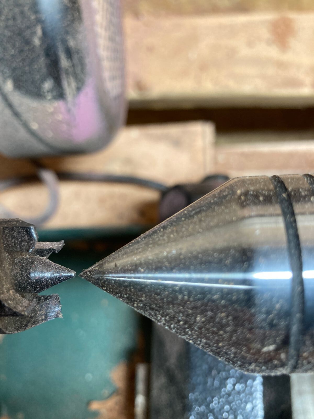

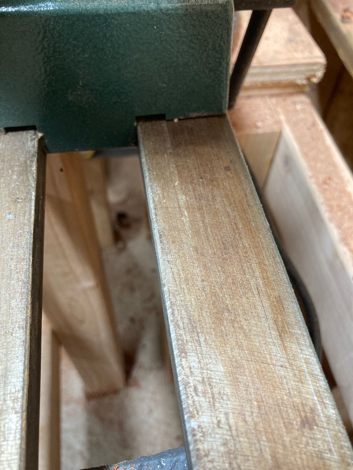

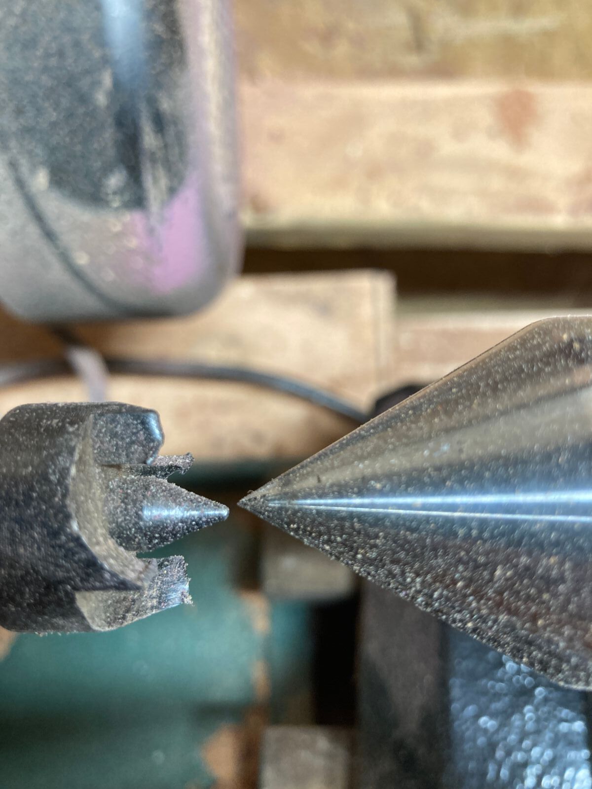

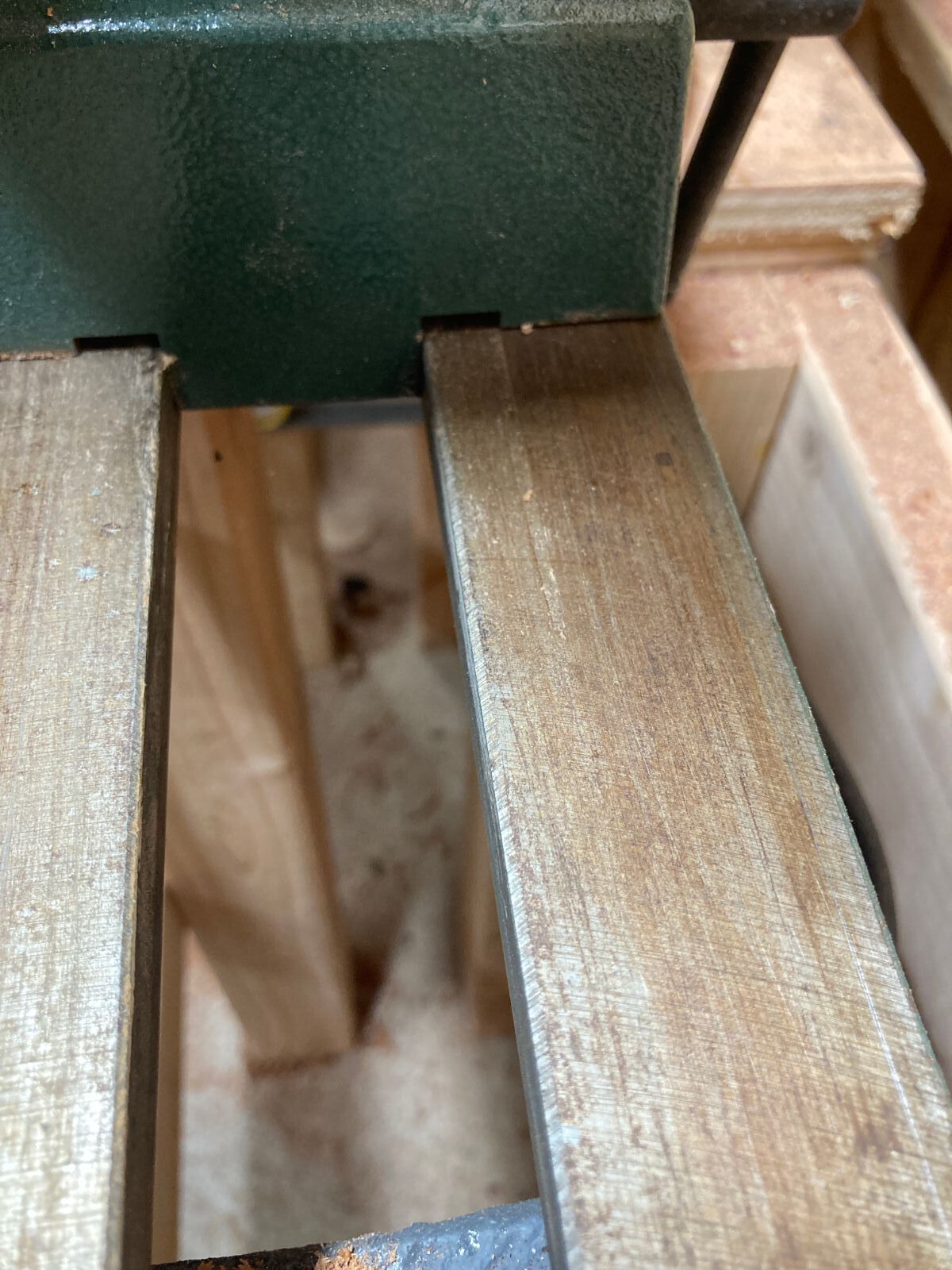

December 7, 20205 yr Author comment_250261 No the bed was clear just checked it..... Here are the screen shots. In order to center the spurs I did have to bring the tail stock towards me just barely in order to get it centered. So its not off by a ton but just enough to notice. Report
December 7, 20205 yr comment_250263 In your second, and third photos it looks like something is holding up the right side of the tail stock. I see a visible gap. Report
December 7, 20205 yr Author comment_250264 Yea I was holding it up to center the tail stock. Had no choice on that. Report
