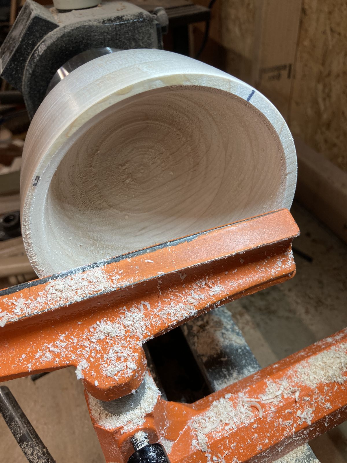

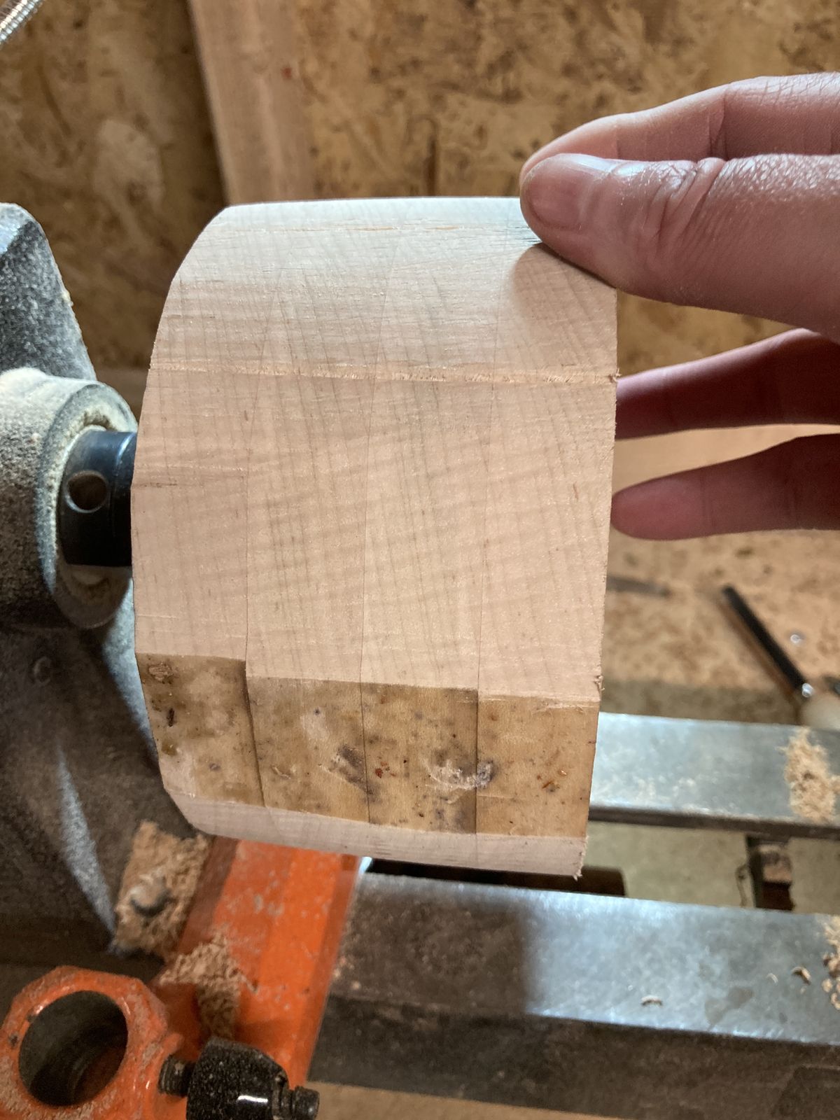

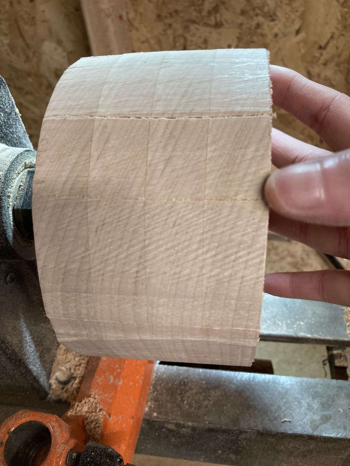

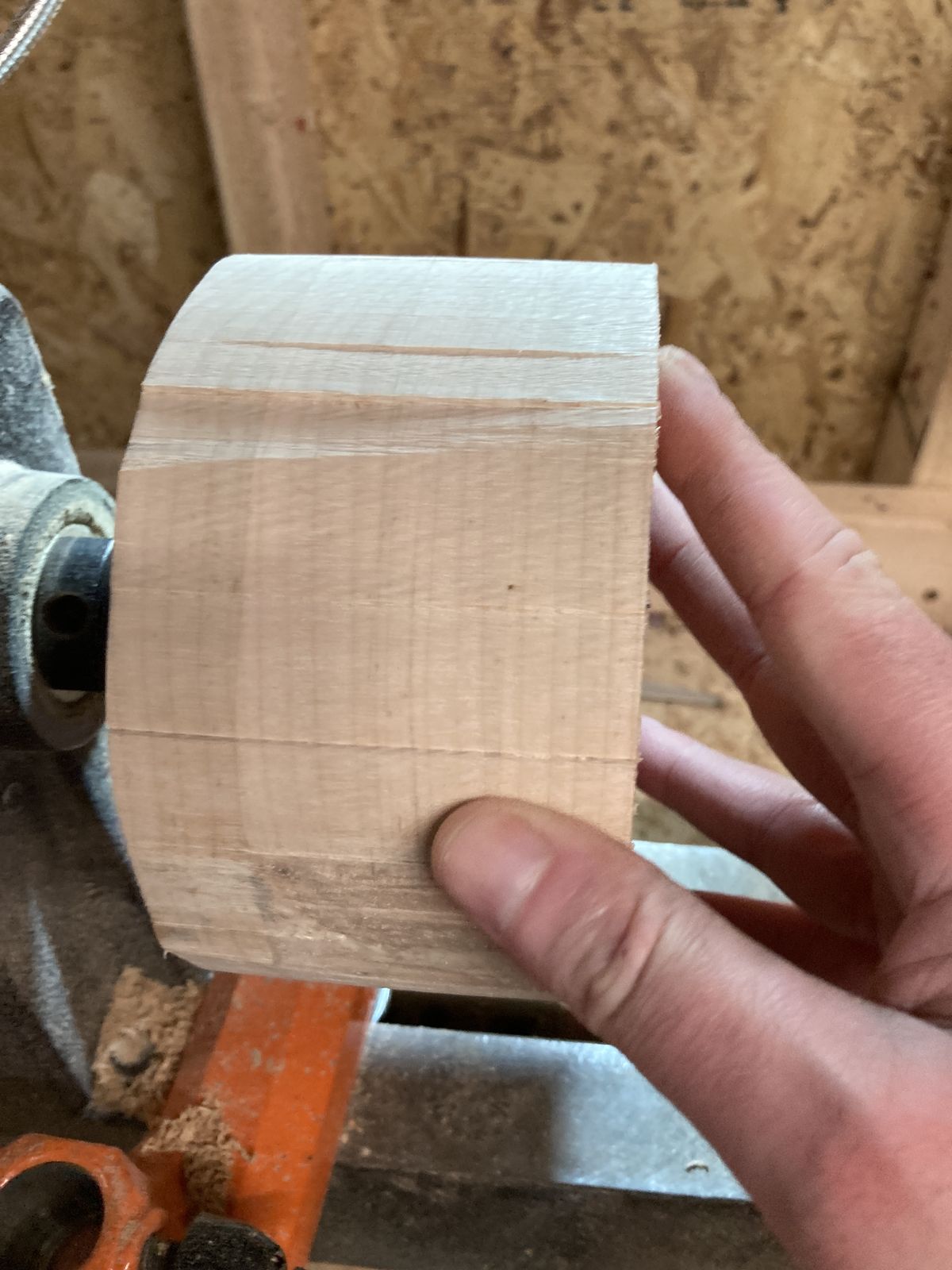

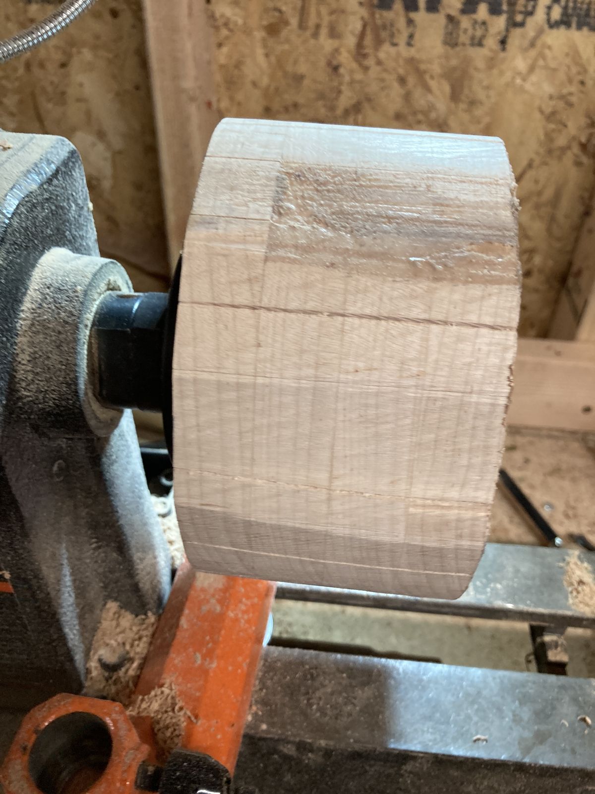

September 1, 20206 yr Popular Post comment_240936 Well either way, I'm starting a NEW project on a bowl.... This one will be my mothers birthday gift although it will be late I think she'll be happy with it when its finished up. I've never tried working with Birtch wood before so I wanted to try it. Fortunately home depot has plenty in stock. I bought a 12 foot section of board at 5 dollars a foot. That crap AINT cheap. I cut the board down to size. I took one of the bowls I had previously done. After the glue finished up drying. I went down drew out the lines. I'm still going to finish letting the glue cure up on the the lathe. Its dry yes but not fully cured. Either way. I got it drawn out with the bowl. Fortunately I marked center on the piece before I even started cutting out the round. My little Ryobi bench top bandsaw was having plenty of difficulty cutting through 3 inches of material. It pretty much struggled. I got it cut round as best as I could. I also had two new roughing tips coming from EWT which was nice, also placed an order for two new ewt negative rake roughing tips. Those should come in quite handy. Either way..,.. I'm hoping this one turns out nicely. I will be recording it so I'll post the video of it when its complete. AND HECK NO I'm NEVER USING A PEN MANDREL AGAIN for turning unless its for pens. Report

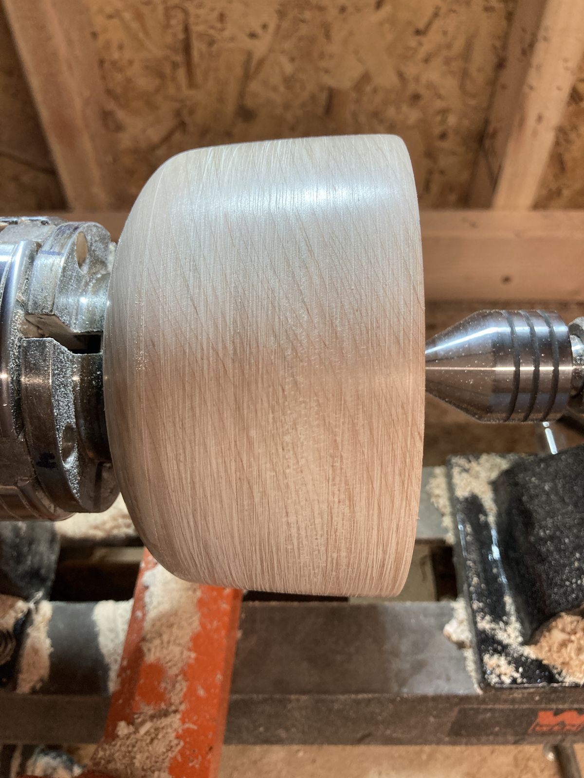

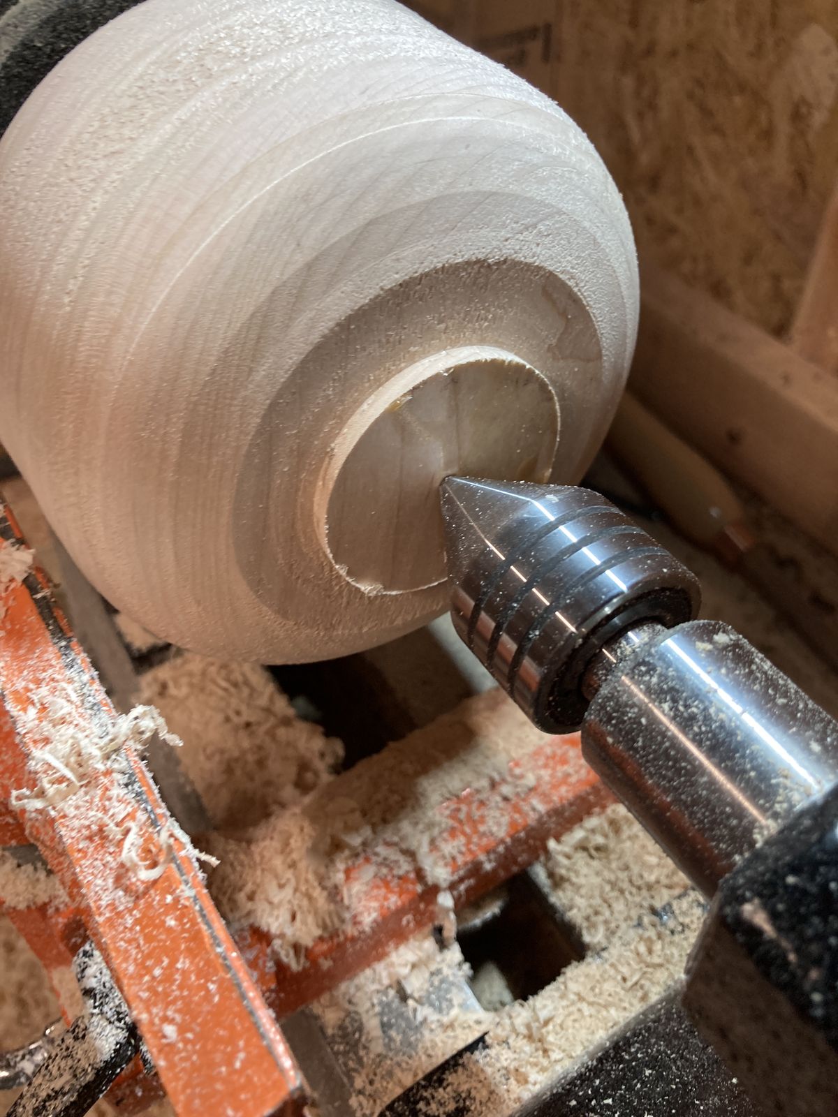

September 2, 20206 yr Author Popular Post comment_240942 Thanks @lew..... Turns out I am NOW a HUGE fan of birch wood. It has the feel of Poplar but its not as Olive Green colored. I'm going to try and get this bowl finished by thursday evening so I can just give the gift then and call it good. I would rather hand make a gift than buy one although thats tough with a niece and nephew. Either way this one is the experiment. Also just ran about 20 minutes of video on this one. But yea with the EWT carbides HOLY crapola the wood shavings just come off so nicely. Too bad I have to wait on my negative rakes to get here I could have used those tonight. Either way. Rounding the bowl first worked a heck of a lot better too. Going to do that from now on. Heres a couple shots of the work in progress. Makes me wish I had a decent power sander. Unfortunately out of sand paper for the disc sander. Report
September 2, 20206 yr comment_240944 Nice. Are you going to curve the sides more or leave them vertical? Report
September 2, 20206 yr Author comment_240946 I think I'm going to leave them a bit more vertical I'm not quite comfortable curving it out more. I'll try that on a cheaper type of wood. Birch was 5 bucks a foot so NOT cheap. Edited September 2, 20206 yr by AndrewB Report

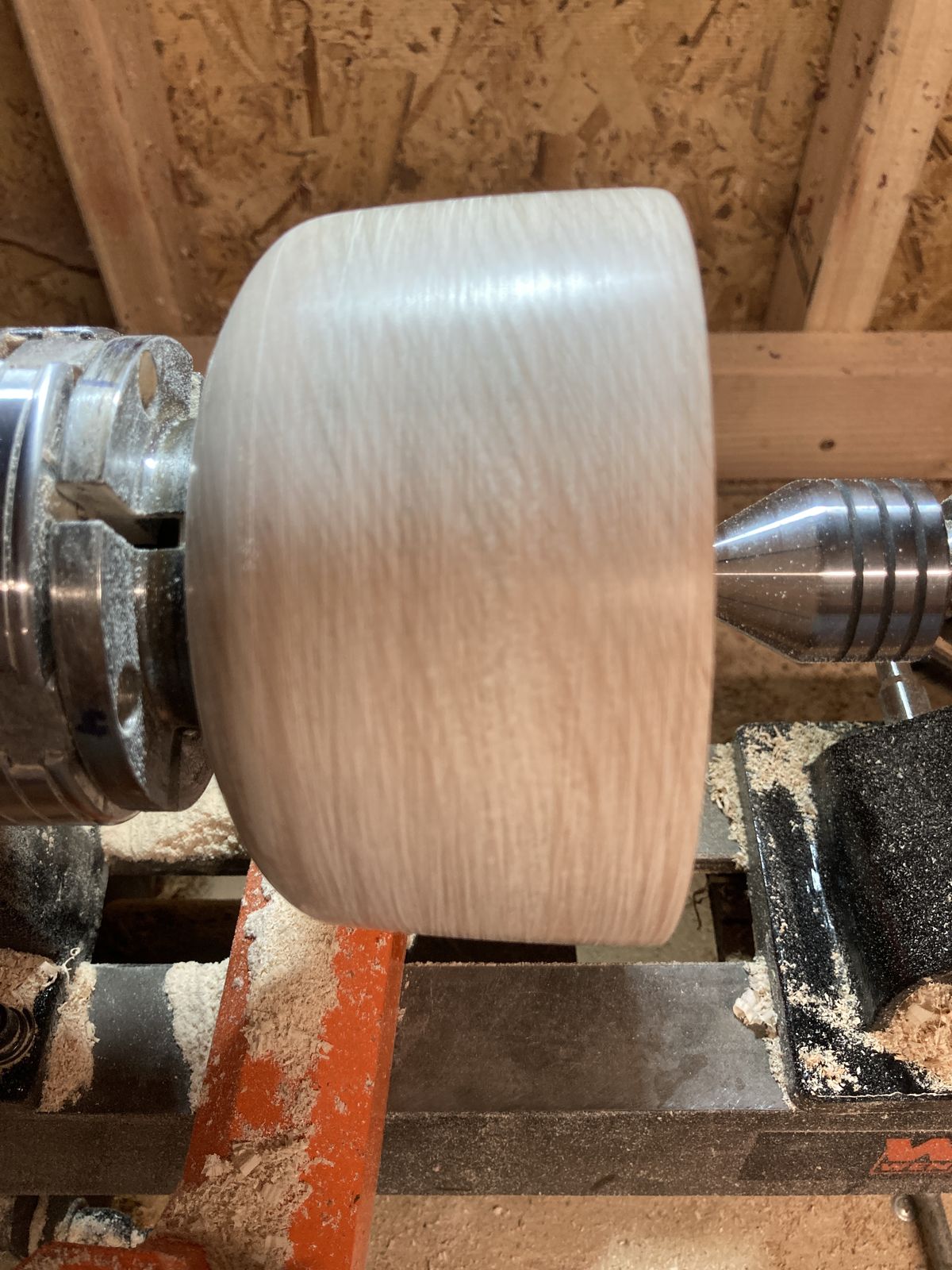

September 2, 20206 yr Author Popular Post comment_240948 Yea I really like birch wood sands nicely too. I only went up to 600 grit believe it or not. Its turning out quite nicely. This should make for a decent gift. Hopefully I'll be able to have it finished by tomorrow night. Maybe sooner. Report

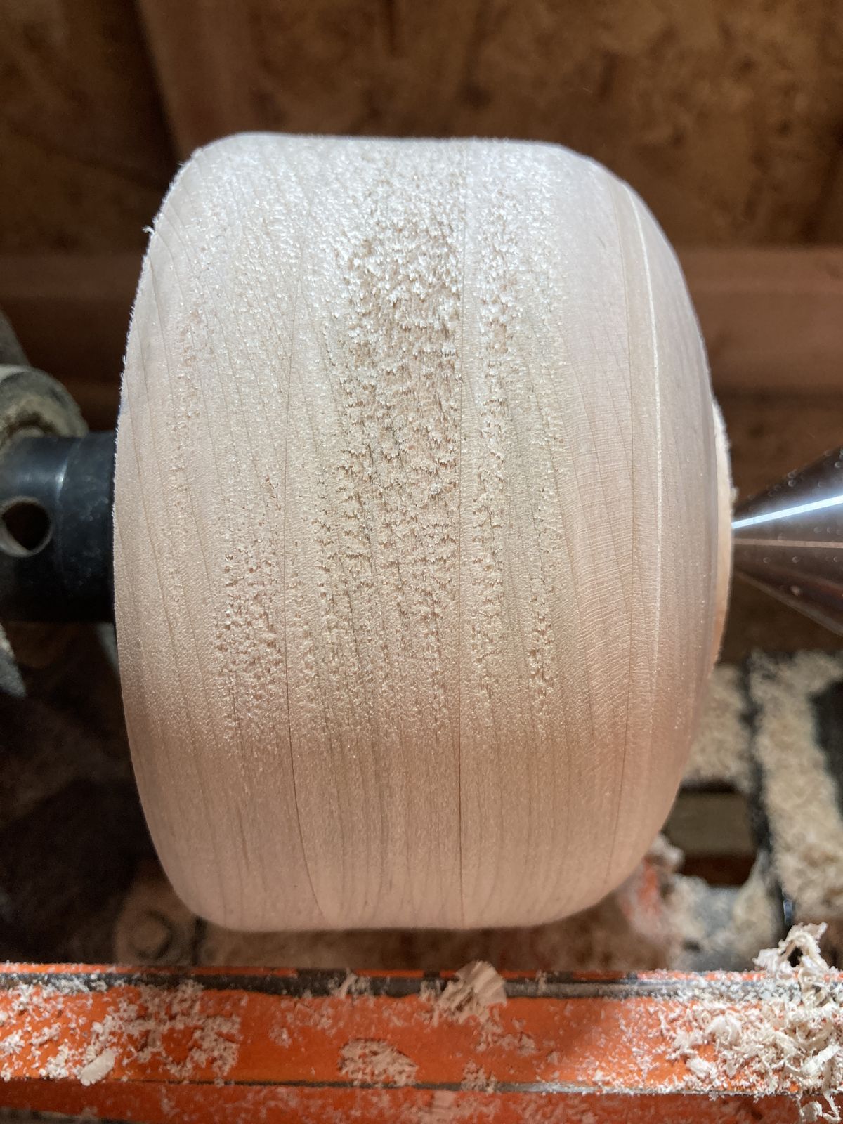

September 2, 20206 yr comment_240955 Looks pretty nice. Maybe it’s the lighting, there seems to be some scratches left. Report
September 2, 20206 yr Author Popular Post comment_240956 Some but that's okay its not too terrible. I only sanded up to 600 grit on the outside. I used a heavy duty 36 grit piece of sanding belt from my 2x72 to start the sanding to get all the tool scuffs off. It should still clean up quite nicely. I'm going to have to get a new carbide tip for my hollower its gotten a work out over a few bowls. Report
September 2, 20206 yr comment_240958 Going back over the turning using a light touch can often eliminate a lot of the turning marks. That way you can start with a higher grit paper. Don’t skip a grit! Report
September 2, 20206 yr Author comment_240959 I never do skip a grit. Fortunately I still have plenty of sand paper. I'm also stopping every 20 minutes or so to edit video LOL. Which in reality editing video is actually becoming much more fun than gaming LOL. Just a pain to record on a regular basis with the iphone. But at least the video of this bowl turning is coming out nicely. I should HOPEFULLY be able to keep this one under 30 minutes if I edit it right. Report
September 2, 20206 yr Popular Post comment_240966 Andrew you are definitely making progress. Glad you have started using harder woods as it is much more rewarding. Lots of tear out tho on this and after sanding I still see it. Ok lets say I don't pull my punches. I still think a sharp bowl gouge would give you a better surface on the outside. I know it is not fun getting all those catches when you are learning but you will learn and it will be rewarding. Keep challenging yourself but stay safe. Report
September 2, 20206 yr Author comment_240967 @GeraldYea the harder woods are turning out to be a lot more fun and challenging to work with. Softer woods tend to be TOO EASY. I do enjoy turning Myrtle wood still. How ever I've got to find a cheaper source of birch wood. I don't think I want to pay 5 dollars a foot for it again. As far as turning I've pretty much been sticking to my carbides. I've been enjoying them way too much. Not sure if I would have the patience to learn HSS at this point now that I've gotten used to carbide. It would also be nice to do larger projects how ever the small bowls is about all I can do with my lathe. Either way the smaller bowl projects are quite enjoyable and easy to finish off. Edited September 2, 20206 yr by AndrewB Report

September 3, 20206 yr comment_241118 On 9/1/2020 at 11:13 PM, Gerald said: I still think a sharp bowl gouge would give you a better surface on the outside. And he would save money on sandpaper. The smoother the cut the less sanding needed and used correctly, a bowl gouge can leave a very smooth surface. Edited September 3, 20206 yr by HandyDan Report
