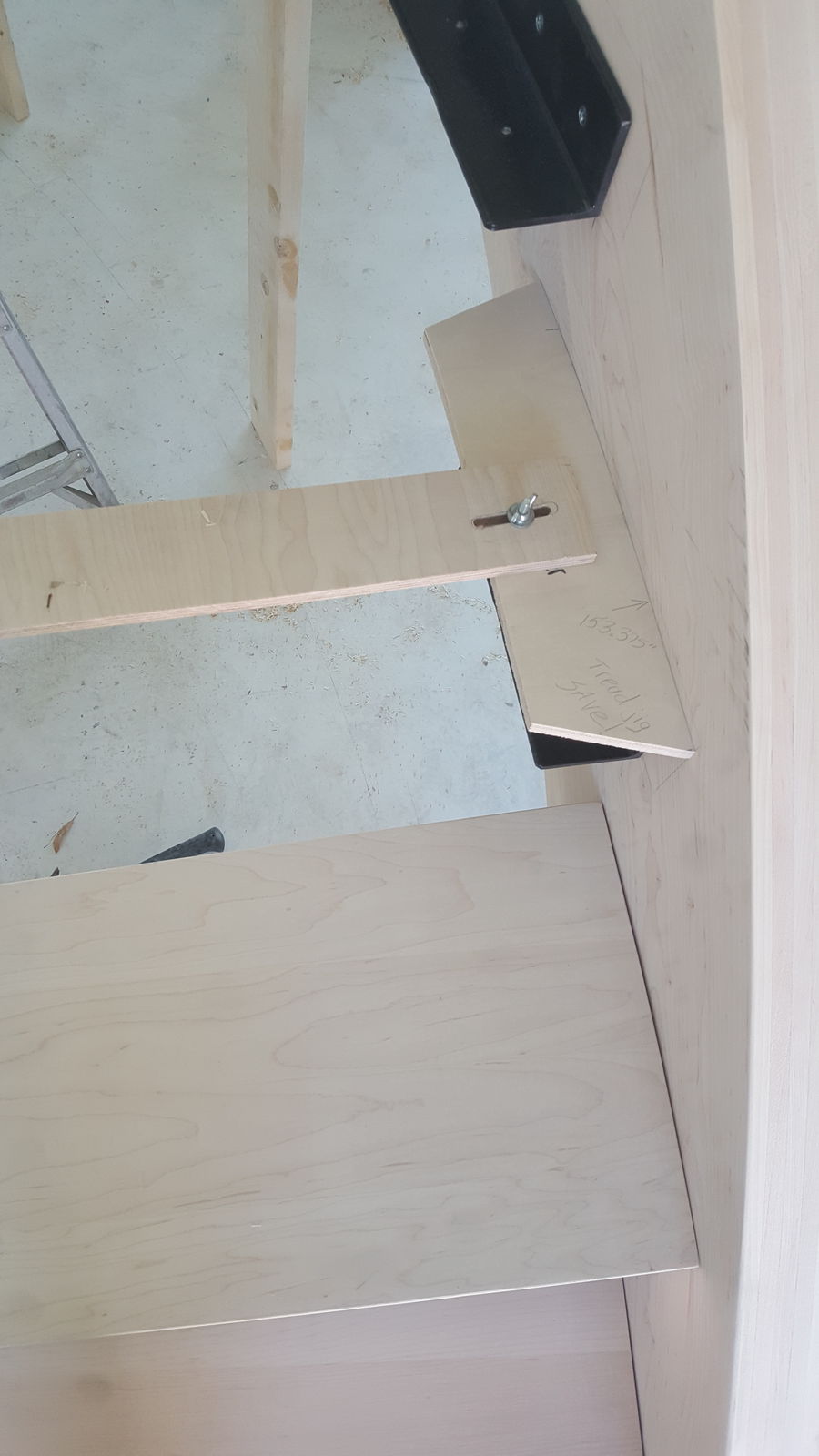

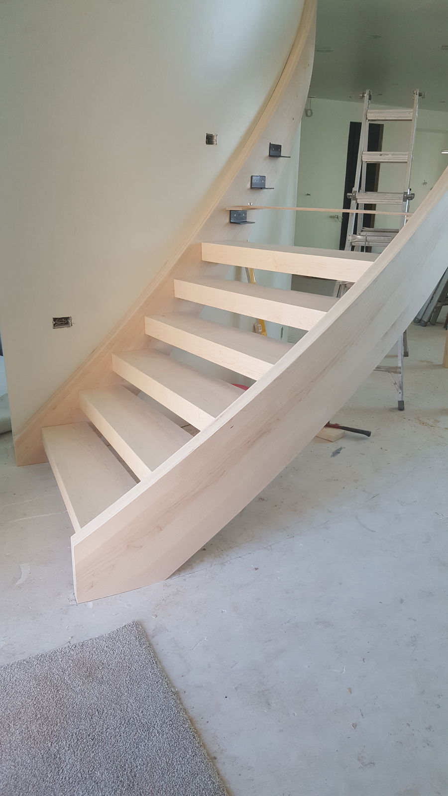

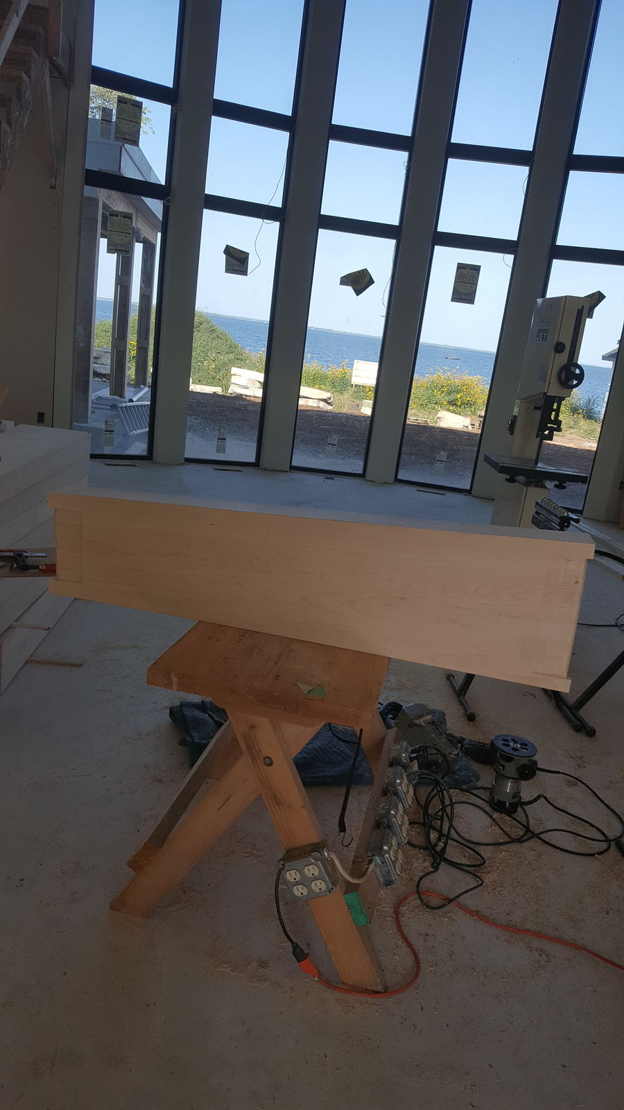

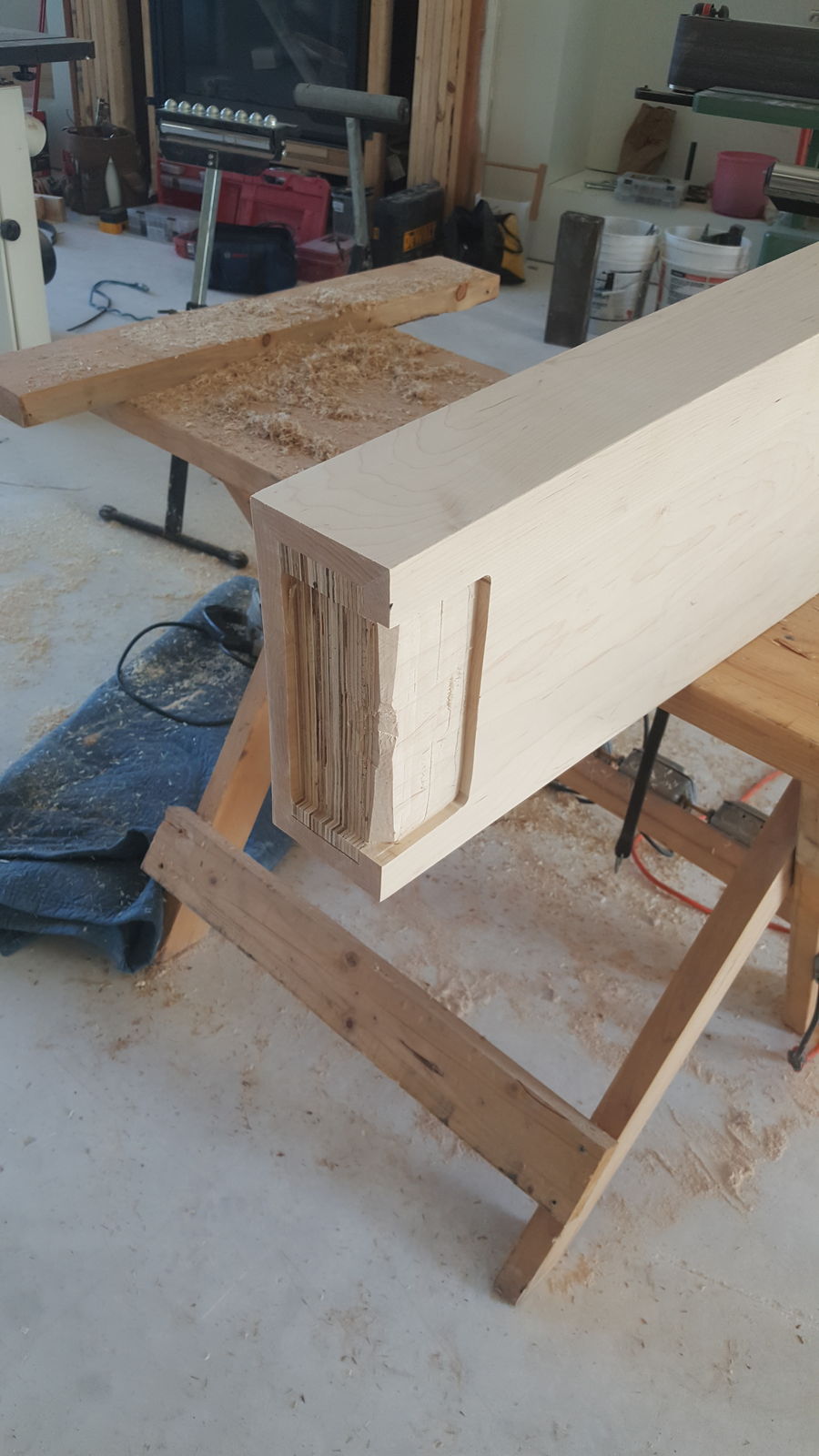

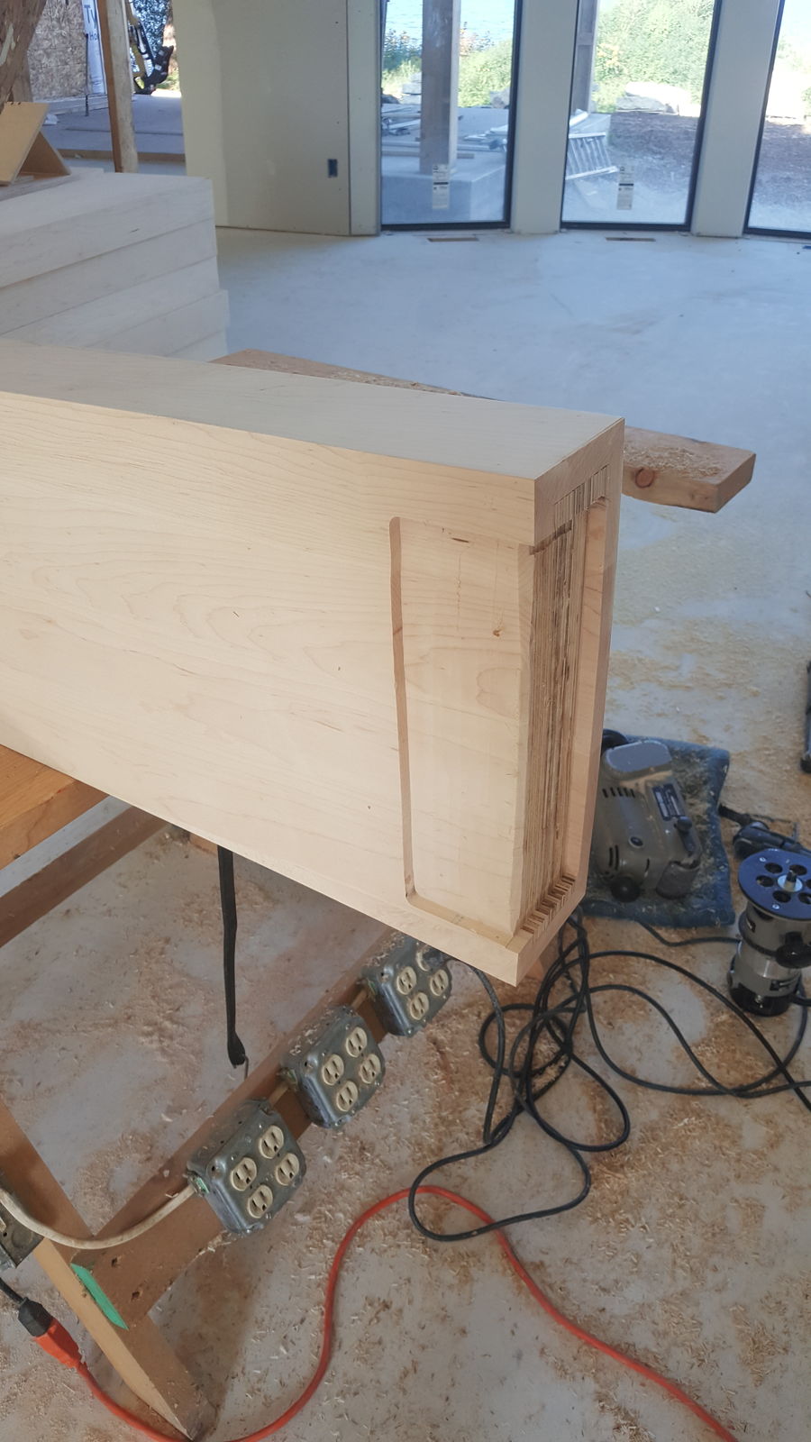

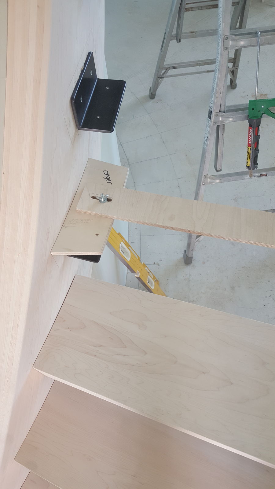

    Cleaning up the edges of the stringer, it turning out very nice, got 3 layers of the other stringer bent yesterday, will be putting the other 3 layers on this afternoon.
Both stringers were laid to proper run and rise before being bent, a lot easier laying them out when flat. Angle iron is then screwed to the stringers, using a jig I made in the shop, we then make a template of the tread, lay jig on the tread, and cut the treads to length using a band saw. We made the treads 2" longer than needed, giving us an inch to cut off each end
Using another shop made jig, the bottom, and end the tread is routed out so the angle iron is concealed, there is a curved plate that will go on the underside of the tread. And edge sander is used to sand out the saw marks on the wide side, and a belt sander to sand the narrow side. Me and the boss worked 8 hours on Friday and only got 6 treads put in, very time consuming work
