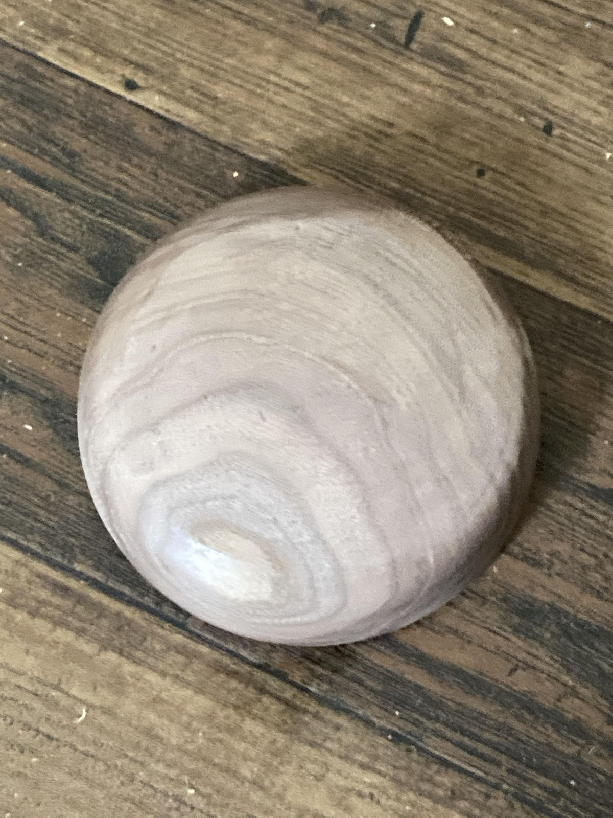

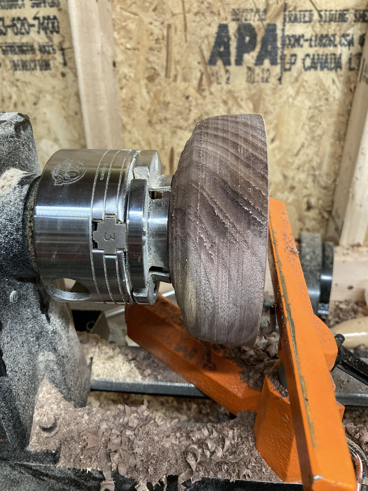

July 5, 20206 yr comment_234374 Okay folks got some issues here. The 2 inch by 5 inch piece that I got from Rockler the other day. I sanded off the wax seal off the wood yesterday. Today I started turning it. Nothing has cracked so far. Handled really well on the spin up. I went with the face plate method on this one. How ever this is my issue. I've got a good shape that I actually really like for this small bowl. Its simplistic which is what i like. Not too complex either. How ever if I cut a mortise or tennon in the bottom, that would not leave me with very much wiggle room sort to say on hollowing this thing out. I don't want this to be a wasted project, I would like to actually accomplish this one. I must say the walnut turned EXTREMELY nicely. The easy wood chisels made quick work of the square block and turned it into shape with the rougher alone. How ever what I am looking for is input and or suggestions on how I should complete this so I am able to hollow this out and call it a bowl. Not sure where to go on this one. Report
July 5, 20206 yr comment_234375 Mortice or tenon is sorta like pins or tails first. It's often a matter of preference. I know that @Gerald usually prefers tenons. I often go with mortices. You'll learn to read the wood, with experience, to see which one would provide the best hold. Also, either one can be incorporated into the way you finish off the bottom of the bowl. A couple of good article on helping you see the difference. https://turnawoodbowl.com/wood-bowl-mortise-or-tenon-which-is-best/ check out the links at the end of this article for more information https://turnawoodbowl.com/bowl-tenon-secure-wood-bowl-foot/ Whichever route you decide, constantly check the hollowed depth to avoid ending up with a funnel instead of a bowl- don't ask how I know about this. Report
July 5, 20206 yr Author comment_234376 Okay if I go that route I may have to change up the shape of the bowl. I'll head out to the shed and see have a look. I've only got so much material to work with so if I mess it up lol. It would be a waste. I did have a look at both of those links. Edited July 5, 20206 yr by AndrewB Report
July 5, 20206 yr comment_234377 I don't think you really need to change the bowl shape that much. More so if you use the tenon method but still not too much. Check your chuck jaws to see how long of a tenon you'll need- maybe only 1/4" to 3/8" long (same for the mortise depth- if you choose that method). Report

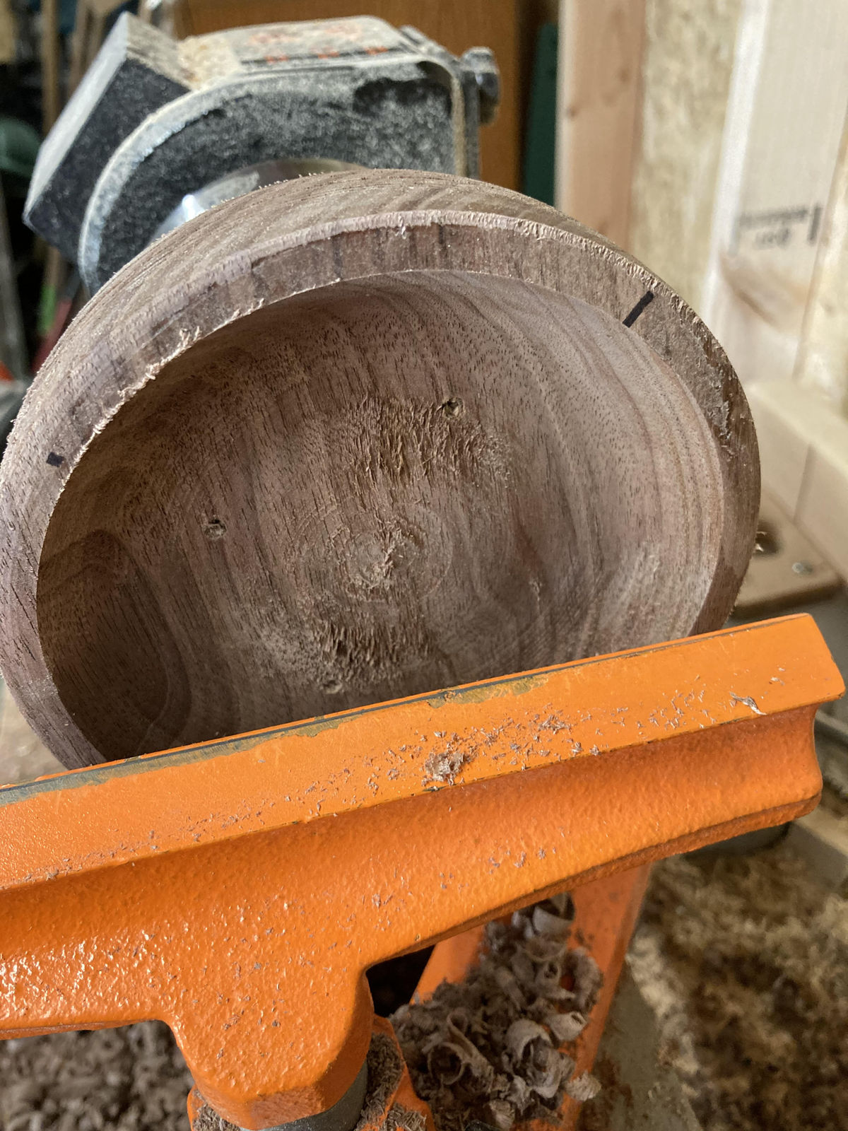

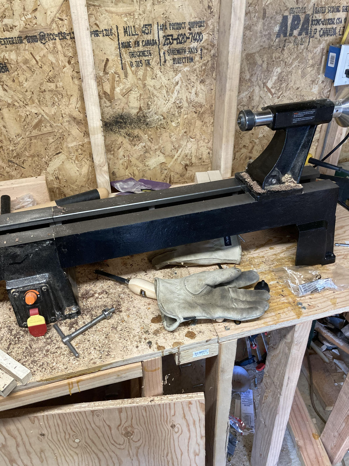

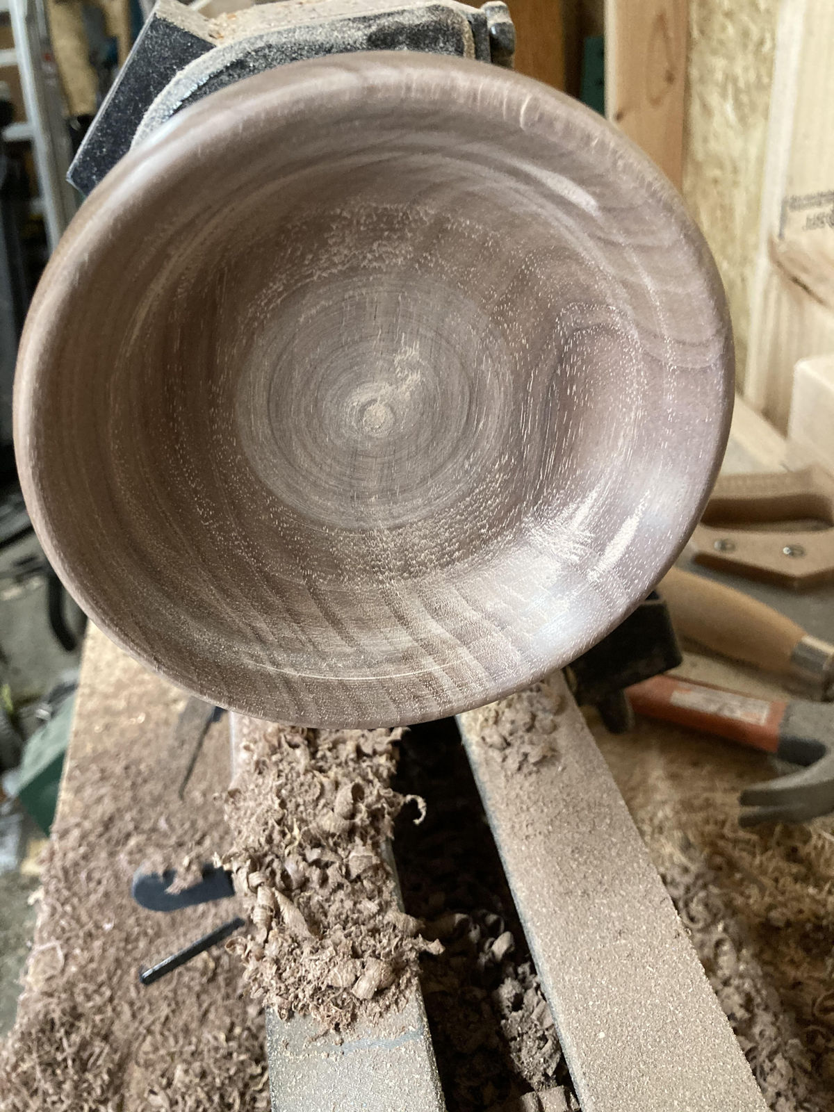

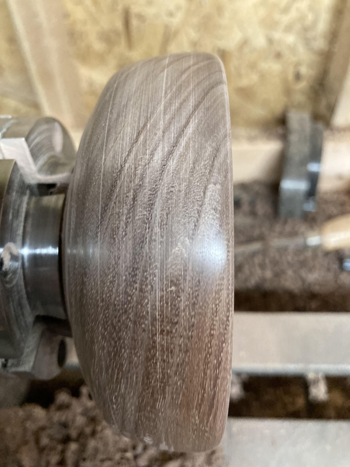

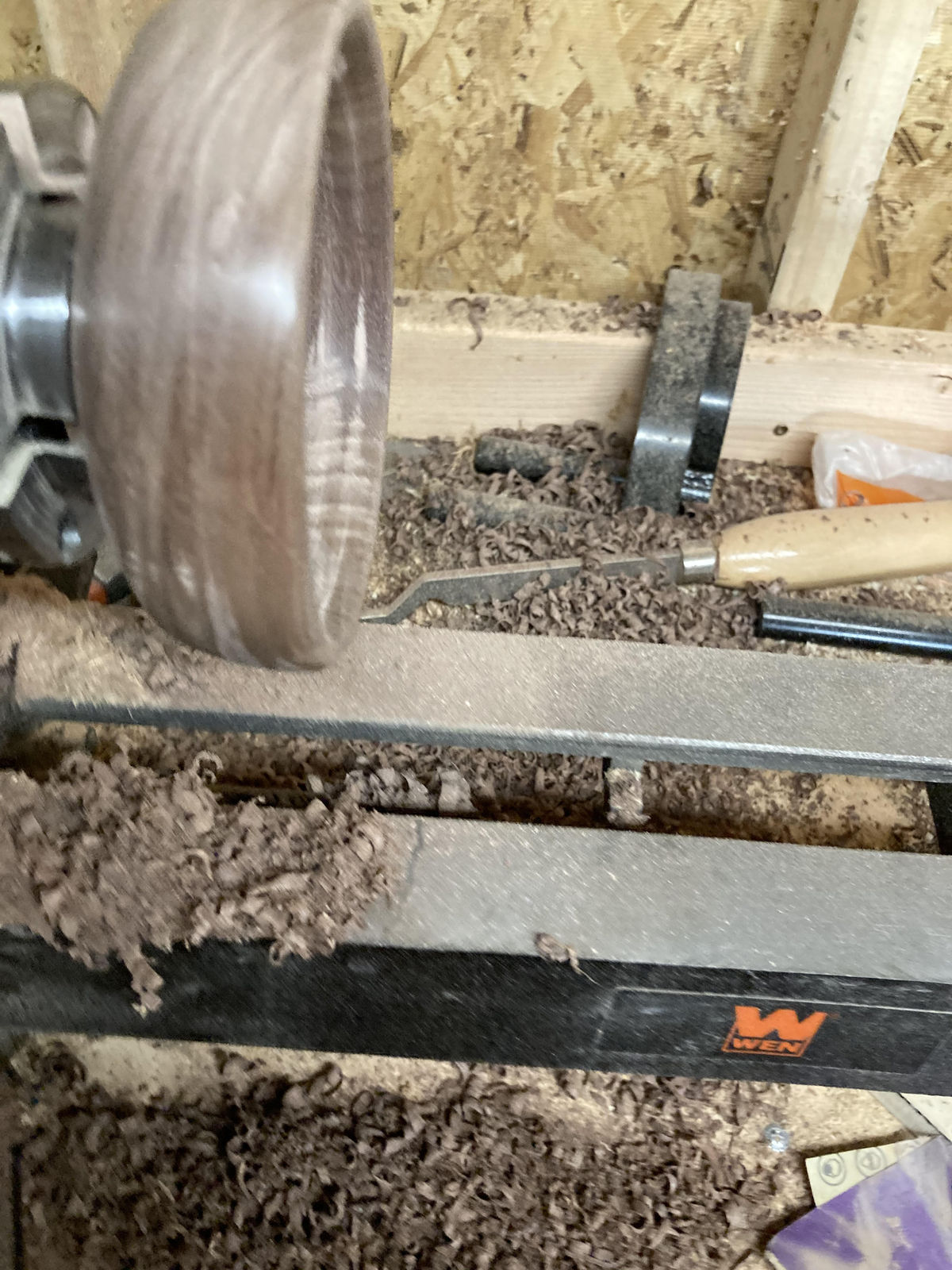

July 5, 20206 yr Author comment_234380 Okay so I went with the tennon. I wound up cutting a smaller tennon. Did some turning on it. No bowl flying out seems to be working okay. So I'll have to figure out how to smooth that out once I'm finished with the hollowing. The lathe extension having nothing to do with the bowl well yes and no, but having added that extension on I was able to get the tail stock up and out of the way so I was able to get into access the piece a lot easier. I'm sure this one will turn out okay at least I hope so. Yep I still have to put paste wax on the extension. Edited July 5, 20206 yr by AndrewB Report
July 5, 20206 yr comment_234382 That looks pretty nice. I think I'd try and refine the outside shape a little before finishing the hollowing. Just smooth it up a little- light touch keeping the tool rest fairly close to the work piece. Then go back and finish the hollowing. Report

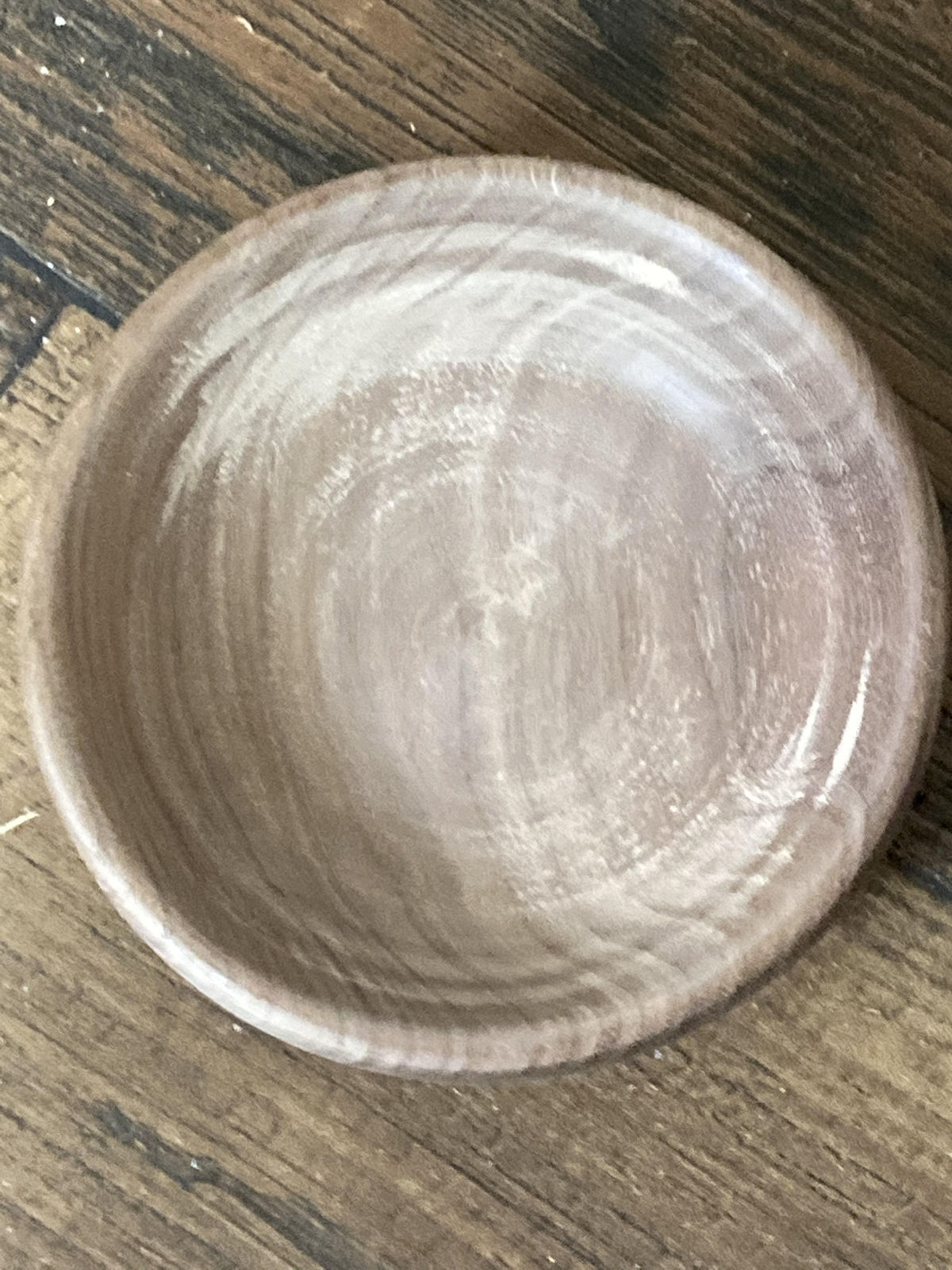

July 5, 20206 yr Author comment_234383 Already beat you to it @lew I've just gotta get some food safe varnish for it. So I'll have to go to home depot tomorrow morning. Its not quite finished. How ever This bowl blank I did receive from Rockler as I said no cracks no issues, so I guess I got lucky with this one. I'm happy with this one though. It turned out alright. You were right the small piece did turn into a nice little project. I was kind of unsure about it because of the amount of material but it worked out. You guys were right. SO SO SO SO much easier carving on a solid chunk of wood. I think I'm going to stick to that instead of trying to laminate. Edited July 5, 20206 yr by AndrewB Report
July 5, 20206 yr comment_234385 Not bad at all! All that practice on the laminated pieces really helped you get the techniques down. I really like turning small objects. Less waste and a lot of fun as they get done faster. As you get more experience, you’ll be able to work out those scratches with the tools. That will make sanding more efficient. Looking forward to seeing it with the finish on Report

July 5, 20206 yr Author comment_234394 A bit more sanding but not having a big jaw chuck which is on order. Minus a bit more sanding on the bottom and a good coat of varnish. I think this bowl is COMPLETE. The belt sander made quick work of the tennon. Report

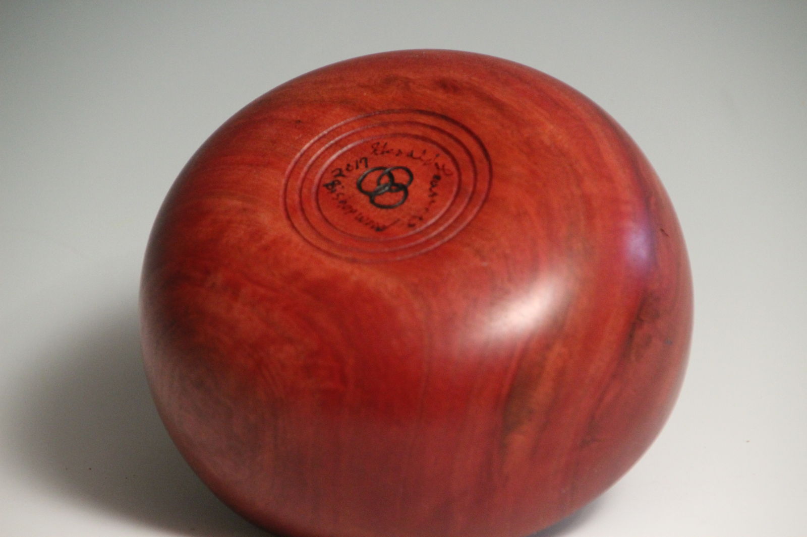

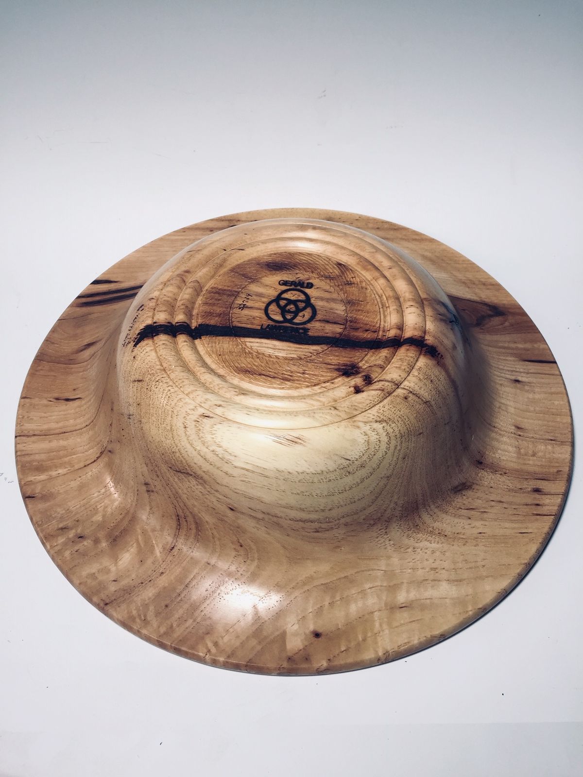

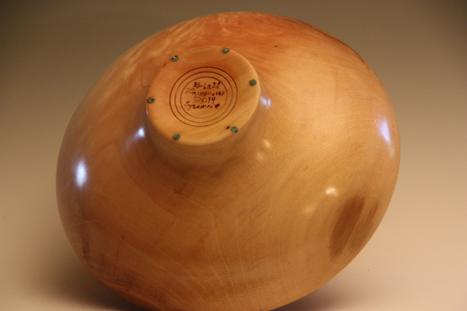

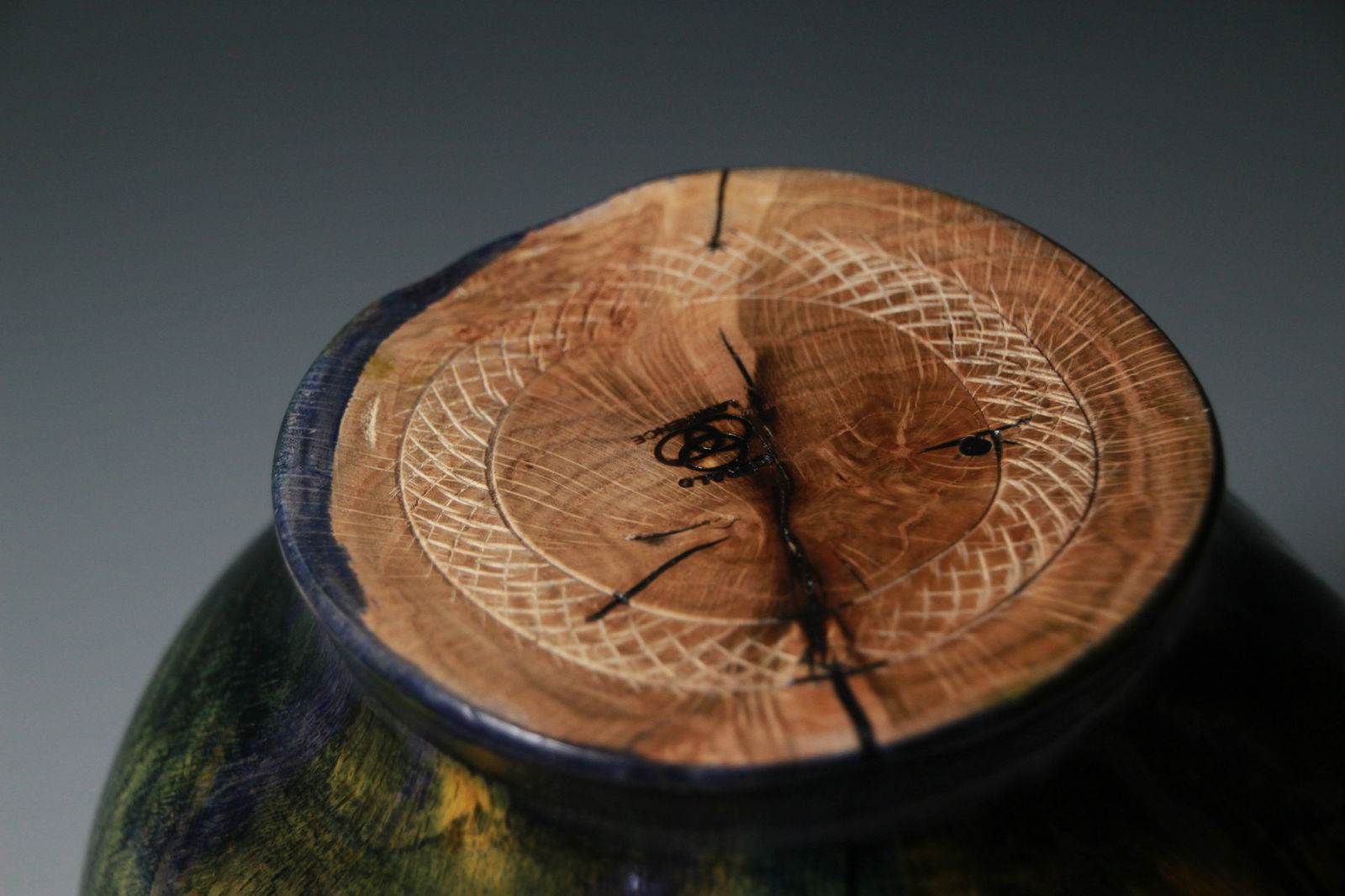

July 5, 20206 yr Popular Post comment_234397 By using a sander on your bottom you remove the opportunity to embellish the bottom of your piece. There are many things you can do to both improve the foot of your bowl as well as decorate it. What do you think the first thing someone does when they pick up your bowl? ...............They look at the bottom. Report
July 5, 20206 yr Author comment_234398 Very true but at this point I don't think I've made anything yet that's worthy of being sold or someone would buy it. More practice is needed first. Report

July 6, 20206 yr comment_234443 A great looking little bowl Andrew. Regarding Gerald's comments, signing off on the bottom (or whatever you might choose to do) also takes some practice Report
