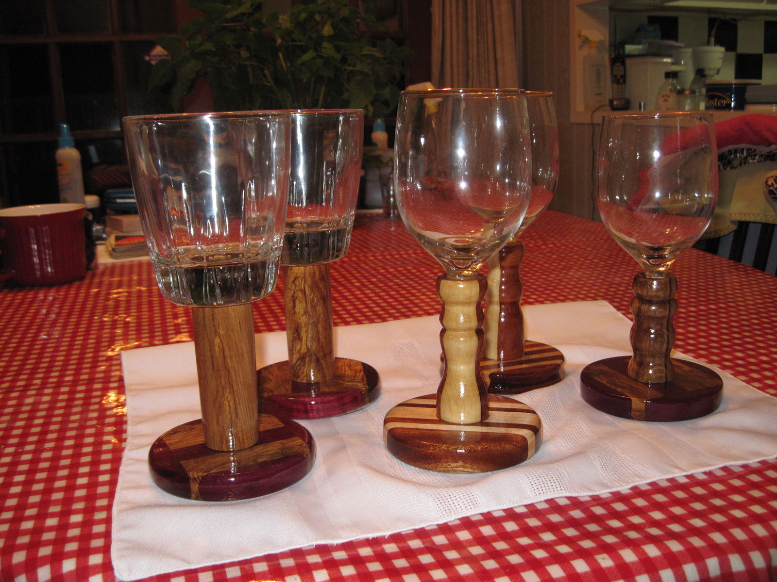

You can mix the two.  Below I have made a square blank just like you have, then glued a long grained blank to it.  Then turned it down.

That's not exactly the wrong way.  If you want a bowl that looks like this one, it would then be the way to do it.
