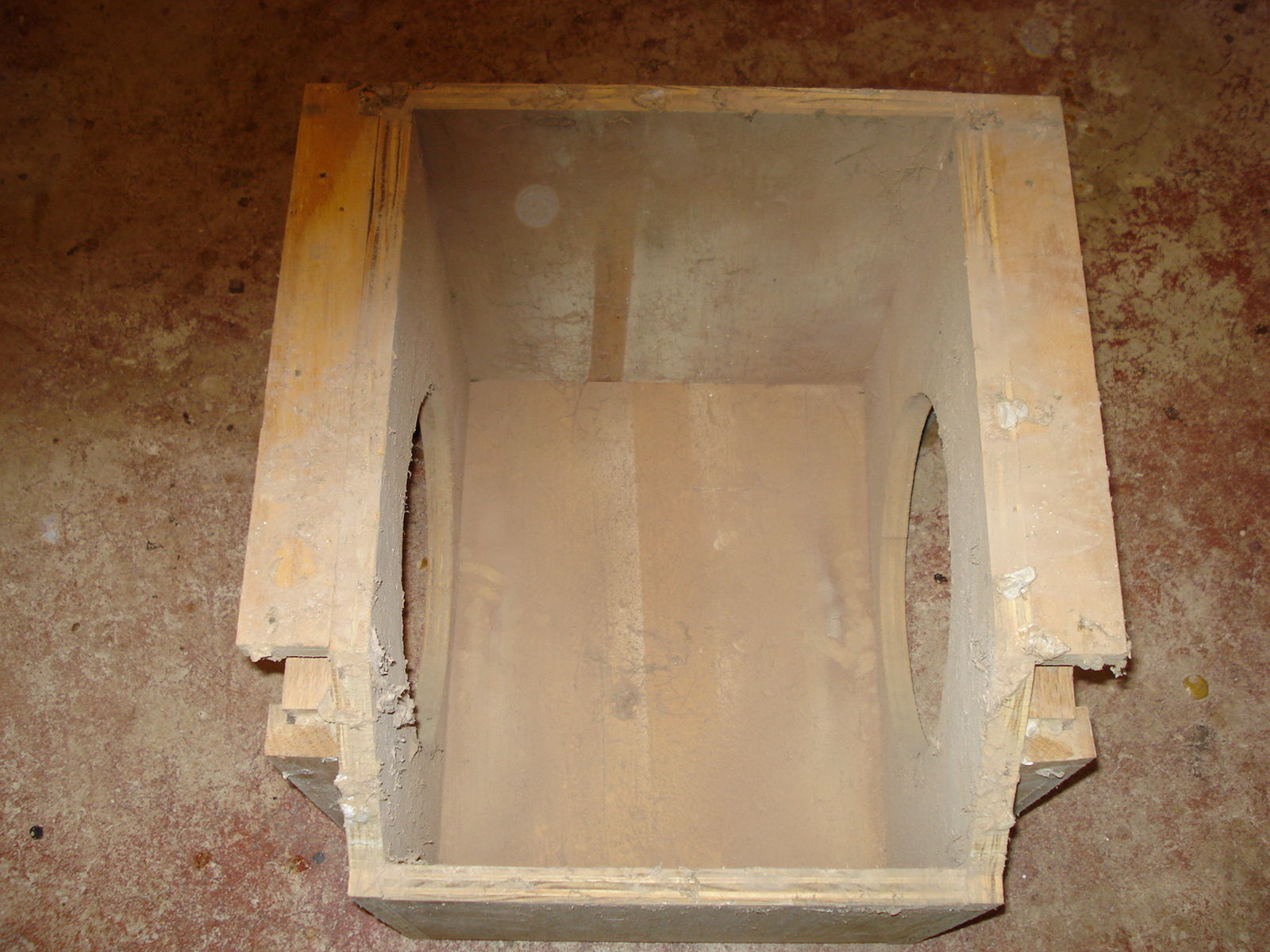

May 19, 20206 yr Popular Post comment_229442 If you haven't started the build yet, you could probably get a direct drive squirrel cage furnace blower for a couple of bucks. HVAC guys replace furnaces all the time and just junk to old ones. It would make a more compact unit and probably be variable speed. Here's the first one I built. It was later replaced with a slightly smaller one- I took out the tilt out basement window Then made a plywood housing. The frame around the hole supports the filter. If you do something like this, go to the Borg and measure some of the inexpensive furnace filters to get the correct dimensions (don't ask how I know this). The carcass. Air inlet holes on both sides The carcass was fastened to a piece of plywood that fit into the basement window opening. The Blue stuff is what I'm using for a filter. What you can't see is the .25" x .25" wire mesh covering the holes. It keeps the blue stuff from being sucked into the blower. The screen isn't necessary if you use premade furnace filters. The first blower simply exhausted the air to the outside through a hole. One day I powered it up. It didn't spin. I thought it was the starter cap gone bad. When I opened it up, I found a bunny rabbit had crawled through the opening. got wedged and died. So, I added- The cover is pushed open by the force of the air and its weight closes it when the fan turns off. The 4 bolts are what holds the blower the the plywood window filler. The carcass fits over the blower unit and is attached to the plywood window filler with screws. Edited May 19, 20206 yr by lew Report
