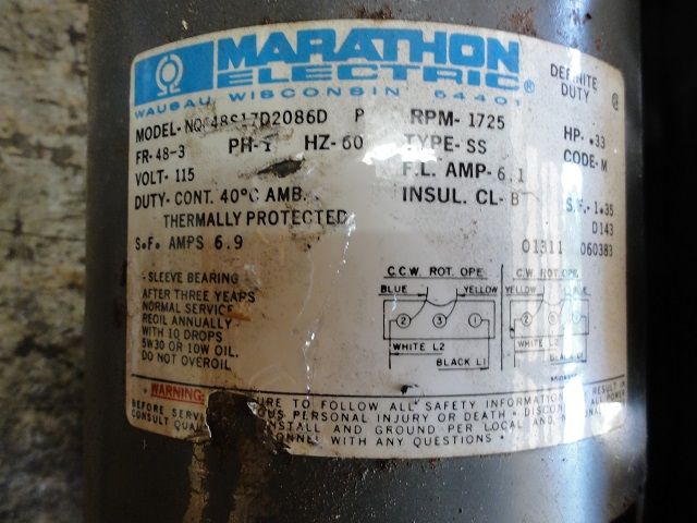

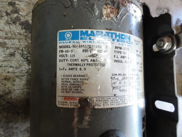

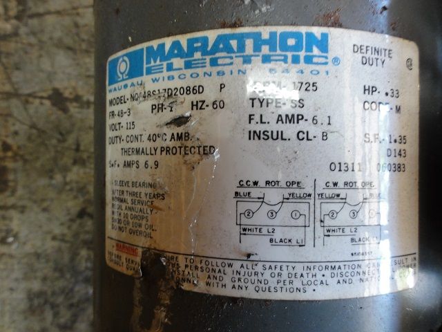

May 26, 20206 yr Author comment_230140 On 5/21/2020 at 12:50 PM, Larry Buskirk said: @HandyDan Is there a tag on the motor? Finally conquered my camera problem. Still have to jump through hoops to get the pictures here but it is better than the Sony cure. Hope it works for awhile and they don't screw it up all together. Their new program may be nice but I would need classes on how to use it. If anyone wants to know how I'm doing it I can explain further. Here is the tag. Report
May 26, 20206 yr comment_230150 @HandyDan, Dan, Do yourself a favor, and get a card reader. If your Sony's doing like my Kodak did. I could only access one photo at a time from the camera, and then have to unplug and then plug it in again. As to your motor, it is a split phase motor. If you used a drum switch with it you could do FWD/REV with the switch. Report
May 26, 20206 yr Author comment_230154 25 minutes ago, Larry Buskirk said: As to your motor, it is a split phase motor. If you used a drum switch with it you could do FWD/REV with the switch I have done this with other motors. Can I use the Dayton speed control on it. Report
May 26, 20206 yr comment_230157 1 hour ago, HandyDan said: Can I use the Dayton speed control on it. Dan, Speed controls are not recommended with a split phase motor due to the centrifugal switch. These motors have to develop a speed that will disengage the switch, running them slower will keep the start circuit engaged resulting in probable burn out of the start circuit windings. If you want FWD/REV and electronic speed control your best bet would be a capacitor start motor. They get reversed basically the same way as a split phase motor. If you don't need/want FWD/REV you could also use a repulsion induction motor. Reversing these motors requires moving the brush assembly in relation to the armature. Report
