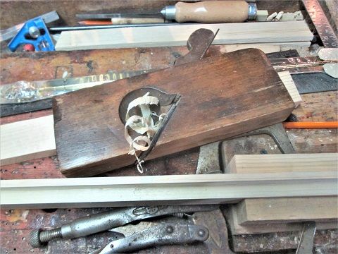

Ok...back to work.:BangingHead:..Left hand door has had it's rebate cleaned up...as well as the matching one on the right hand door..B)
Auburn Tool Co. of Auburn NY, No. 181 skewed rebate plane...and, if you ain't careful, it will peel a strip off your finger, as well...and you won't feel a thing..:BugEyeSmiley:

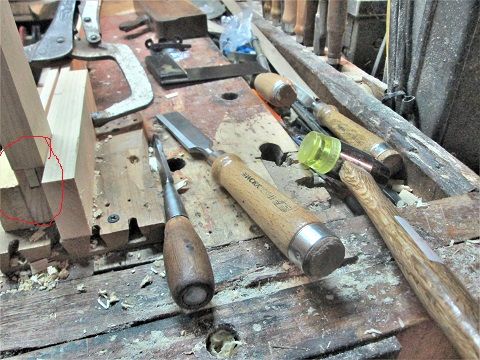

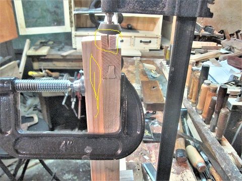

Ok...mortises for door #2...B)
Were a little different than the others...tenon comes all the way out the end.  :ChinScratch: Had to trim about a 1/4" or so off the end of the plexiglass panel...then a dry fit..:TwoThumbsUp:

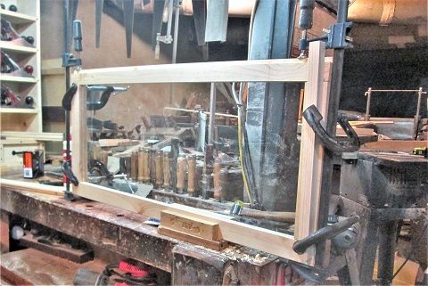

Then add the glue, plexiglass, clamps and cauls...:TwoThumbsUp:
Cauls to keep things flat at the corners...had to double up at one spot...:OldManSmiley:

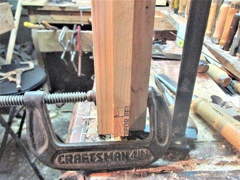

Checked things for square, too..:ChinScratch:
1362473124_PlaneTilDoorscheckforsquarecorner.JPG.90ec17f2e47fa93e6d1b07854a8edbb5.JPG

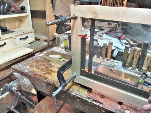

Close enough....was having issues with the clamps on that thinner edge...so...B)
Used  "helper" to get things wide enough for the clamp to stay put.  Also puts pressure straight down into the glue joint...:MachineGun:

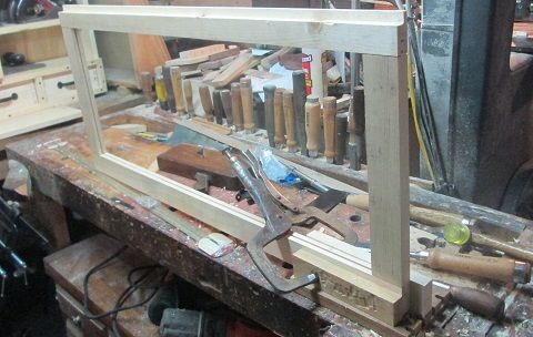

Tools in use today, besides that finger slicer...not a bad morning?:TwoThumbsUp:
letting the door sit a bit, will get it out of the clamps tomorrow, I think....may go out and pick up a can of stain...getting a bit low..:WonderScratch:

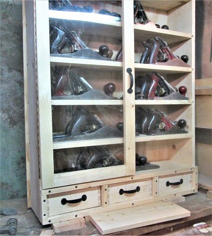

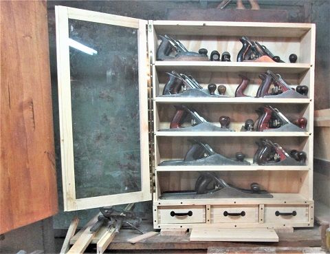

Methinks tis time to wrap this up....:cowboy:  Fought all afternoon, getting two doors to fit just right..:ArguingSmileys:..went out and picked up a small can of stain to add to the brew, and a stick of trim...:ChinScratch:
So..here we go....:Praise:
Handles and a latch on the outside...NOT a dirty window, that's me in the reflection..:CoveringEyes:.and a bit of the bench's tool well...un-do the latch, swing the left door open..
Molding keeps the door from swinging too far.:rolleyes:..and..
1451269490_PlaneTilprojectpostbothdoorsopened.JPG.320cb1f0fcb8099deb67b0983838f0f6.JPG
When you open the right hand door, there is a magnetic catch...have to prop the door open,,,wants to swing almost closed...:ph34r:
Witch's Brew has been wiped down...waiting on it to dry....I think it is done...:SaluteandRun:
Not sure what the next Project will be...yet...stay tuned :cowboy:

On 4/11/2020 at 9:34 PM, steven newman said:
and the famous Lew's Mallet
Sorry, some how I missed this entire project until I saw the images in the gallery:(
That is an awesome display/storage cabinet, Steve. A well deserved resting place for those fine planes!
Just flat bada$$,.........not to mention useful....but it looks awesome simply sitting there holding all of them planes :TwoThumbsUp:

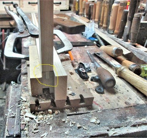

Set out a few tools for use...marked out the tails for one corner joint ( tails first, this time only, NOT a fan:ArguingSmileys:)
then the bandsaw made a bunch of cuts..
Makes it easier to get the waste out.  Chisels to chop out...:SaluteandRun:
That chisel had been ground into a triangle shape, to get into tight corners...B)
Tails done. :Praise:  Use these to lay out the pins...:ChinScratch:
knife wall at the "baseline" was done with the marking gauge..more handsaw stuff...:WonderScratch:
I did try the "broomhandled saw" :BugEyeSmiley:  Way too many teeth for a rip cut. :ArguingSmileys:  I only need 8 full length strokes with the No.4....was trying to leave the lines..on the theory I could always trim back to the lines...:rolleyes:
So..chop 1/2 way down, leave a chunk on the edge for support...flip over..:ChinScratch:
Pins done...dry fit?   First 2 tries...meh, had to trim a couple spots...finally..:Tapping:
Not the best...at least I can hide this mess...:DevilLaughing:
