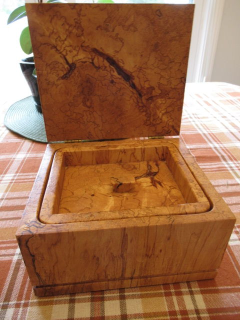

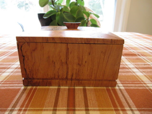

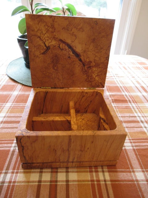

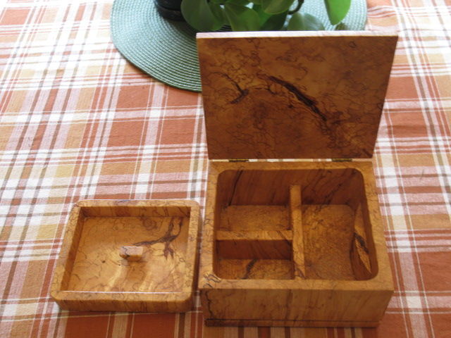

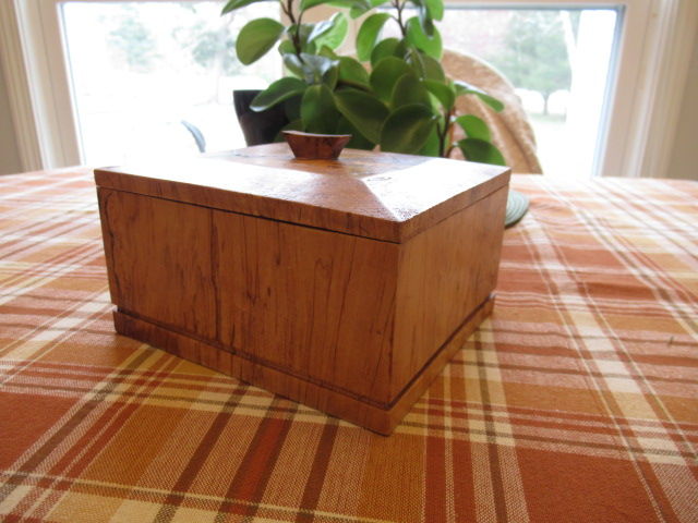

  • OK, here is the spalted maple box. This was my first attempt at making a box, other than a bandsaw box. The wood is from a tree that was downed on my property. Hope you like it. The photo with the ros
  • OK ! My first images were not great. Had the wrong camera settings, so I thought I'd take a couple more that show the wood grain a bit more clearly. Top was one piece and the drawers were cut from one

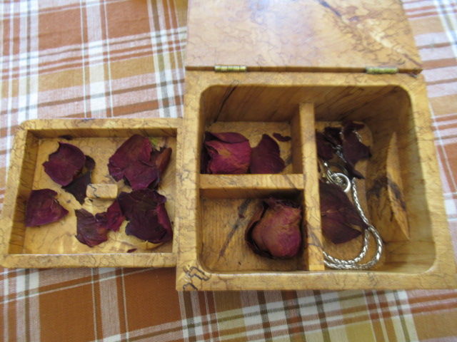

OK, here is the spalted maple box. This was my first attempt at making a box, other than a bandsaw box. The wood is from a tree that was downed on my property. Hope you like it. The photo with the rose pedals shows the pedals from our 25th wedding anniversary . We renewed our vows at that time.  Viewing might be best, bottom to top

Thank you, Al.  That is truly incredible.  And, the craftsmanship is superb.
Now, I wish to know, if you'll part with trade secrets.  (Please be careful as others may be watching.)  I wish to know how to cut out the center.  It appears as if you used a bandsaw but I can't find an entry mark.  And, I like the little tray support on the right side of the box.  And, I am guessing that you used the table saw to shape the lid for those angles and to make the dado around the bottom.  Close?  Thank you for posting and sharing another absolutely beautiful box.
No secrets here Steve.You described the process pretty well.  The entry cut was on the back of the box. I glued the cut closed and clamped it tightly. The cut virtually disappeared. Every joint on this box is no more than a butt joint.
Every cut was made with the TS and/or BS. It couldn't get any simpler. Everything from the stump
to the finished box.

It's just a small box Steve. I sized it according to what material was salvageable. Everything was cut 3/8" thick except the top which, ended up about about 1/6" short of the 3/4" I had hoped to get. The box measures 5 1/4"w X 6 1/4"L X 3 1/8" deep not including the top. What type of cedar do you have, Red, white, aromatic ? Working with cedar did cause respiratory issues for me. Definitely recommend wearing a mask.
