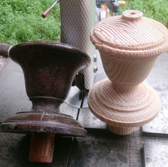

February 23, 20206 yr Popular Post comment_219527 Did this test run on a piece of fir on Friday. Need some wood epoxy to fill in all the chipped areas. Also, need to narrow down the section just under the upper ring. It's a bit bigger than the 100 year old piece. Once I get this right, I have 4 more to make. The next 2 days will be turning one or two. Report
