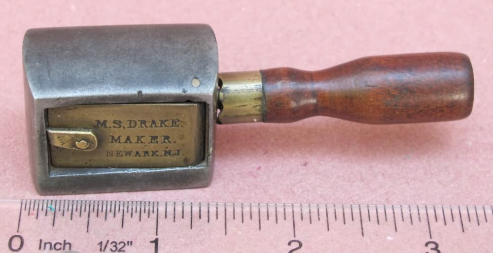

    Here's a start...owe you the rest.

    Winner @HandyDan Hat Iron or ~ answer was submitted and accepted by the MWTCA. Great job Dan! Rob Hartman of the MWTCA What's It review panel, gladly accepted Dan's answer and stated he'll p
Hot iron for forming leather for horse tack.  Tight curves over horses head, leather stirrups, etc.  Flip it over and it is rounded and smooth.

I agree that it is an iron for something.  What puzzles me is why there is a hole in the handle on one end but not the other end.  Does the knob on the center piece fit in there?
I think the hole is so you can put the string for the name/number ID tag through it.:rolleyes:
Someone was REALLY planning ahead!
John
For making dog tag blanks....one at a time. :OldManSmiley:
You put the gold dust in it to melt into bars.
I blew the picture up and there is a hole on the left handle but it is horizontal.
AND appears to have a string through it! Nice call, @Grandpadave52! :TwoThumbsUp:
Look real close at the top picture where the tag string is tied.  I can see the dark shadow of a hole in that handle too.  Must be a fixture for hands free use that is not with it.  This is another tool that needs a couple more pictures.
So it appears both handles can pivot independently, perhaps a specialty iron for smaller linens, or ties, or?
I think the body of the piece is threaded to accept the handles.
Could also be an iron to smooth veneers on legs.....
Looks like you heat the slug of iron red hot and unscrew the one handle and screw it on the hot slug ,drop it in the tool and slide the lid closed and then.........................
Notice that the left side of the steel case is thicker for some reason.
Herb
I might add that it might be the "eye" in the handle might be to stick a rod in to loosen the handle to unscrew it.
HErb
Salesman Sample / Miniature Hatters Iron   This rare little iron is marked M. S. Drake Newark NJ.  He held a few patents related to irons.  This exact iron is pictured in one Politzer's books and is the only one known.   Very nice!
https://www.antiqbuyer.com/All_Archives/IRONS_ARCHIVE/Great_arch2.htm
NOTE: The one on display may have two handles for left hand or right hand use by removing one handle or the other.
Edited by HandyDan
I think you're darn close Dan. This information makes a really strong argument.
I agree, Dave.  The picture makes for a strong argument.
@HandyDan
I think you got it,Dan, If you notice the bottom side is thicker then the top, just like the "What is it". So they must heat the chunk of iron and drop it into the tool then iron the hat. It may be that the only use for the one handle is to install and remove the hot iron chunk.,and it is only stored on the unit. Also I noticed the one you pictured ,the little door hinges up and out.
Dan, I think you have it.
