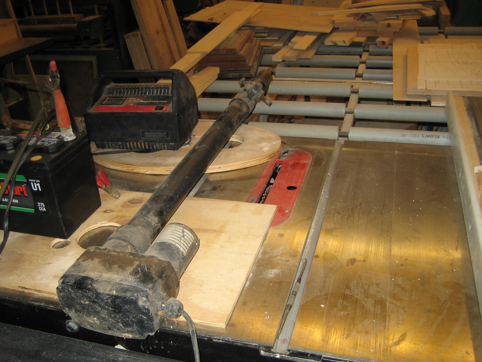

I don't use any protection, guards or splitters , just a blade sticking up there so I attribute safety to the low blade.  I don't listen to music or talk to people when I'm using tools in the shop.. Its me against the sharp things in my shop..   So  I would not be a very good teacher would I?IMG_1033.thumb.JPG.c9a7395ee33877581bb5d572a505c908.JPG
