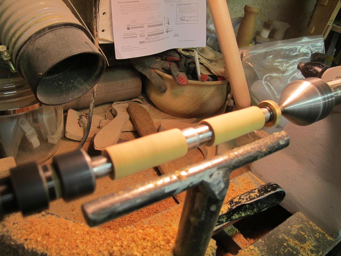

July 14, 20188 yr comment_154111 Every new projects requires a new piece of equipment, at least that what I tell Mimi. I turn pens on a full sized lathe with no trouble. Things you really do need- Pen Mandrel- get a good one that allows for adjustable lengths If you have a lathe chuck- pen jaws (Check back in "Wednesday's Wisd..." One of our turners made a set) Jacob chuck for the lathe The jaws and chuck allow you to do all the drilling on the lathe with no special vice. When making a pen/pencil you have to square the blank with the end of the brass tub. If you have a sanding station, that works just as good as a pen barrel trimmer. When you buy the pen kit, make sure you have the exact sized brad point bit. Most are in mm. Also make sure you get the exact bushing for the kit. After a while you'll get a collection of bushings. Keep them labeled, they are easy to get mixed up. Everything else you can make or adapt. Report

July 15, 20188 yr comment_154138 I have a pen mandrel but now a lot of people are turning between centers without bushings. The bushings Lew pointed out are sized so when the wood is turned to the size of the end of the bushing it will then match the pen parts. Of coarse that means you have to use a caliper to size the ends. Report
July 15, 20188 yr comment_154154 I have found it works better to sand the brass tube before I glue them in the blank to rough it up. I also use 5 minute epoxy to glue them in. Report
July 15, 20188 yr comment_154197 17 hours ago, lew said: Pen Mandrel- get a good one that allows for adjustable lengths The standard pen mandrel uses a knurled nut to tighten up the bushings to the blanks to enable the turning with a dimple in the end of the mandrel shaft, which receives the point on the live center of your tailstock. I've heard if you try to tighten up too much with the tailstock, it can deflect or warp the mandrel shaft. Look into a mandrel saver. It allows the end of the mandrel to pass through the center hole of your tailstock, and it tightens up directly on the bushings. 17 hours ago, lew said: If you have a lathe chuck- pen jaws (Check back in "Wednesday's Wisd..." One of our turners made a set) I made that set, just for fun. Be aware that his design seemed to me to be sized for 1/2" square blanks. I didn't realize that until I tried to put in a 3/4" blank, and I couldn't get it in until I enlarged the cut-outs to fit the blank. Although, that may have been a limitation of my chuck, I use a super nova 2. Just FYI. I had a problem with tubes coming out when I was squaring up the blanks to the tubes. Read my post about this on this forum. I got some good advice and it might save you some problems. Report
