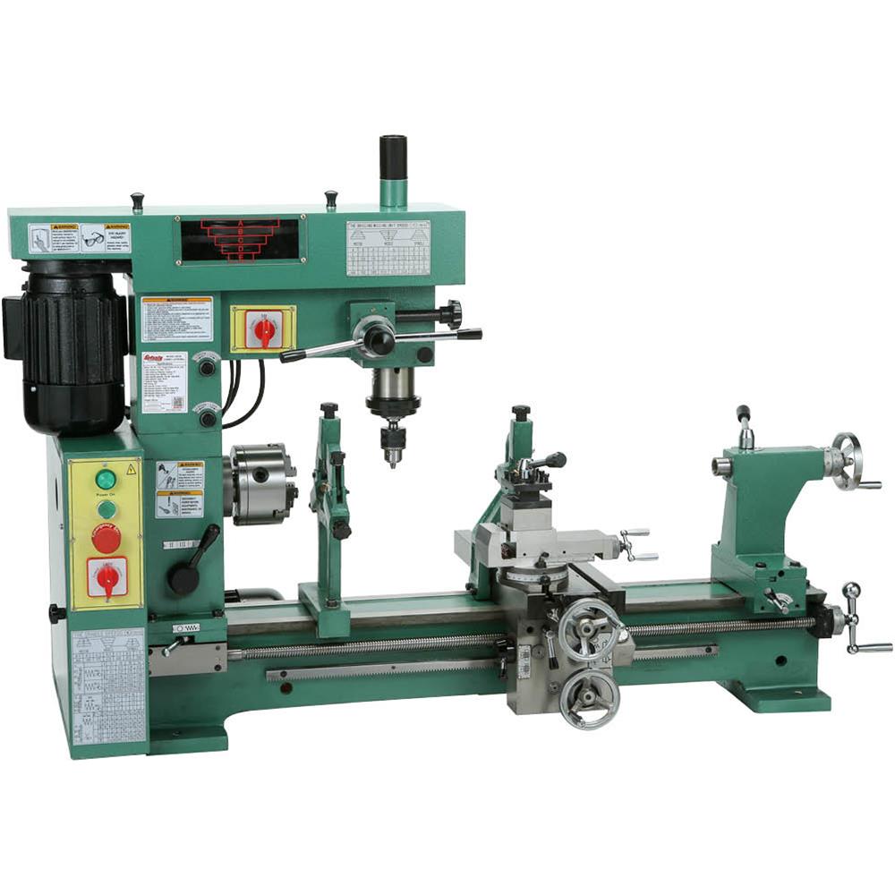

The only thing I see- and I'm not a machinist so I could be way off base here- is that it looks like the distance from the mill head to the lathe bed is fixed. The mill spindle travel is a little over 4". You might need to make an auxiliary table for smaller work.

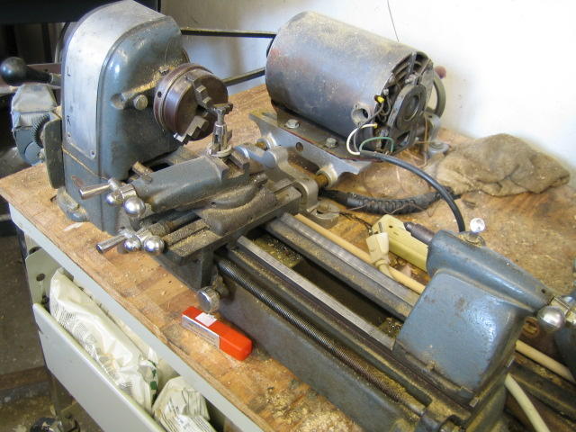

I have this Atlas lathe and tooling and also a 3 and 4 jaw chucks.  It has a six inch swing and has been adequate for what I have done over the years.  It has self feeding capable and I wouldn't want to be without it.

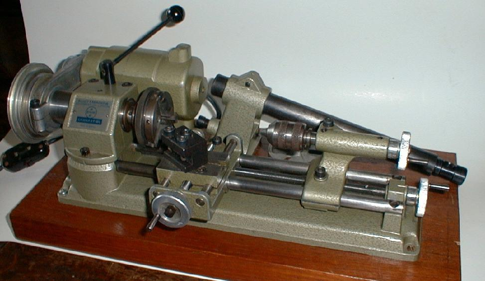

I also have a Unimat hobby lathe and have used it more than the bigger one.  Having both is great.  It doesn't have self feed but I wish it did.

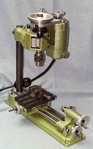

It can be transformed into a milling machine in a few steps.  I haven't often had the need for that but glad it was available when needed.

Steve, Not much help as far as owning or using one and unsure, what you plan to do or would like to be able to do or budget.  With that said, based on what I've always heard and know from a couple guys who have them,  the Unimat 3-n-1 like Dan has is pretty popular with the home machinist.
That is one beautiful lathe Dan. Have you refurbed it or just maintained it to that level. The little Uni is pretty sweet too.
Those are oictures from Google Images but mine are in that shape.  As we all know a little care for our tools goes a long way.
That Grizzly combo you referenced seems to have good specs. The MT sizes are good for that size machine. There are some advantages to a combo machine over having two separate machines. You can devise an indexing system for the lathe so you can index work to use the milling spindle to flute & keyway but you won't be able to cut gears w/o some changes. Take my comments with a gain of salt since I'm just a hobby machinist, no professional training other than YouTube university. I don't know what a 4-bolt intrinsic spindle is? The tail stock has a 2 1/2" travel which you may find limiting for drilling. the slowest lathe speed of 175 will seem pretty fast for threading toward the head stock but there is an easier way. Just thread away from the head rather than toward. It will require that you turn the tool upside down and run the spindle in reverse, but works well.  There will be many additional things you will eventually want as you learn to make things. A short starting list: Live center for tail stock, 4 jaw chuck, HSS tooling in assorted sizes, boring bars, center drills, a milling vice, sets of parallels, a boring head & tooling (forget the typical brazed Chinese boring bars for the head!) My lathe came with a quick change tool post that I find really convenient. I don't have any inserted lathe tools other than boring bars and an internal threading bar, I don't think you will need any either since they are really designed for taking deeper cuts at higher seeds than what you can do. I did buy an inserted 2" shell mill for my milling machine and it works surprisingly well, especially considering how cheap it was. I had been using a fly cutter, worked, but slow. The milling feature of the combo machines have really limited Y axis travel. So you will be restricted to very short y axis travels but you will have the full travel of the carriage in the x axis. Since the combo machines don't have a quick change gear box, you will probably end up finding a speed/ feed that works for most things and only do the change gears when forced into it. My lathe has a pretty decent gear box but I have to use the change gears to go metric, PIA!

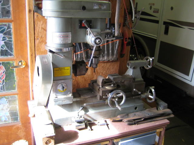

 This 3 in 1 mill??of some kind was the last thing I bought about 5 years ago . It is a 2000 model and a woodworker bought it new...The 3 cost me about 1000 to 1200?? or less, too long ago to remember. They might get turned on
every other year or so....and if I need to use one I do clean it and oil it and grease it then it sits for a year or so collecting saw dust.

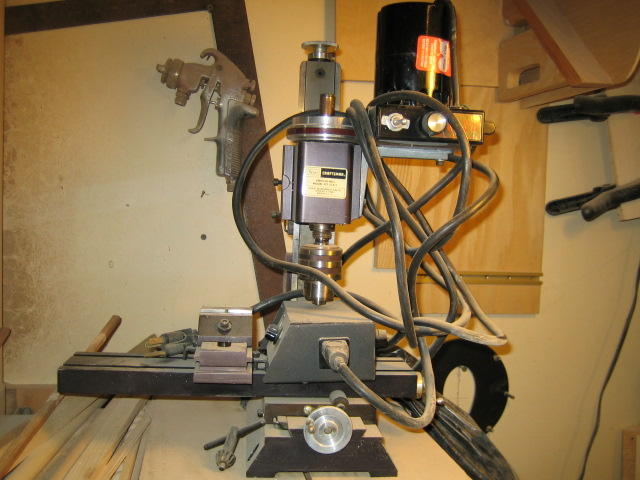

  The mill runs either direction and has 2 motors.IMG_0158.JPG.2101f28861b8124f8abcc3977b63cd75.JPG.
The little craftsman unimat is only good for small bits like smaller than 1/4"

I've never used a grizzly.  It's that genre of machine that is the problem for me..   The cross slide is too small to be practical as an X - Y table, I've never seen  one with a dovetailed  column.  They hang out too far for the amount of iron they are made with so they lack the rigidity needed. Occasionally  they have square columns which is the next best thing but a round column is  unworkable. They  slip  under the stress of machining moving the cutter out of position, The heads rarely have tilt capability, and the overall scale of what can do with them is - - well it's tiny.  Once you get a vice on the table   you are pretty much out of headroom.  You can not  put a flycutter in them.  They tend not to have geared heads so  controlled boring is not available.
I'm speaking as an old school machinist toolmaker.  If I could find the room  I'd have a monarch toolroom lathe and a bridgeport. Heck I'd have a full machine shop if I could fit it in my space.   Since I can't fit it I'm looking ad machinery  that is way smaller than I'd prefer.
But on a dare I would not own  one of those combo  miller/lathe things.
Maybe if I were a watch/clockmaker. But it'd have to be a very high precision machine.  I don't think any of them are.    Maybe if I made RC cars and planes?  Small stuff.
Google around on the  Machinist and  machine shop forums.  People hate those things. They let you down every time.
