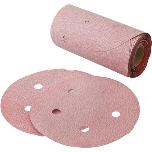

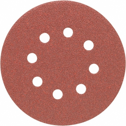

the H&L pad on the sander is worn out...
change it...
change the pad on your sander from H&L to PSA....
also, the holes are there for air flow to the motor...
PSA sheets can be had w/ or w/o holes...
th?id=OIP.hJXkC4lJ5cluOaR1OXfmLAEsEs%26ph8955-ea64756d10cc39db7bbaa394ffe57138.jpg7138779_21__41676.1412711566.451.416.jpg?c=2
