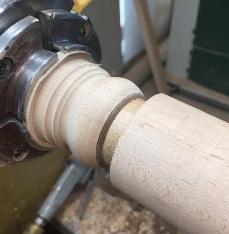

4 hours ago, Stick486 said:
please do....

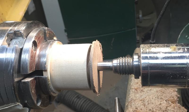

Stick, I was further along from yesterday than I remembered but I think you'll get the idea.
This is the body of the box, it has been partially hollowed and the inlay is glued in place. Just using tailstock pressure until the glue sets.

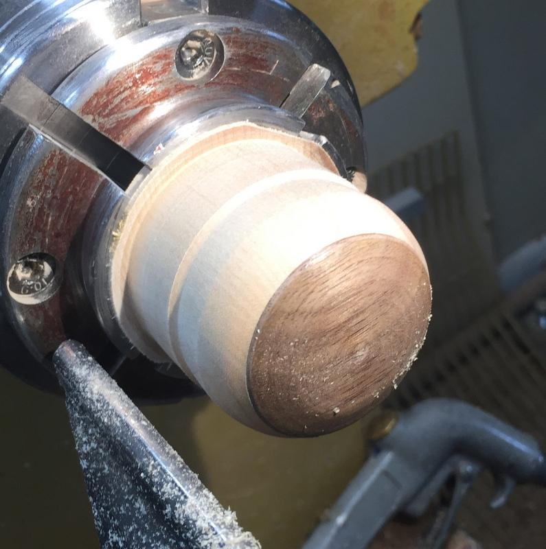

In this picture a lot of the waste has been turned away. The box has a little shape on it.

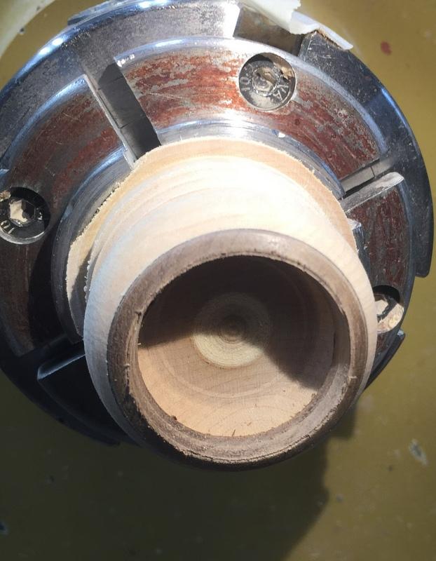

Here is the box with the center of the inlay material parted out. The piece that was in the center will become the foot of the box.

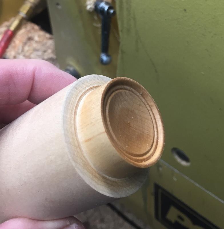

This is the underside of the lid/finial. It is sanded and waxed at this point.
Here the lid/finial is fitted into the recess in the inlay. The lid gets fitted twice. A snug fit for turning the finial and then a loose fit for actual use of the box.
Shaping the finial, the box is getting a little more shape on it as well.
Hope that helps, let me know if you'd like another view.
Steve

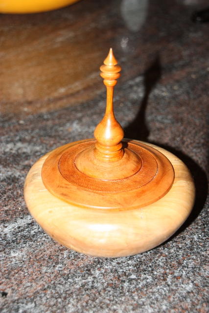

Steve you probably have pics similar but this is the finial I am referring to . The disc at top and bottom is difficult to turn in some woods. I use a skew and a Drozda style point point tool to do it on mine . This is one that she displayed in 2015 but she did the star box , just this is a clearer pic.IMG_4533.JPG.237d596aeea907aecd21913aa2d4ec85.JPG

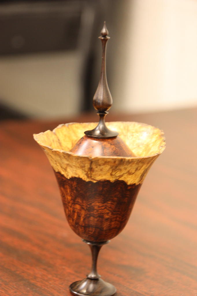

A couple years ago I did one slightly modified by inspires by her finial. I do not do many but felt good to get one good one.1-IMG_5854.JPG.16941f7d4b2a0ae689c90da95bfb5f29.JPGBy the way i made the point tool from a BB 3/8 bowl gouge. That tool really makes a difference in doing this kind of work.
