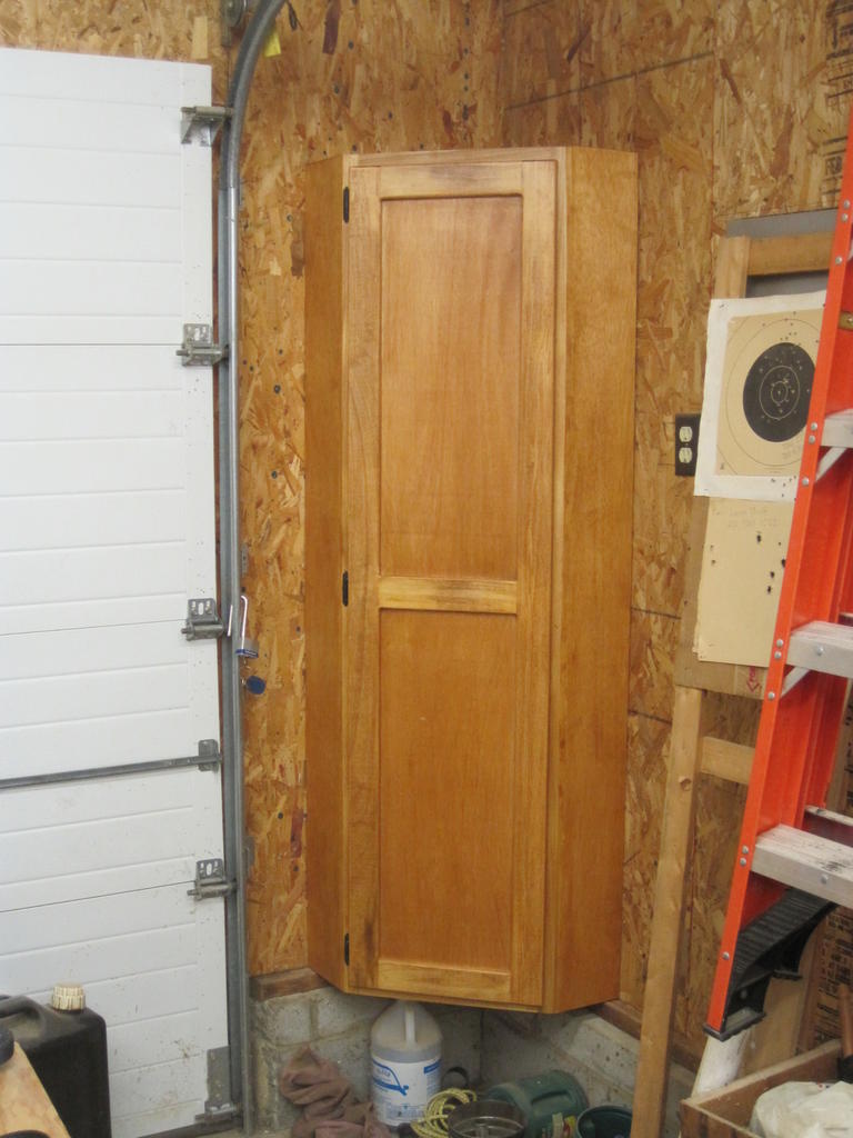

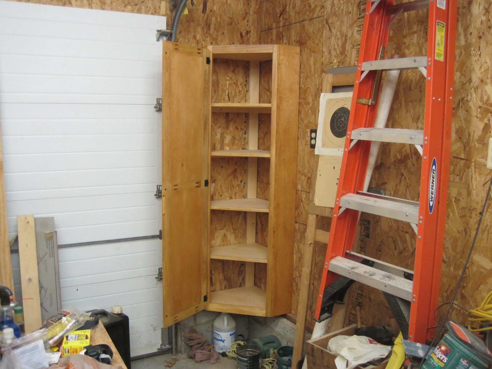

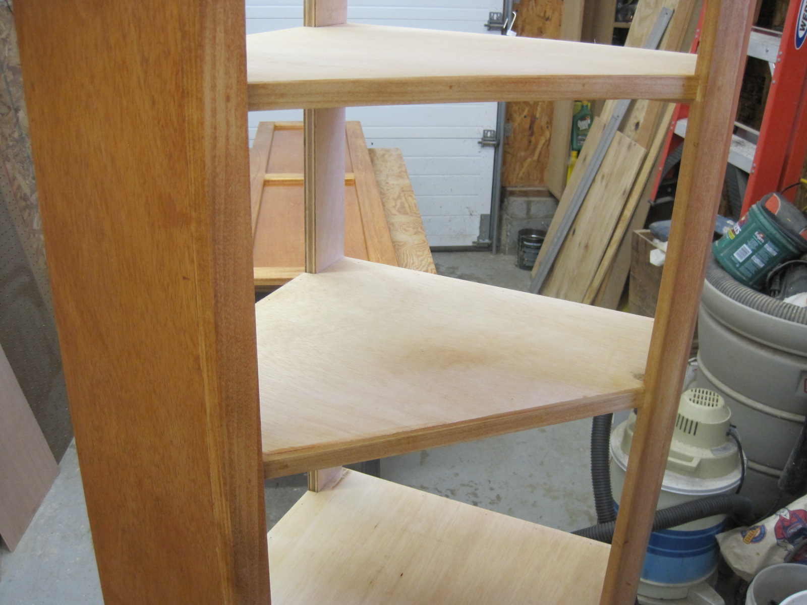

October 26, 20179 yr Popular Post comment_129089 I've done a couple over the years, the last two were made like the sketch below. I did one recently to fill in a corner of the shop (see photos), took a few short cuts with it, but the general construction is the same. I made the shelves fixed, so was able to eliminate the rear "sides", fixed the shelves to the ends and the strip in the back. I cut the edge of the face frame stiles at 45°, clamped them in place and measured for the top and bottom rails. After the face frame was glued in place, I planed the projecting "point" flush with the sides. Other than the 45° bevel on the back of the stiles (and the edges of the back filler strip), all of the cabinet joints are 90°. Don't know if it's "Fine Woodworking" but it makes a nice sturdy cabinet and easy to make - and I like that the front edges are solid wood which makes the corner less fragile and prone to damage. Corner Cabinet section.pdf Report

October 26, 20179 yr comment_129168 I think the OP's sketch is correct - the angle between the two "backs" is 90° to match the corner of the room, and the "sides" are shown as 90° to the wall, so the corners of the cabinet are all 90°. You don't get to a 45° until you get to the face frame joint - it was easier for me to make all the (plywood) case pieces with 90° edges and cut a 45° only on the outside, back corner of the stile. Easy to make the top/bottom panels and the shelves as they're just a square of the appropriate dimension with a 45° clip on the outside corner - I carefully laid out the first one and then used it as a template to make the others. Report

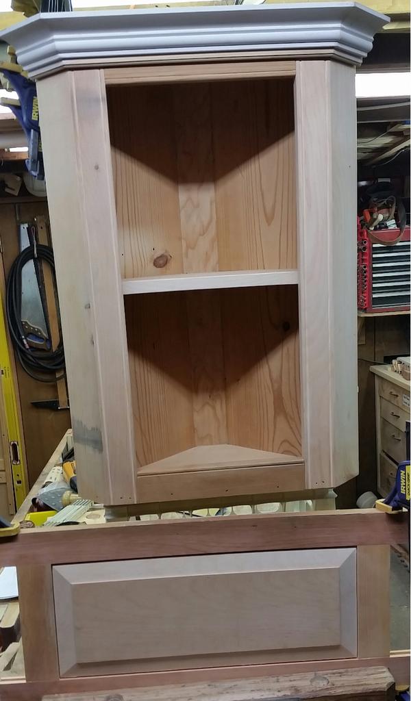

November 4, 20179 yr Author comment_130172 Guys, I have put in another day (1/2) and here is where I'm at. The Mrs. said she will be painting this with chalk paint so used some primed crown I had on hand. Report
