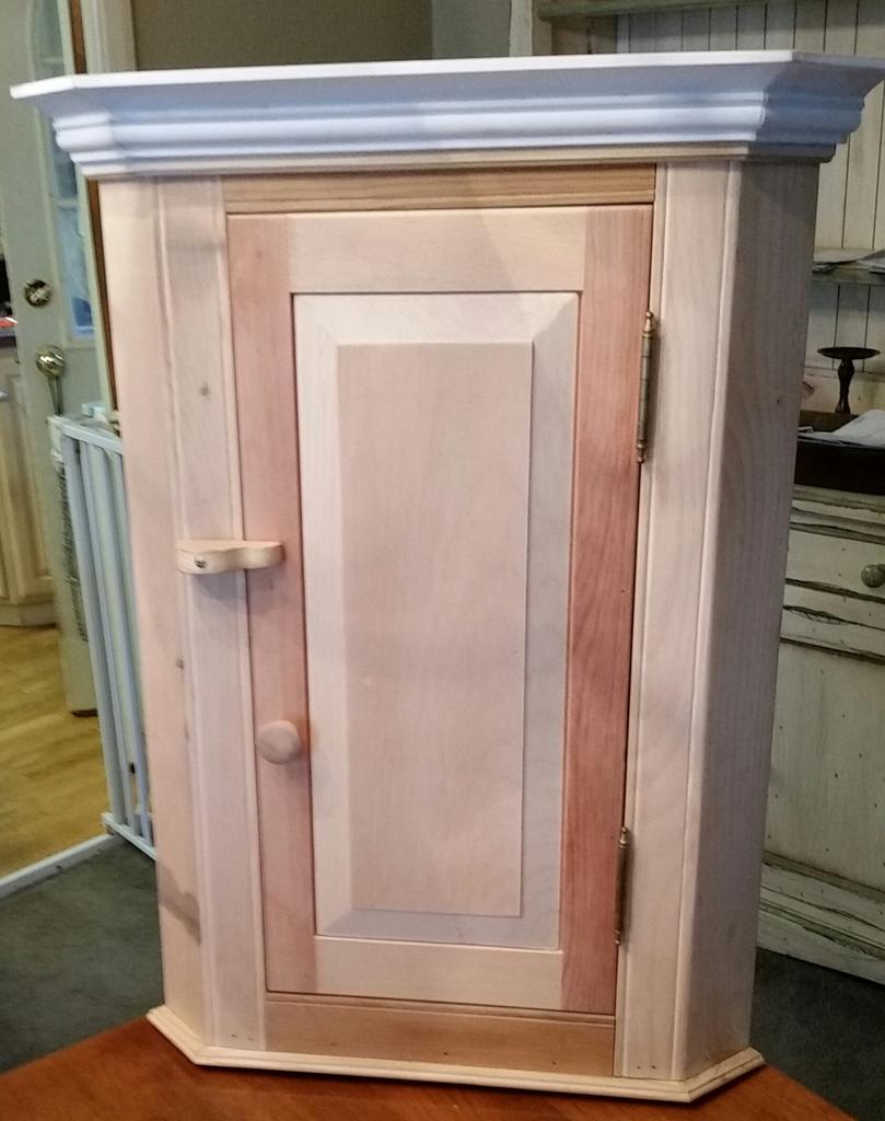

November 5, 20179 yr Author Popular Post comment_130303 Here is the final product b4 the Mrs. adds the chalk paint. I will post the final after it's painted and hung a little down the road. Report
