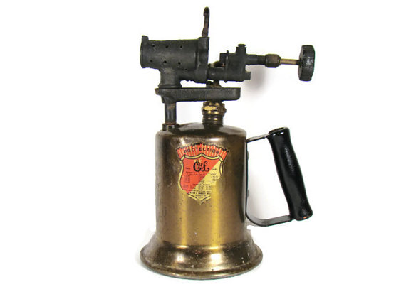

August 14, 20179 yr comment_120533 FASH burn the rough saw w/ a weed burner on low and then scrub it w/ a dry scrub or wire brush... vacuum before painting... there was another reason for these in the yesteryear... Edited August 14, 20179 yr by Stick486 Report
August 14, 20179 yr comment_120534 2 hours ago, Dadio said: Also here I would have to get a permit w/Engrd stamped plans submitted to rebuild my deck. the get around the engineer's stamp in many places is do not to attach the deck to the structure... but you still need to be code compliant... Edited August 14, 20179 yr by Stick486 Report
August 14, 20179 yr Author comment_120545 8 hours ago, Stick486 said: FASH burn the rough saw w/ a weed burner on low and then scrub it w/ a dry scrub or wire brush... vacuum before painting... there was another reason for these in the yesteryear... Thanks Stick! Would that kill the rough sawn texture? We want to keep the rough look. Report
August 14, 20179 yr Author comment_120548 29 minutes ago, John Morris said: Thanks Stick! Would that kill the rough sawn texture? We want to keep the rough look. Actually, the more I think about it, the burn would just get rid of the pesky small fibers that are clogging the rollers, but leave behind the rough texture, yep, this would work. Could just use a regular plumbers torch that I have. Just quickly skim the surface before painting, then run a stiff broom over it all? Report
August 14, 20179 yr comment_120549 29 minutes ago, John Morris said: Thanks Stick! Would that kill the rough sawn texture? We want to keep the rough look. meant to say FLASH burn... if you cook it it it will remove the rough saw... a flash burn quickly done only takes care of the loose and fine fibers... Report
August 14, 20179 yr comment_120550 2 minutes ago, John Morris said: Just quickly skim the surface before painting, then run a stiff broom over it all? yup... use propane and a spreader tip... vac before painting... Report
August 14, 20179 yr Author comment_120551 Just now, Stick486 said: yup... use propane and a spreader tip... vac before painting... Thanks Stick! Report

August 14, 20179 yr comment_120568 2 hours ago, John Morris said: Actually, the more I think about it, the burn would just get rid of the pesky small fibers that are clogging the rollers, but leave behind the rough texture, yep, this would work. Could just use a regular plumbers torch that I have. Just quickly skim the surface before painting, then run a stiff broom over it all? Get @Smallpatch to send you a weed torch and you won't even have to bend over. Rumor has it he has extras. Report
August 14, 20179 yr comment_120602 Sorry I done took the extras to the Abilene HD even though we ordered them online. The store was kinda puzzled for us bringing them back to them even though we only ordered one and paid for one!!! I said hey, I'm just saving you a little freight!!!! I don't see how a torch would do away with the ruff saw marks unless you stand there with your finger up your.... and burn the boards completely up... Would the code okay the design if you installed 4x4's in a few places against the house so it would be a free standing structure that happens to be attached. Report

August 14, 20179 yr comment_120613 28 minutes ago, Smallpatch said: I don't see how a torch would do away with the ruff saw marks it's the loose/fine raised grain splinters and fuzzies he's looking to get under control while still keeping the rough sawn look... Report
