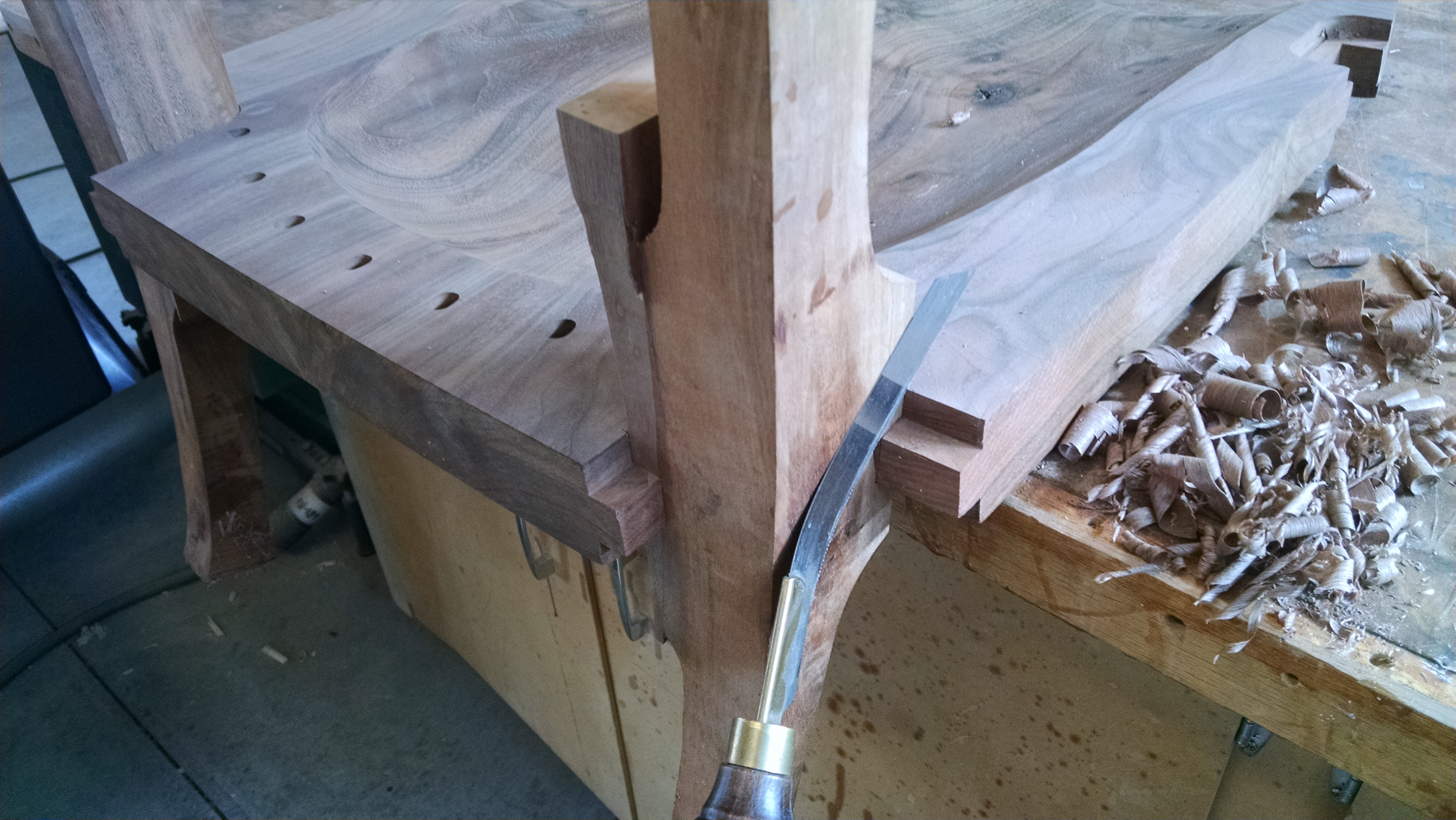

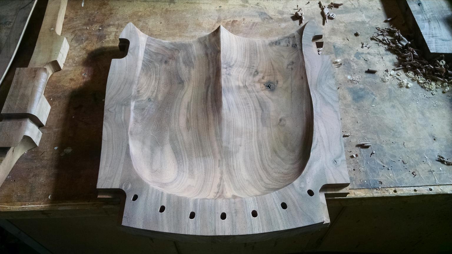

October 1, 201610 yr Popular Post comment_76925 Been working on a Claro Walnut rocker this morning. I have my seat shaped and sanded to 220. Working my way through the grits on my way up to 800. I'll have the seat and bottom sanded to finish, then later I'll need to shape the rest of the seat once I get the legs measured and mounted. Love the smell of Walnut in the morning! Report

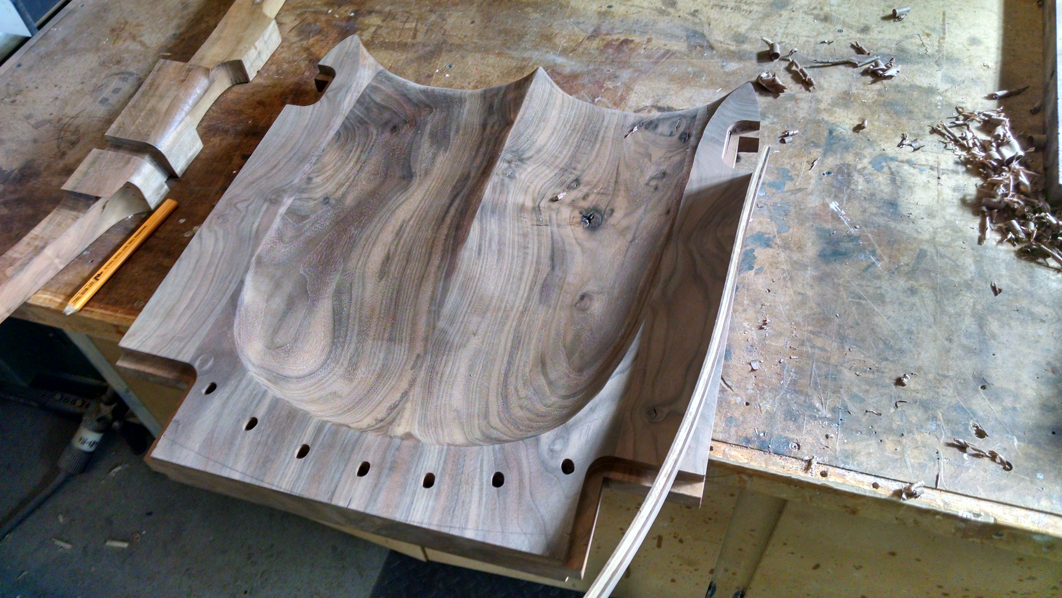

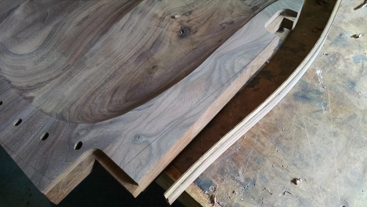

October 1, 201610 yr Author comment_76950 Thanks all! I'll be doing some hit and run posts here with photos from my shop, and I'll get on later and answer questions and give feedback Marking reference points to further shape the seat. These marks are made at both rear leg to seat joint locations and an elegant line will connect the locations to further shape the seat. Report

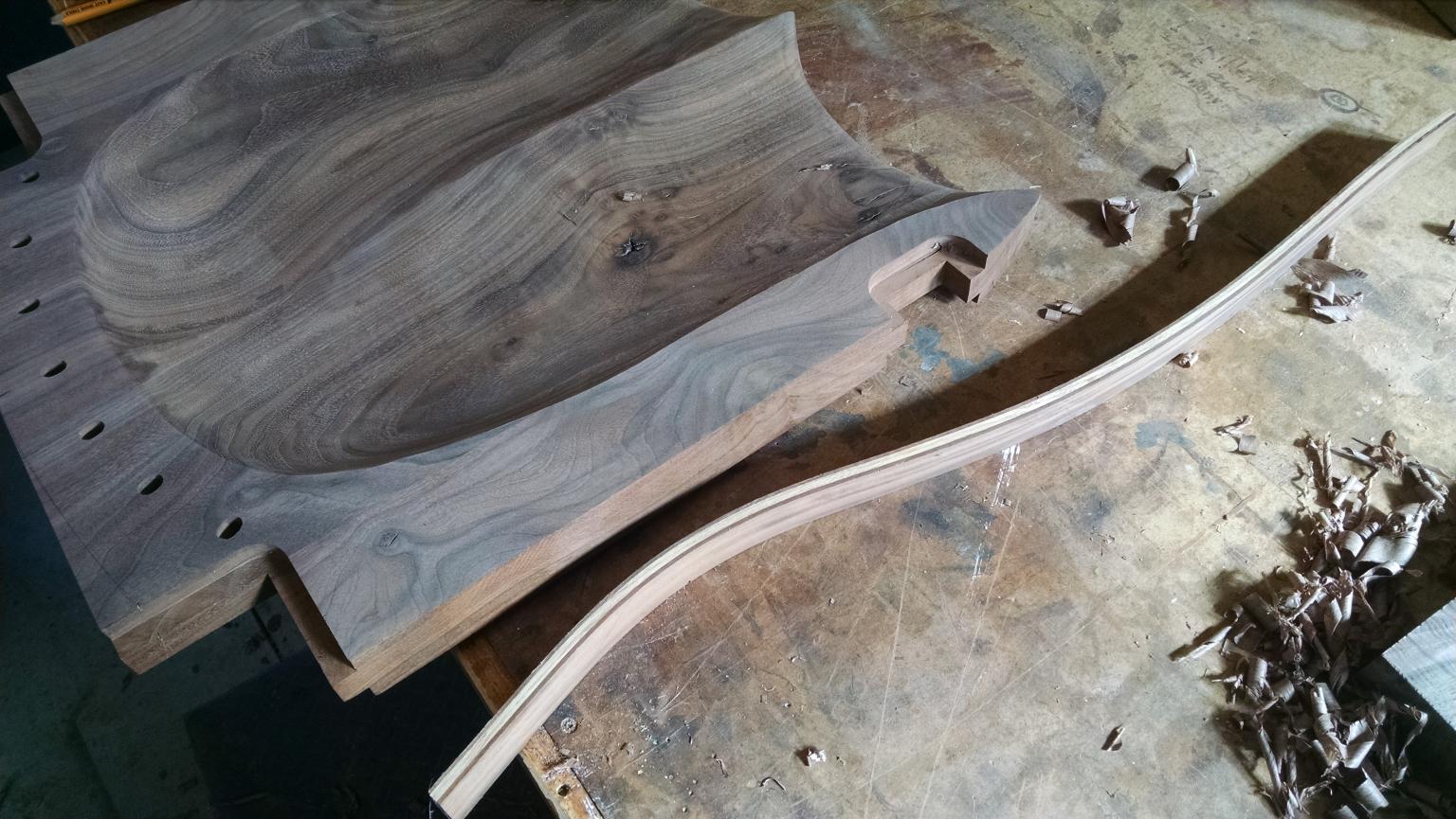

October 1, 201610 yr Author comment_76952 I don't use templates for the seat layout, I already have some built into the project. In this case I use a back rest lam that I already made for this chair, and it works beautifully for the outside seat lines. The backrest generates a beautiful line. It's just one more way for the lines of the chair to flow into each other. In a way, the backrest is now speaking to the seat Report
October 2, 201610 yr Author comment_76964 2 hours ago, Stick486 said: That is absolutely beautiful! and then some... what method did you use to shape the seat and why are you heading to 800 grit... Stick, not only do I take it to 800, but I'll go 1200 Abralon for the final buffing before the oil varnish is wiped on. The idea is to "buff or burnish" the wood before the finish is applied, the chair actually looks and feels finished before the finish is even applied. It's quite spectacular the fine, glassy automotive finish these chairs have. EDIT: I used power all the way for the scooping out of the seat on this rocker, a side angle grinder with a Kutzall wheel. Report
