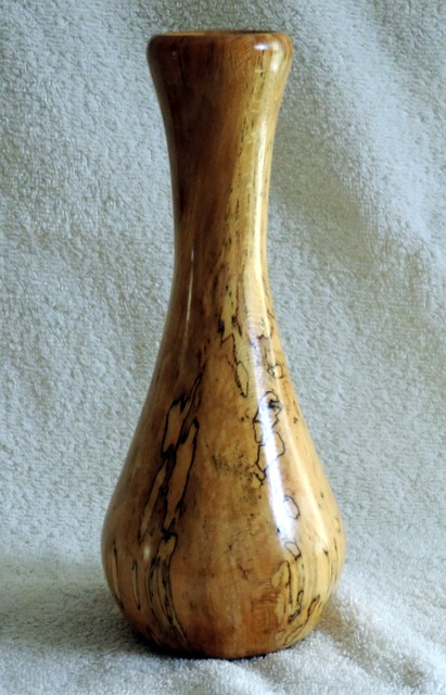

September 9, 201610 yr Popular Post comment_72925 1 hour ago, John Morris said: I have a pretty good sized pile of firewood @HandyDan, been wanting to get in there and split some stuff up, it's mixed, all kinds of stuff. John, I had been seriously turning for fun maybe about a year and I decided I wanted to learn how to use a skew chisel. It just happened that we'd had a sycamore tree taken down a couple years before that. I went out to my wood pile and got a piece to play with. This is the result. To this day, one of the prettiest pieces I've done IMO. It literally was firewood and I burned a ton of it before I realized what a treasure it is. Steve Report

September 9, 201610 yr Author comment_72934 2 hours ago, Steve Krumanaker said: John, I had been seriously turning for fun maybe about a year and I decided I wanted to learn how to use a skew chisel. It just happened that we'd had a sycamore tree taken down a couple years before that. I went out to my wood pile and got a piece to play with. This is the result. To this day, one of the prettiest pieces I've done IMO. It literally was firewood and I burned a ton of it before I realized what a treasure it is. Thanks so much Steve, and that is one beautiful piece of firewood indeed! Stunning actually. Thanks for the encouragement! Report

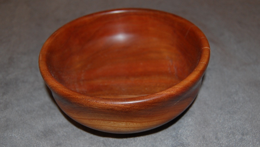

September 9, 201610 yr Author Popular Post comment_72936 Here is my firewood bowl I turned today after posting this topic. Just couldn't wait to dive in. It's about 5" diameter, I think, I did not measure it. Report

September 9, 201610 yr comment_72941 That is a very pretty bowl! The grain and color is outstanding Report
September 9, 201610 yr Author comment_72943 16 minutes ago, Chips N Dust said: That is a very pretty bowl! The grain and color is outstanding Thanks Kelly! I think the wood may be from a Fruitless Plum we cut down from our front yard after termites got to it. Got lucky again, nothing flew off the lathe yet! Report
September 9, 201610 yr comment_72952 6 hours ago, John Morris said: Here is my firewood bowl I turned today after posting this topic. Just couldn't wait to dive in. It's about 5" diameter, I think, I did not measure it. Great color! I love the shape! Report

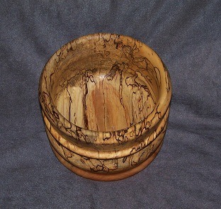

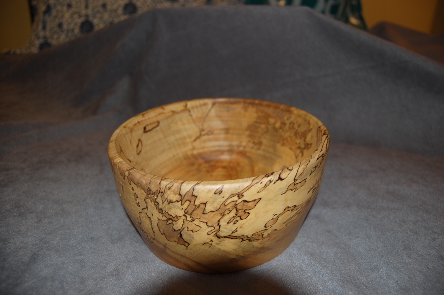

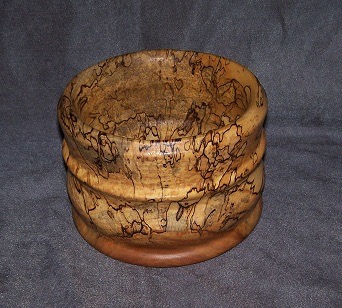

September 9, 201610 yr comment_72954 John, as Steve said, Spalted Maple gives some much of a different look. Here is a Spalted Maple bowl I turned several years back. And from the same tree, here is a smaller bowl. This little bowl was one of my first attempts. You can have so much fun turning them And Cherry turns very nice also. I love the one you turned. Beautiful grain and a very nice shape. Report
September 9, 201610 yr comment_72956 11 hours ago, Steve Krumanaker said: This is the result. To this day, one of the prettiest pieces I've done IMO. Steve it definitely is... Report

September 9, 201610 yr comment_72960 1 hour ago, John Moody said: John, as Steve said, Spalted Maple gives some much of a different look. Here is a Spalted Maple bowl I turned several years back. so far above my pay grade... most excellent John.. Report
