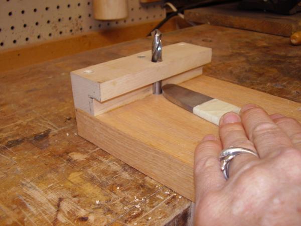

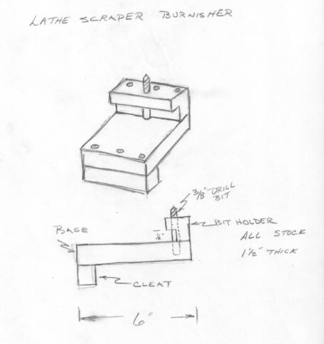

September 3, 201610 yr comment_71871 37 minutes ago, Billy B said: The other approach which I prefer is to hone off that weak bur and put a real bur on the edge using the same technique that you would use to put a bur on a cabinet scraper Here's a little jig I made to do the burnishing- Report
September 4, 201610 yr comment_71927 Great idea on the burnisher. I have tried to make a jig except my idea was a single board with a hole for my burnisher. Got to make this now. Report
