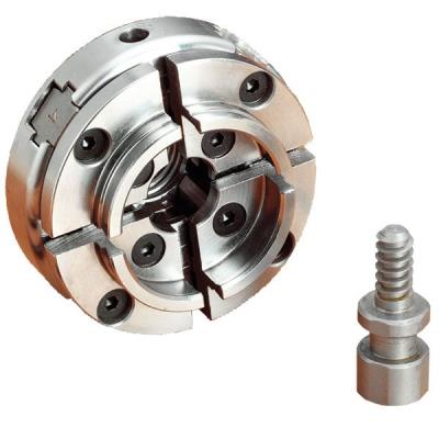

My first chuck was so bad it wouldn't stay tight and the threads were so sloppy that I had to wrap tape around the spindle to get it to stay on. Here's a link to a very high quality chuck maker- http://www.teknatool.com/products/chucks/nova/chuck.htm. I have a Nova Precision Midi chuck.
This particular chuck uses 2 "rods" to tighten and loosen the jaws. Some chucks use a "T"-handled wrench with either an Allen type shaft; others use something that resembles a drill press chuck key end. Turners all have different opinions on the 2 rod system vs. the T-handle. Personally, I don't see a lot of difference between them.
Almost all manufacturers offer chucks of various sizes. That is how wide the chucks will open and close. Depending on the size of your lathe (or projects), you may not need the largest chuck. A small mini lathe would not need a SuperNova2 chuck.

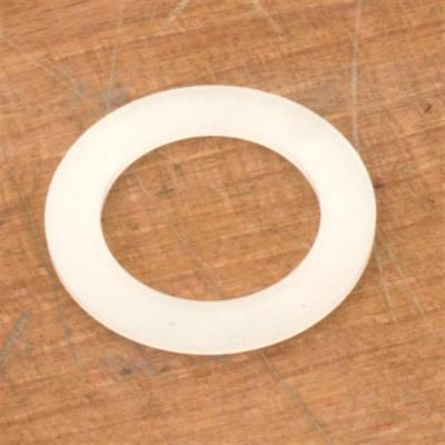

One other thing- when you purchase a chuck, also but a spindle washer that matches the diameter of you lathe spindle threads
http://www.woodcraft.com/product/149358/antilock-lathe-spindle-washer-1.aspx
