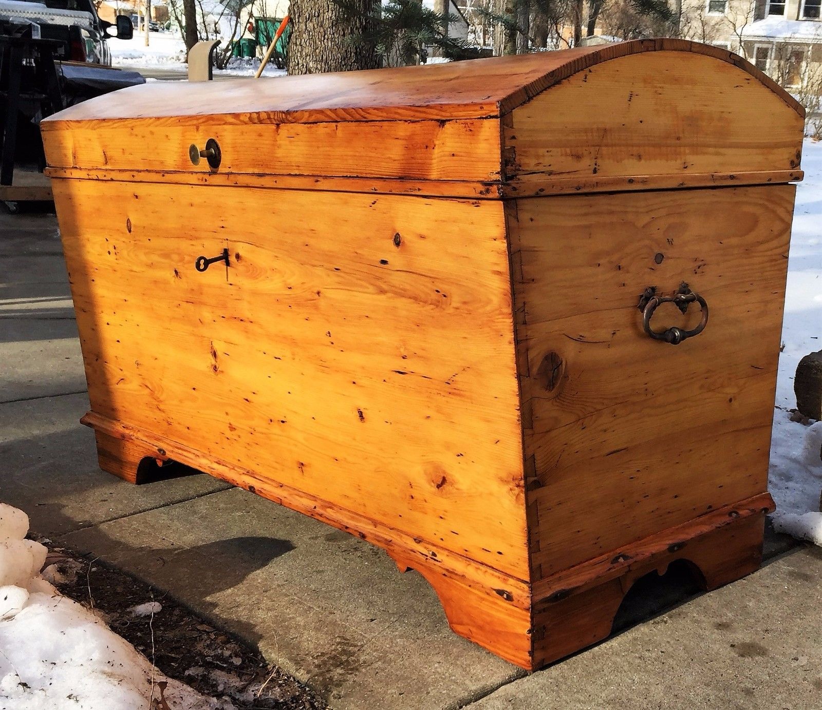

March 29, 201610 yr comment_65612 I don't care how old this chest is, it's been refinished, retrofitted with non original hardware, and it has no legacy, nothing, nada. This guy is kidding right? That being said, you don't need lineage or legacy for a historical piece to be of value, furniture can be graded by other means, but this piece has no other means, not even the original finish. This chest is nearly 300 years old, pine would have a much deeper amber patina to it with that amount of time behind it. So either two things are happening here: He sanded it down before refinishing, in which case the piece is worthless. He Found a chest that is much later than originally thought in age. If you look at the darker spots where dings and nicks have formed, they are left virtually black in color, indicating the surface was completely sanded, leaving behind the darker nicks below the sanded surface. This may have been a great piece, until the refinishing took place. Then this fellow goes and adds hardware to it in the form of a chain or something to that fact. I am not a furniture historian by any means, but things just don't add up. Here is the $68,000 eBay link Report

March 29, 201610 yr comment_65618 looking at the e-bay link I can see multiple cross grain scratches around the handles. the nails holding the hinges and handles on might be round? it's a bit difficult to tell other than by looking at the heads Report
March 29, 201610 yr Author comment_65619 Considering the chest was hand planed to final smoothness originally than finished by the early craftsman, if the chest was sanded by this gentleman, all those fabulous hand plane ridges and valleys were likely sanded smooth as well. Report
March 29, 201610 yr comment_65622 I also do not understand the knots. all the old growth timber back then would allow for clear straight grained stock to be used. Report
March 30, 201610 yr comment_65625 It's probably a reproduction. Museum quality restoration. Gotta love it. Now just for giggles a 1700 era immigrant blanket chest would likely be flat topped because in the 1700s space was - - well - - they didn't have much so the top would have served as a place for things while the chest was closed. A google images search of that period blanket chests reveals a dearth of arch tops Edited March 30, 201610 yr by Cliff Report
March 30, 201610 yr comment_65626 4 hours ago, John Hechel said: I also do not understand the knots. all the old growth timber back then would allow for clear straight grained stock to be used. tighter growth rings too. Report

March 31, 201610 yr comment_65637 It has most certainly been refinished and for the most part them want that old darken original finish on old furniture to obtain the high value. Without some special provenance then the chest would only have a value of being old. Report
March 31, 201610 yr comment_65639 Seems like you're being a little harsh, John...after all the listing says it's actually a "gorgeous museum quality restoration" (!) Edited March 31, 201610 yr by Fred W. Hargis, Jr Report
March 31, 201610 yr Author comment_65640 3 hours ago, Fred W. Hargis, Jr said: Seems like you're being a little harsh, John...after all the listing says it's actually a "gorgeous museum quality restoration" (!) OK OK. Then let's say it moved from worthless to 400 bucks?. After all the guy did put some labor into it. Report
