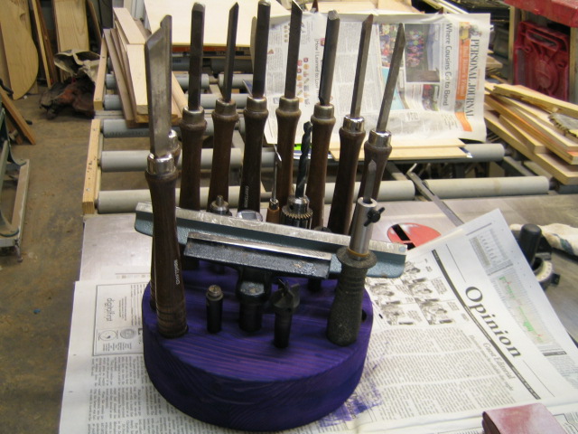

September 29, 201610 yr comment_76550 I'm not even a turner and I got you guys beat on a tool holder. after the paint dried I mounted it on an easy turn swivel and I can swing it around from the end of the lathe to very close so I don't have to stoop, bend or stretch but I do need to pee every once in a while. More of that printers ink. Purty ain't it. Yep, I built all those assist you see in the background. The rollers are electrical conduit which takes the exact size of some go-cart wheel bearings I just happen to have 500 of extra. Notice how I made the slots for the mitre gauge to slide past the rollers. Gotta think of all those things when putting things together. Also notice the break in the side rails the rollers are attached to, that is so I can let longest part of the tablesaw extension swing down out of the way if need be for any reason. Report
