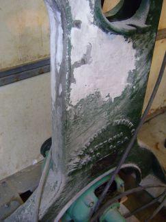

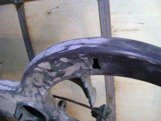

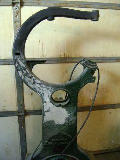

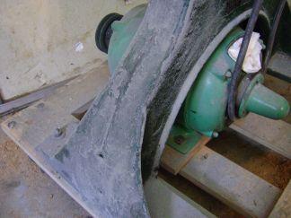

here's an idea of the scope of the body work
remember that was built during the first world war, cosmetics was not a high priority for manufacturing equipment
well im pleased to say that the old crescent works well, actually has been for several months, the guards are new.  I did havbe some issues with bearings getting too warm, resolved that with 30w non detergent motor oil, is does require oil regularly, I add a couple of drops everyday that I use it.  the lower shaft is babbitt, the upper is a steel shaft on cast iron.  the hex hole for the guide post and the table tilt quadrant are also babbitt

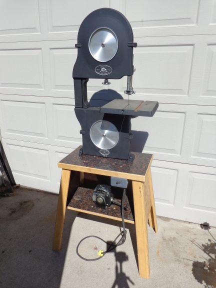

next is the beaver 2300, an allcast iron 12 inch saw, quite rare for some reason, nice little saw001.thumb.JPG.b0bc07d57f1c8af174cb817c06
thent here's the henry power tools craftmaster, this was rebadged and sold by portercable in the states. mine was found in a dumpster behind a habitat for humanity store
001_(2).thumb.JPG.b12bcd2953f36c983c2717
Most of my 1930's Delta's required their share of it too.
I love the smell of Bondo, it smells like victory! :D

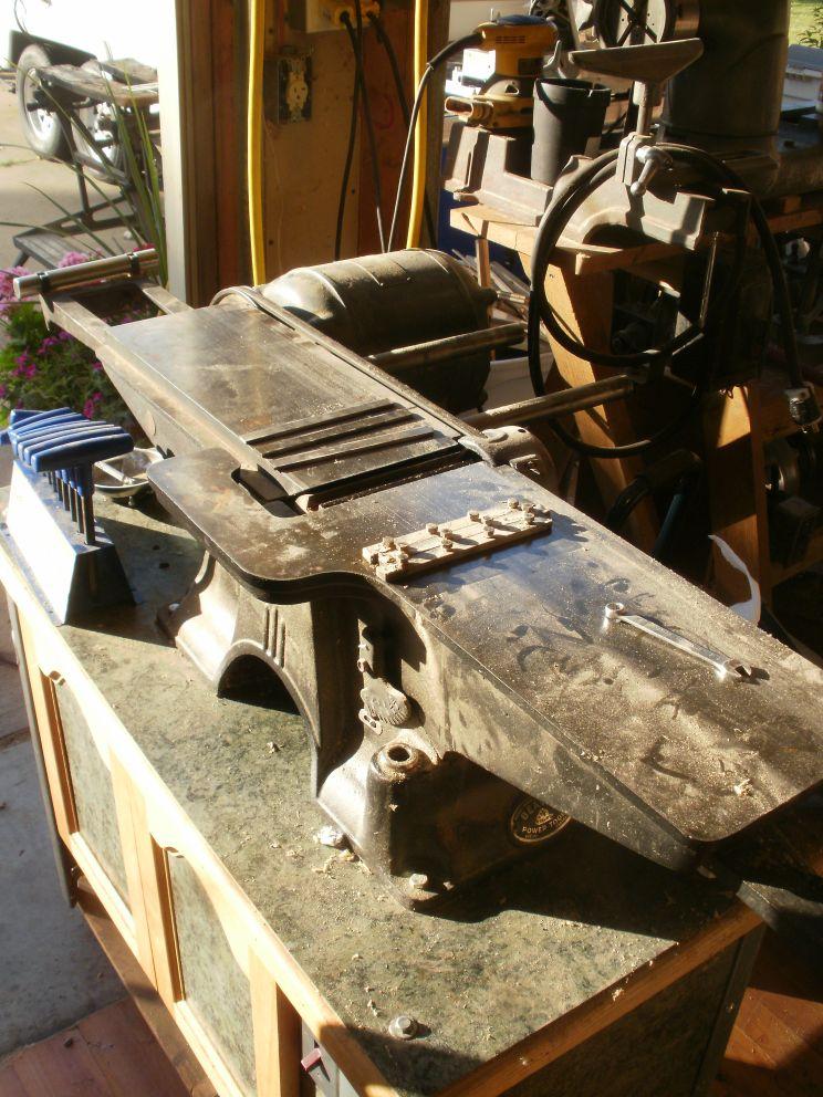

so the jointers.my regular user is a 6 inch beaver 3800
this an older picture, it has a small (Leland)1/2 hp ri motor under the outfeed table, its been upgraded to a 1 hp ri century monster on the other side. has to run on 240, the motor draws 15 amp on 120
i'll get a new picture or two tomorrow.  the 3800 is really unique, there is no spindle, the cutterhead with intregal pulley is mounted in tapered roller bearings, the fence system is a study in walter mitty complexity
I have other jointers as well, but the beaver is my favourite.  note the beaver cast iron leg stand
