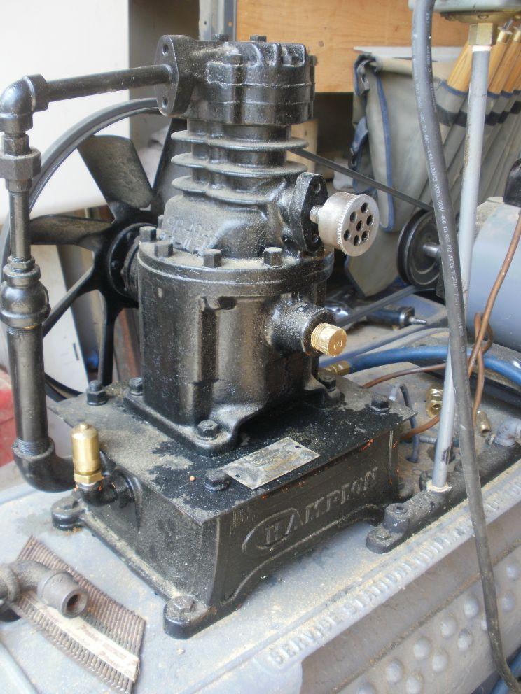

no idea as to the weight, has to 200 ponds plus, the steel tank 1/4 inch thick, those rivets are over an inch in diameter since this pictre was taken ive replaced the motor with a much older ge and redid the plumbing

Love both pieces but more so the Band Saw which could still be used easily.  I'd be a little concerned about the pressure vessel on the air compressor.  I'd be wanting to have it get a "Hydro" before using it.  Older rivetted pressure vessels can (and sometimes DO) leak.  In any case both are GREAT pieces.
there have been some changes to both machines since the pics were taken
like I said the motor is now a much older ge, the entire system has been reversed, manifold on the front, belt drive on the back.  the old riveted tank has been taken out of the system(still there of course but not plumbed in.  the titanic now charges up an 8 gallon portable compressor but im going to hook it up to a modern 20 gallon tank remotely mounted.  the old pump will put out around 150 psi, air flow unknown yet.  very quiet running, warm but not hot.  still needs a drain in the water/oil separator, check valve and a new pressure release valve(not the safety valve, its there and works).  the crappy wiring is gone(nmd 90 and an appliance cord!!).  had to reset the pressure switch and adjust the old guage.

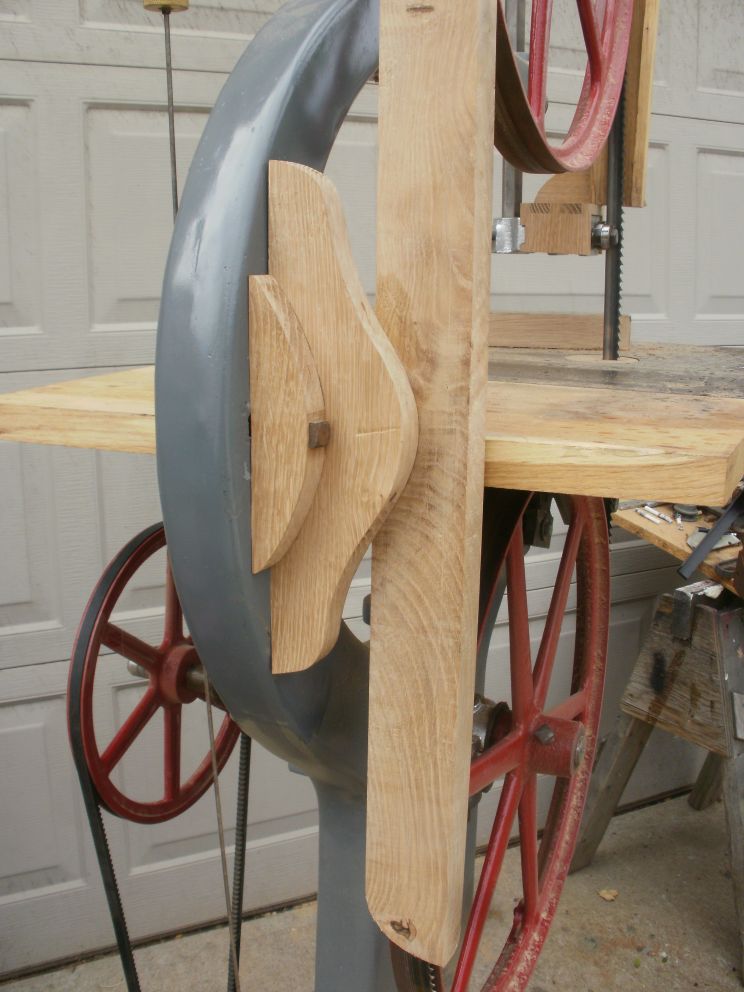

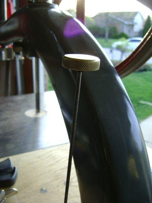

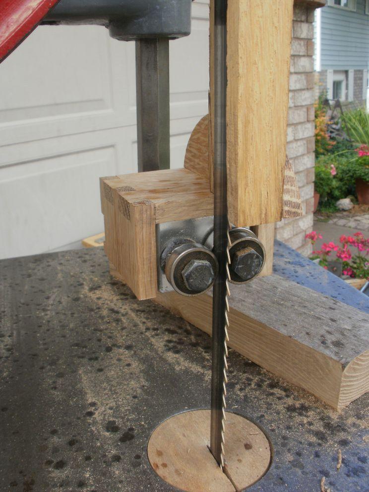

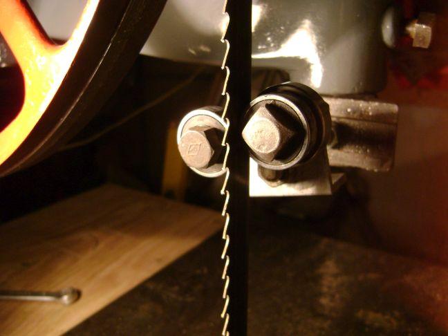

the bandsaw has also seen some changes.  added an auxiliary table, blade guard for the offside, and a mechanical remote for the motor mounted switch(steel rod and brass knob).  the single upper guide has been replaced with a much smaller version and the big ugly one is now under the table
I have lots of other pics, here's just a few, the guide shown was a prototype, a more elegant one is now installed

a new pic of the titanic, new old motor(ge cap start 1/2 hp), still some plumbing to do, pump and motor have been turned around, neat old guage repaired
the blue hose runs to the 8 gal portable screamer

Love the Cast Iron base on the Compressor.  More detail on this side of the compressor than the other side which the original posting picture showed.   Glad you're not taking a chance on the pressure vessel  Neat to keep it  as part of the compressor  It IS neat.
a couple of closeups, yeah neat old guage, broken lens but still neat

the latest up grades, nothing serious, just a couple of guards
in the last pic you can see the steel rod from the motor mounted switch, this rod ends with the brass knob shown earlier
it was a long restoration/rehab.  I brought this home last September, of course then winter arrived so no bondo/sanding inside for three months.  no mechanical problems to speak of, babbit was in good shape everywhere, fabbing the upper guide was easy, just lots of filing, filling and sanding
