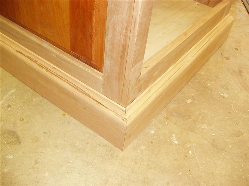

Caracas with face frame attached now ready for base of 2X4 lumber with covering of cherry with simple molded edge

Gerald, an A-1 project! Beside the obvious craftsmanship involved in this grand project, what caught my eye was your skilled clamping procedures, well done! I love the casters, that is one thing missing on big furniture, casters!
A couple questions, how did you attach the face frames, and, you watch the Walking Dead! I never would a thought! :)

The frames are glued at the corners using a rabbet joint, worked very well. and yes I do.
