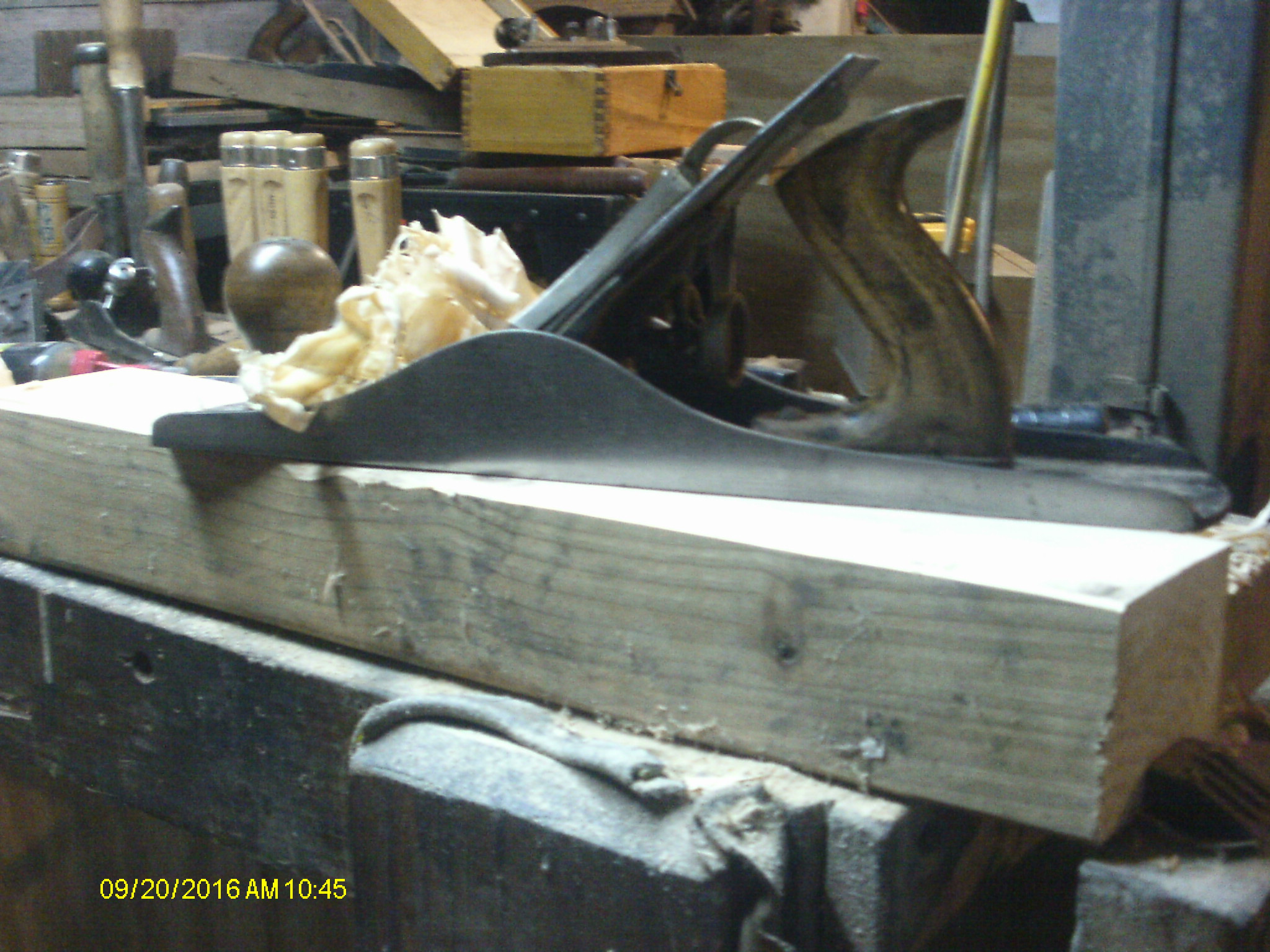

(BTW, in the first picture of how to set up a plane, the one in the background is a Stanley #5-1/2, T-17....)

Just for example of a Stanley No. 5-1/2....
The Type 17s had painted handles.  I hate painted handles, so I removed what was left.   much easier to use than the No.6c, T-10  I have....

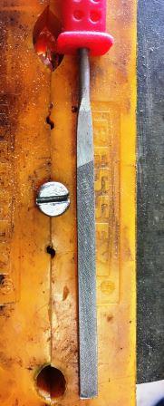

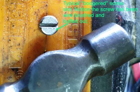

Inevitably, over the course of the plane’s life, the screw heads are going to get mauled by poor fitting screwdrivers. This is an example of a damaged slot.
The process here is to GENTLY move the deformed metal back into the original slot. I use a very small ball peen hammer and LIGHTLY tap the metal back towards the slot with both the ball and flat end. I work the edges of the slot until the raised metal is pushed down and into the slot itself.
When I am satisfied that I have gotten as much of the metal back to where it should be, I recut the slot with a needle file. This requires a gentle touch. You don’t want to enlarge the slot any more than you have to. You only want to square up the sides and make them parallel to each other. Once the slot is done, I use the same needle file to dress and re-contour the screw head as best as possible, to eliminate any raised remaining metal.
The screw then gets polished on the buffing wheels and coated with the paste wax.

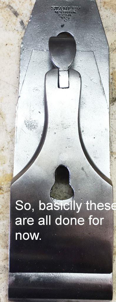

So, these components are done and ready to go!

Will this do, for now?
