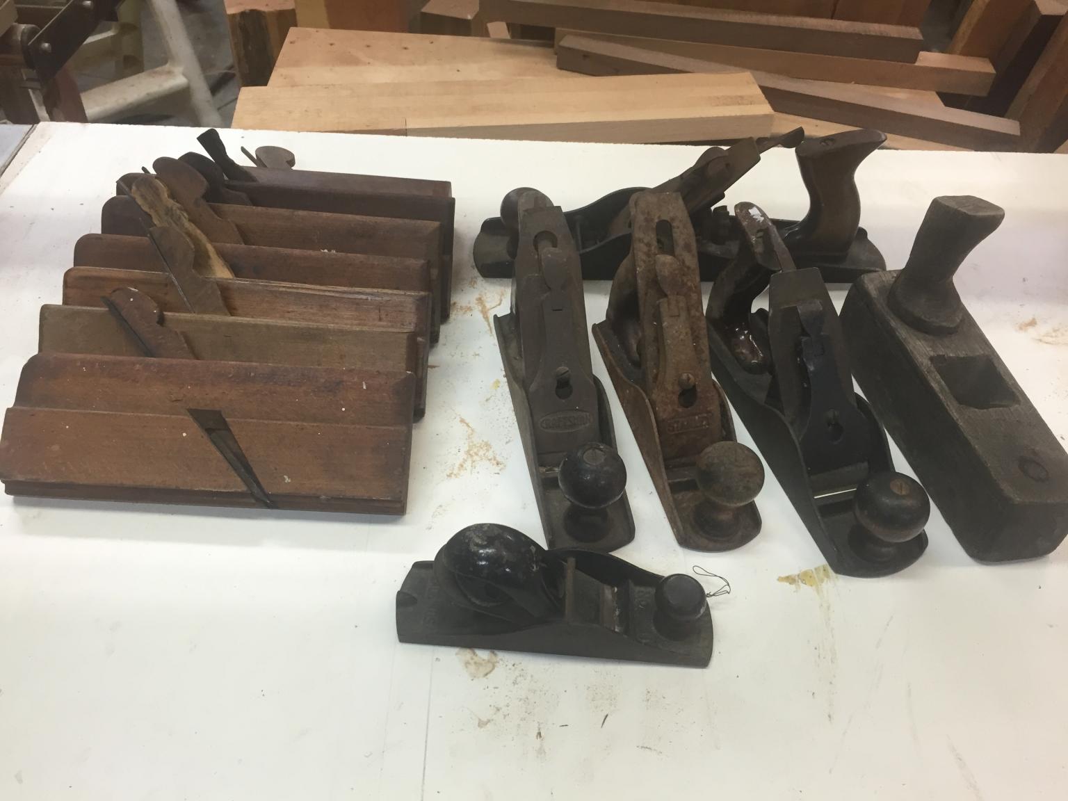

  3. I did a little picking and ran into this mess of planes. Got to wheeling and dealing and walked away with all of them. Most of the wooden planes are either Ohio Tool or Sandusky but one is from Sheffield, England. The metal planes are Craftsman, Fulton, Ohio Tool and a Stanley #3 Sweetheart era along with a Sweetheart era Stanley No. 110. Several are in pretty rough condition but I will start them in the Electrolysis bath and see if they clean up enough to make users of them. Patriot Picking.....
