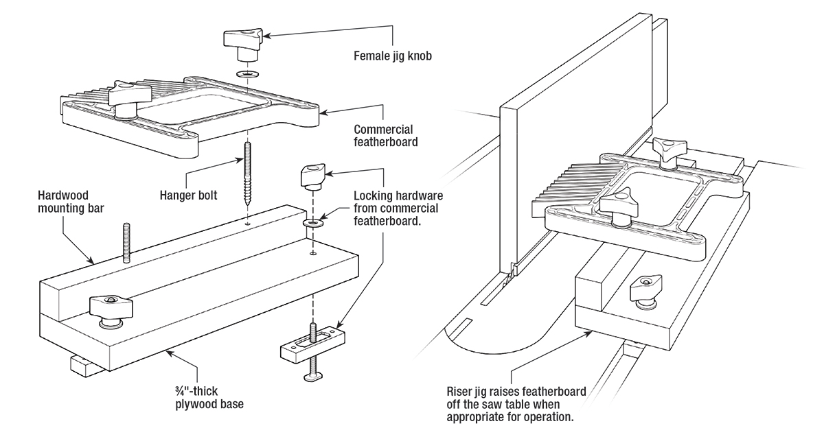

  3. A featherboard is great for controlling feed at the table saw, bandsaw, or router table, preventing kickback and keeping a workpiece firmly pressed against a fence for both safety and accuracy of cut. But there are times when a featherboard is best raised up off the table. For example, when rabbeting at the table saw, (Read more....)
