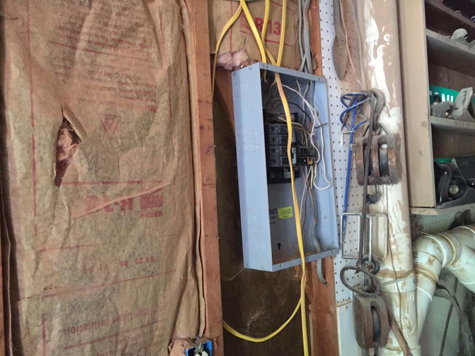

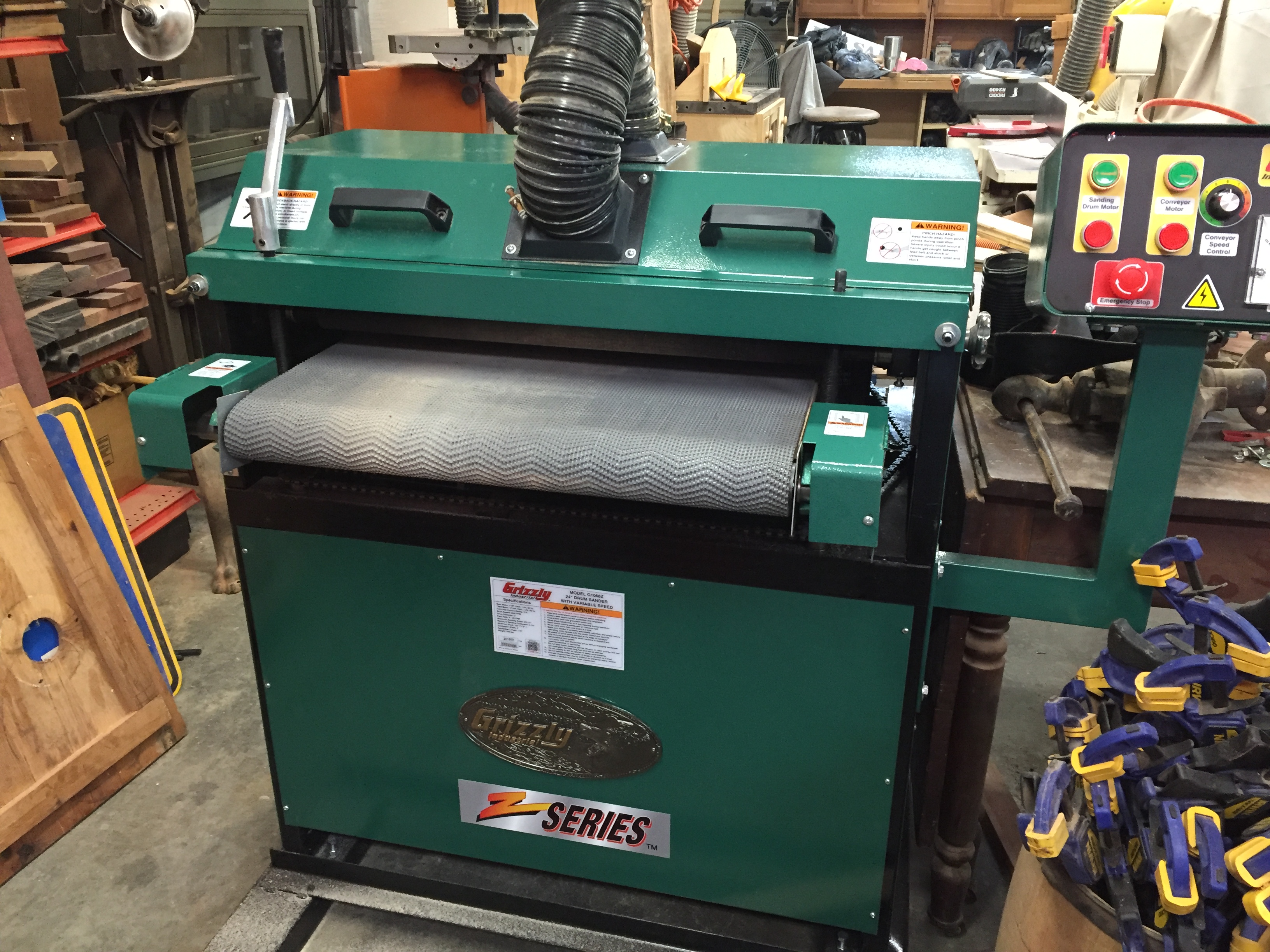

Is your electrical service properly grounded?
Gene Howe posted a topic in Machinery, Tools, Research, Reviews and Safety
So I now have the 24" Drumsander up and running. Wow does this thing really sand. I ran an end grain cutting board through yesterday that needed leveling up. Less than 5 minutes and this board was done. So so I got the old breaker box out and put in a new 100 amp box and ran a new line over to the sander. a a couple of more circuits and I can close up the wall. I will need to extend the power cord. It has an 8' cord on the machine but it needs to be about 12'. I'll work on that later. Got to get some projects out the door now. Thanks for your input Todd.
