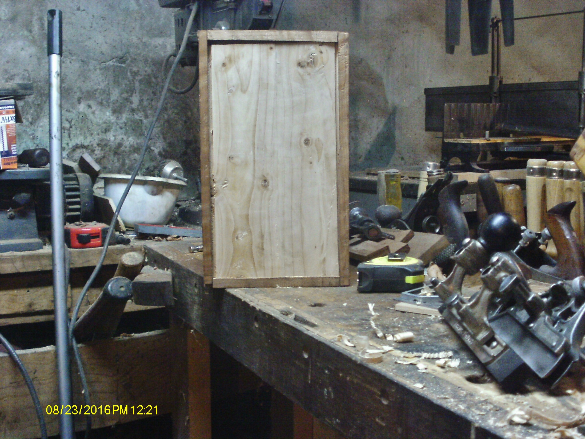

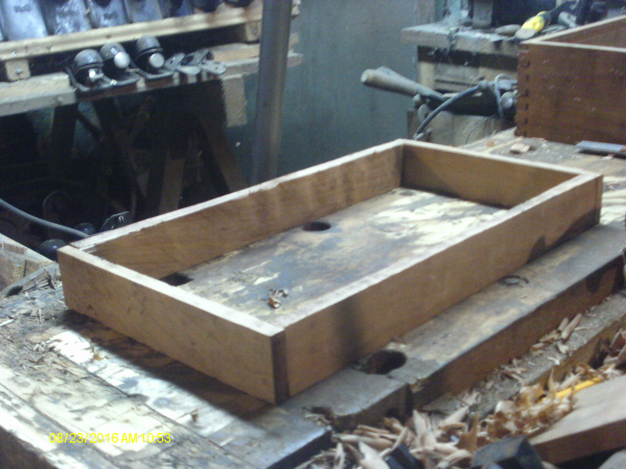

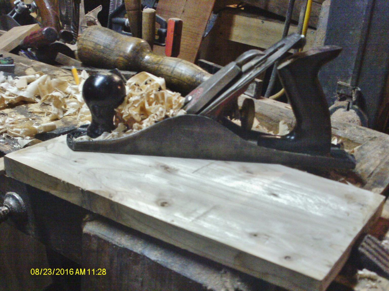

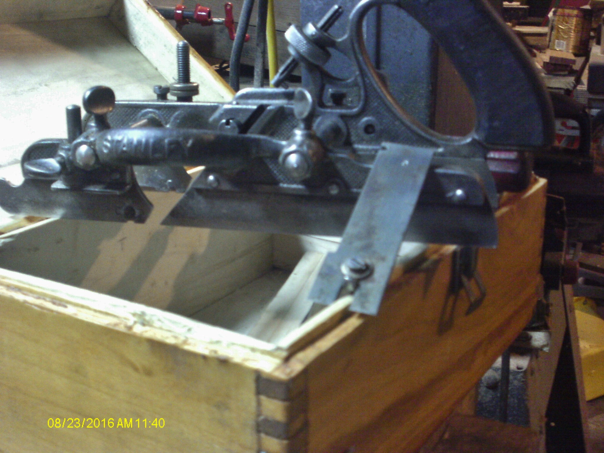

  2. In spite of itself. I had trimmed the lid parts.. Still ugly. Set this aside, for now. I took the pine panel out of the clamps, trimmed it to size, length wize needed squared, width was a 1/8" too wide. Laid the panel on the bench, and clamped it in place... Meh, still needs a bit more. Plane is a Stanley #4, Type 13. Iron even has the "SW" on it. Gave it a bit more work.. The other face was a bit worse. I used the Millers Falls #11 to flatten the face, before the #4 took over. There was one edge that was a bit wavy, though.. Since the #4 was handy, gave it a little extra work. Needed a straight edge for the next plane to work... I figured I could use this new cutter for the #45......wrong, this cutter does NOT fit MY plane. Sooo. I dug out a narrower cutter, 3/16" instead of the too wide 1/4" ones. At least the skates will sit where they need to be It will have to do....the 45 does NOT like knots being in the way,either.. meh...At least I can bury that spot... Test fitted. Due to the length of the panel, I won't need to do this sort of thing to the ends. Test fitted all four sides.. Leaves some room for expansion. Well, that will do for the 45, for now. Time to pack it away until needed again.. Have to wait until the Laundry is done, before I'm allowed to make any more messes.....Igor, clean up in Aisle #1!!!
