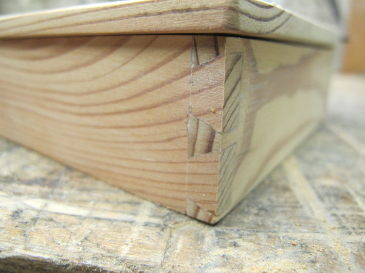

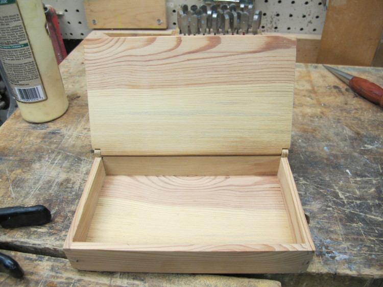

All of the dovetails are hand cut using a Japanese pull saw.

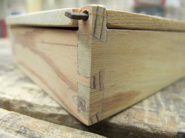

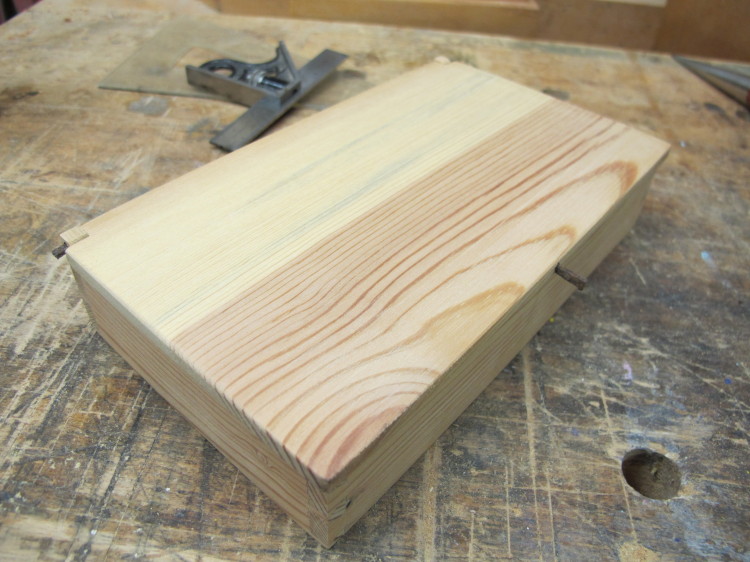

The above picture show one of the "hinges". I used tiny cut nails salvaged from the original structure placed into pre-drilled holes. Right now they are just finger tight.

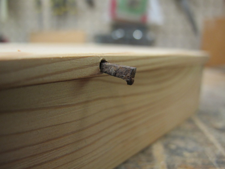

The lid lift is also a little nail. I think this one has to be in a little deeper. I hate it that the round hole shows on the front.

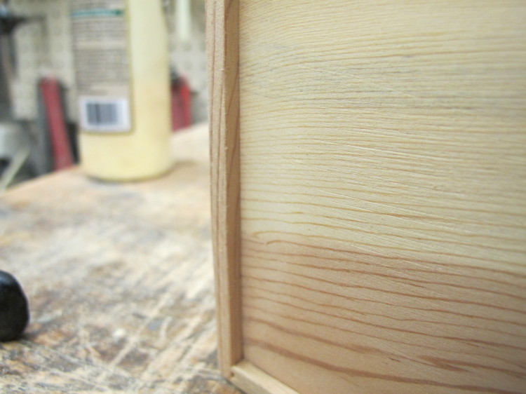

Although you can't tell from this picture, the bottom is thicker than the dado it fits into (bottom = 1/4" dado = 1/8"). About an inch of the perimeter is tapered to the edge allowing the fit.

I'm not sure what to do with the inside. Maybe a couple of "U" shaped risers to hold the pen off of the bottom. Covering the interior would make for a nice contrast but it almost seems sacrilege to hide the patina.

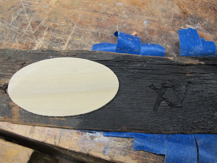

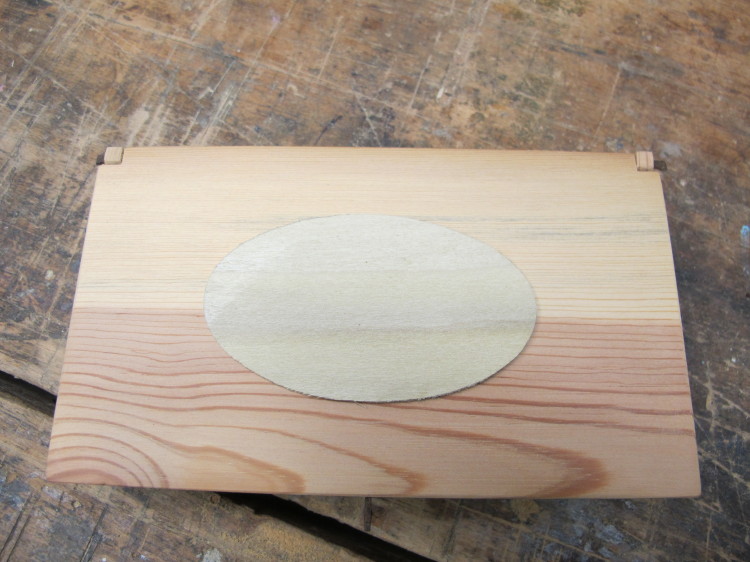

At this point, I am stumped on my next step. My original plan was to inlay a "Carpenter's Mark" in the outside of the top. I made an oval inlay pattern and cut a sample from some Poplar to see how it would look-
ning-oj-box-11-1810-99.jpg?width=750
I made certain I salvaged all of the carpenter's marks, before I made the pen blanks from the beam.
ning-oj-box-12-1810-48.jpg?width=750
Now, the problem. The pine is so brittle- even more so near the surface, that I fear the router inlay kit will splinter the the wood. To help strengthen the "mark", I covered the back of the piece with painters tape and saturated it with thin CA. I'll need to stop at Hobby Lobby tomorrow after school and pick up another bottle- thank goodness they send me 40% off coupons every week!

Hmm I can't help much with the nails etc. but I definitely would go with the U shaped risers.

Hey Lew, the hole for the nail handle, you are right, it is unsightly. Here is what I would do, create a wood dowel or plug of a contrasting color and plug the hole back up.
Then, file your nail shaft round only up to the point that the nail will stick out from the surface, so if you have an inch of nail buried in the lid, then just file that inch round.
Then drill a hole the same size as your round nail shaft and insert for a nice clean look.
Cool project Lew. I have a question. The hinge for the lid seems a bit vulnerable to me. Is that an optical illusion?

For the inlay, you could scribe around the oval. Less splintering that way. Or, cover the lid with masking tape before you rout.

Ron, VERY fragile. This box and pen probably will never actually get used other than for a display, so I've got my fingers crossed it will last. Another reason for opting for a sliding lid in the next one.
