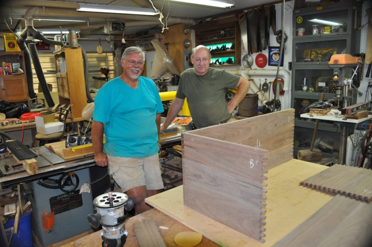

It took a lot more sanding than we planned on the panels as we got some bowing in the glue ups which cost us extra time over our short weekend together. But we finally got everything down to the right thicknesses and got the dovetails cut. Here are John and Ron as we were working on the dry fit.
ning-dsc-80061-779-75.jpg?width=750

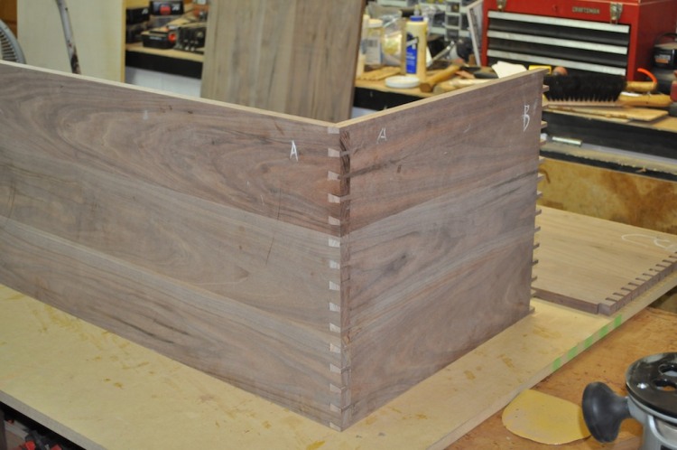

Those dovetails turned out great! John has the Dovetail Jig from Peachtree Woodworking and it was really easy to do.
ning-dsc-80091-779-33.jpg?width=750

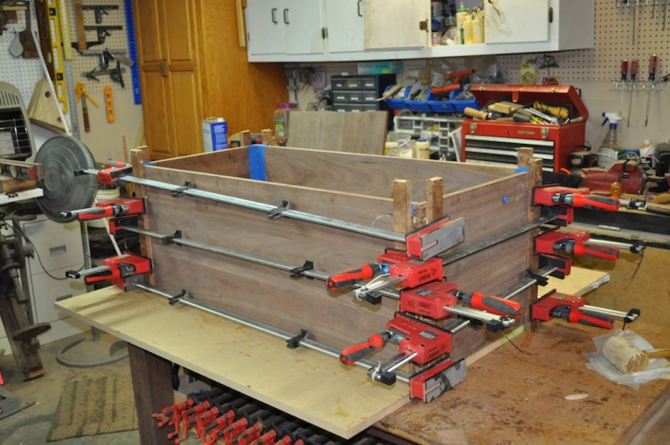

After getting the birch plywood bottom notched and fitted into the dadoes and making sure that it wall perfectly square, it was time to get it glued up. Taping the inside corners with the Blue Painter's Tape sure was a time/work saver to deal with the squeeze out during the clamping. I can't tell you how many times John told Ron and I during this build "Don't ask me how I know this, but we need to do/not do ___________ or it will mess up the chest." Since he has made quite a few blanket chests his experience and wisdom was great to have.
ning-dsc-80101-779-51.jpg?width=750

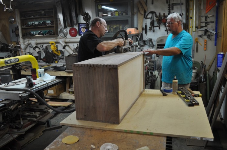

After letting the glue dry overnight, we got up early on Monday morning to get as much done as possible before Ron and I had to head back up north to Indiana. Ron got all the dovetail joints sanded down flush and they all look great! After getting the rough sanding done, we did the measurements and cut and routed the decorative edge on the top and then mounted the top using 3 of the Rockler chest hinges.
ning-dsc-80131-779-17.jpg?width=750
