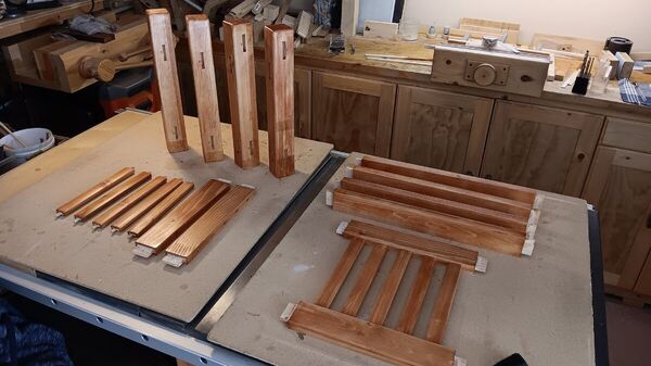

May 22May 22 Author Popular Post comment_376563 So this whole morning was spent applying a stain to all the parts. Next I'll be gluing up sub assemblies. Here's the stain I used:Thanks for looking!Stay tuned! More to come ...Cheers!MrRick Report
May 24May 24 Author Popular Post comment_376680 It's Sunday...The journey continues...Just got home from Church. Not alot of time today. All my parts that were shellacked last night were dry so I checked all the pieces for fit. Here all the completed parts now:There are a few imperfections here and there but everything looks pretty good and fits nicely.So I just finished gluing up all the Tambour stiles to their rail frames which make the smaller sides. When it's dry I will will interconnect them with the other rails. Here they are drying with the clamps.Stay tuned! More to come ...Cheers!MrRick Edited May 24May 24 by MrRick Report

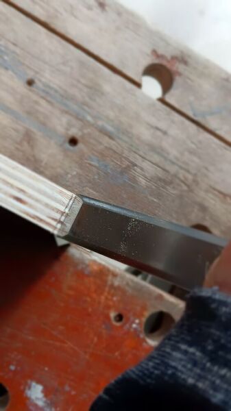

May 27May 27 Author Popular Post comment_376779 It's Wednesday, May 27th and the journey continues ......The sides are complete and now I've glued and assembled them with remaining rails.This is completed the assembly minus the cushion which is yet to come. Next I will make the cushioned top or seat. I make the backer board first.I begin by cutting out a piece of prefinished Baltic Birch 3/4" plywood.Next I need to cutout corner notches for it to follow around the legs. I begin by marking out the cut lines for each notch using my marking pen knife. BTW... this is the same knife that Paul Sellers uses in his wood working.I make knife walls with my chisel. This helps to cut straight when using my Lee Valley saw.Here's the cutting action using the 14 TPI saw...This is a look at the corners notches made:Next, I drill some 3/4" dia holes as shown. This allows compression and expansion of the seat foam when someone sits or places their legs on the cushion.Here's the completed backer board:I have to now run out and buy the foam and size it to this backer board. Then I can start the upholstery.Thanks for looking!Stay tuned! More to come ...Cheers!MrRick Edited May 27May 27 by MrRick Report

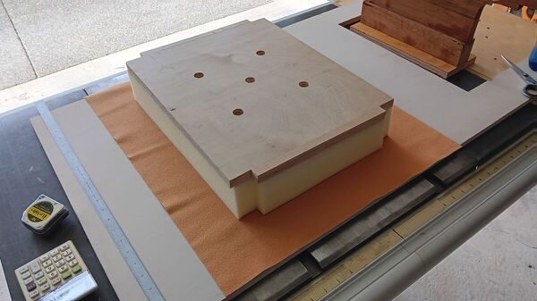

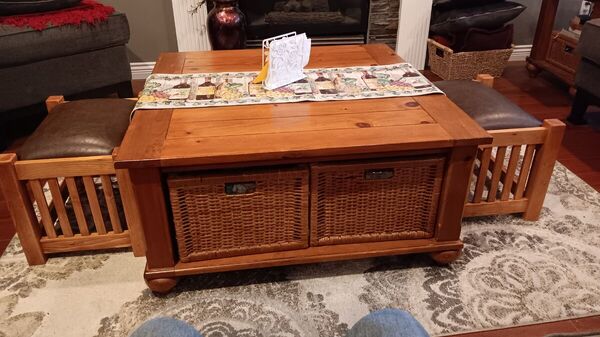

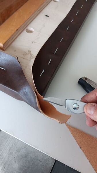

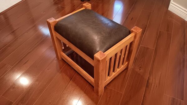

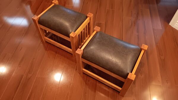

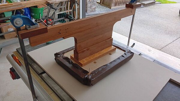

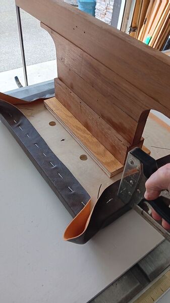

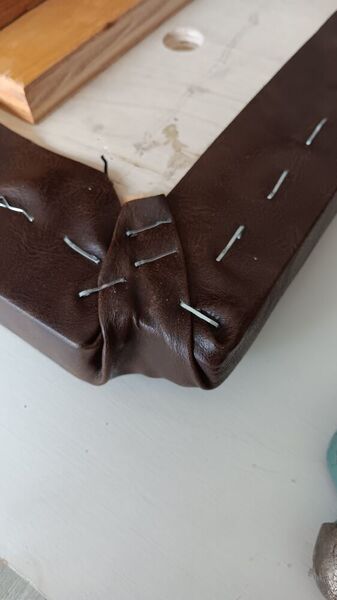

June 1Jun 1 Author Popular Post comment_376999 It's Sunday, May 31st and the journey continues ......So after church today around 1:30 pm, I started doing the upholstery.Laying out the Faux Leather with the foam and backer board as shown.I then applied my clamping jig on top of the backer board bottom as shown. Then the clamps are positioned and squeezed until the 3" foam is compressed to 1-1/2". The Faux Leather is then pulled, stretched, and stapled around the perimeter as shown.As I go around the perimeter, I use a "Cow Ears" technique for stretching the material into corners as shown here.I staple it into position. Finally the stretching and stapling is done as shown here.Here's the second footstool now completed.Here's the first one that I built and posted earlier and this new second one shown together. They are identical and beautiful. They turned out well.They sit on either side of my main living room coffee table as shown. Ready for use!!Thanks for patiently following and looking!Cheers!MrRick Edited June 1Jun 1 by MrRick Report
