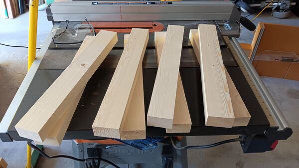

I went to Rona (similar to Home Depot) and found some real nice Pine. I bought some 2" x 3" x 8' and 1" x 6" x 8' for this project. Here it is just being unloaded from my jeep.

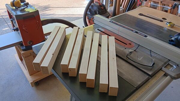

I unwrapped the lumber and set up my saw to start making the Legs first. The finished size will be 2" x 2" x 14-1/2".
I cut two lengths of the 2 x 3s a little longer then 14-1/2" long and will trim to final size later. I cut 4 sets and then will laminating them.

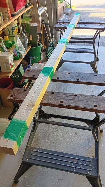

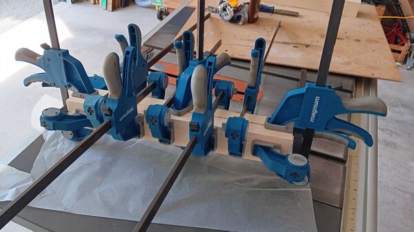

Normally I use Titebond III wood glue but gave Titebond's Hide glue a chance. I wanted to check the strength. Apparently Titebond Liquid Hide Glue (3,591 PSI) is generally considered very strong but slightly less strong than Titebond III (4,000 PSI). However for laminating I believe it should be okay.
I took all the sets and spread hide glue on them and clamped them up.

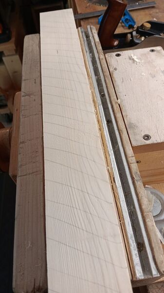

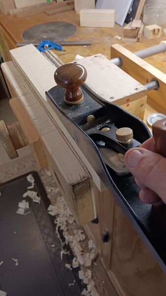

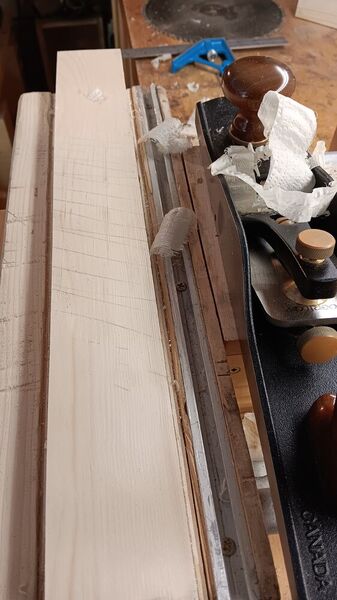

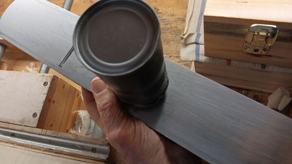

After marking up, I remove some surface all around and full length on each leg. I get it get close to the 2" x 2" finish size so I can hand plane to finish. Here I'm oiling the bottom of my Veritas Low Angle Jack Plane in preparation.

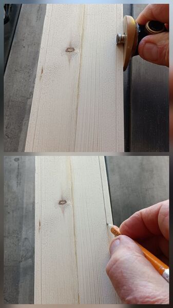

I then lightly place pencil lines on each side of the legs surface so I can see my planing progress.
Then I start my planing.....
Placing pencil lines on the surface is a very useful technique when hand planing. You can see exactly where you have missed when planing and/or where the surface is lower in that area. It's a good way to monitor your planing work.

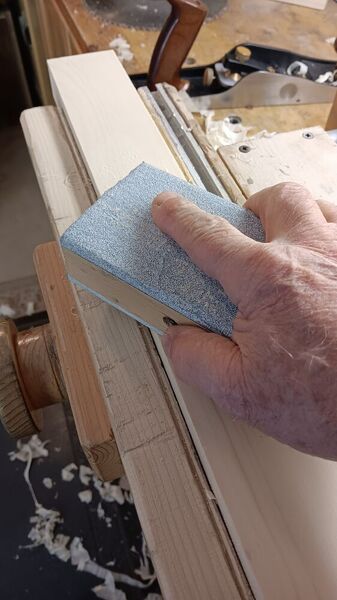

When planing adjacent surfaces leave a beautiful sharp corner. However they can be fragile and susceptible to light ding marks so I make a quick light pass on the corner edge with 220 grit sandpaper. It still looks sharp afterwards but not as fragile.

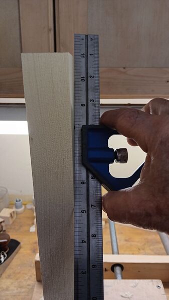

Here I'm checking for flatness and squareness all around on each leg. I'm holding it up to a florescent light behind it while checking. They are looking nice!

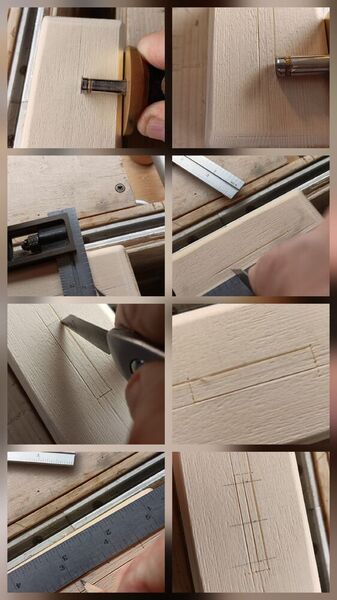

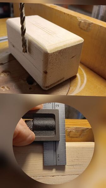

I start by laying out and marking up each mortise using my Veritas Micro-Adjust Wheel Marking Gauge They will be 1/4" wide. Then I lightly go over with a pencil.
My tenons will be 1/4" wide x 3/4" long. I make the width a tad bigger to pare down to fit the mortise.

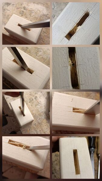

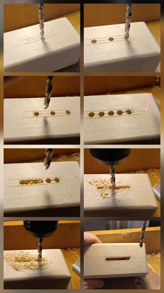

Now I move to the drill press to start hogging out the meat of each mortise.
Here I set up a scribe line on the side of the leg that is a wee bit deeper than the 3/4" tenon depth.
I chuck up a 3/16" Brad point bit in my drill press and set the depth to match this mark. I use a slightly smaller bit then the finished size I want so I can sneak up on acheiving the final width by chisel paring.
Here the drilling begins....
Then I remove the rest with my mortise and bevel edged chisels.

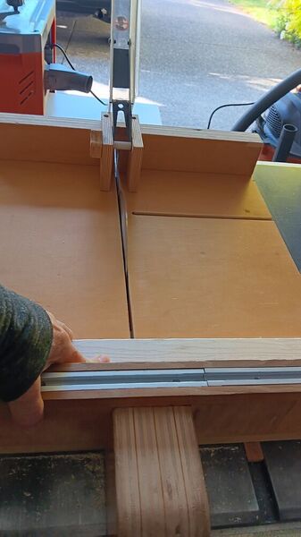

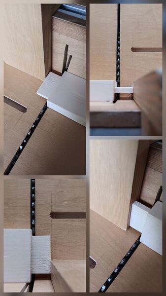

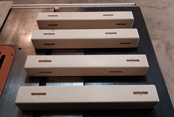

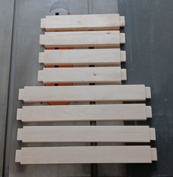

Next I cut all the rails and made the tenons. The last footstool that I made I did it with all hand tools. This time I set up a stop block on my tablesaw sled and made the tenons. They are slightly larger than 1/4" and will be "fitted" to each mortise by paring. Here a quick view of the process:

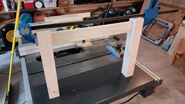

Here's a test fit:
I'm happy. It's looking good!
Here's all of them done:
