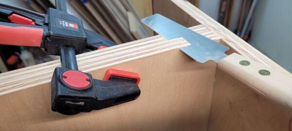

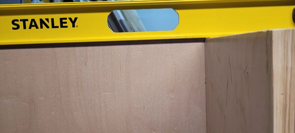

Scored the ply (good tip!). Feared tearout with power tools (and don't own a belt sander). It wasn't much material to remove after I checked with a straight edge so clamped on a support piece and used a flush trim hand saw on the end where there was about a 1/16 and then switched to a little hand plane (as I now see Mr. Rick suggested). Now, back to level.

Great save Barbara. Ya' just upped your handtool score. Well done.

I actually said to my husband that Mr. Rick would be proud of me for attempting the fix with handtools (please take that as a compliment @MrRick as all the hand tools that you make are quite inspiring!).

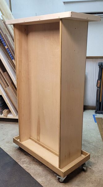

End of day, the top "tray" is done, other than adding a couple coats of finish and actually attaching to the rack. Plan to add a holder for a roll of brown paper plus some other items that I want handy during assembly and glue-up. Just set the tray on top for a quick picture.
