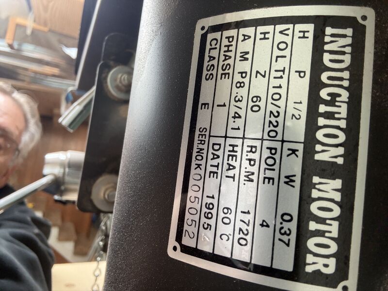

That drill press looks suspiciously like my Bridgewood table top and is virtually the same as the Grizzly of that time. This is the motor on mine-
It doesn't look like the frame size of the motor is on the label and I couldn't find it in the owner's manual. If you knew the frame size finding a replacement would be easy...adn i agree Lew's motor (also without a frame size) might be a match. You could measure the motor (shaft size, footprint, and shaft height) and find it on a chart (maybe) then go from there.
Therein lies the problem, Fred.  This is a 48 frame motor (1/2 hp) with a keyed shaft and a ball bearings. Most are sleeve bearings and 1/3rd hp.  I can buy a new press for about the same price as a motor.
