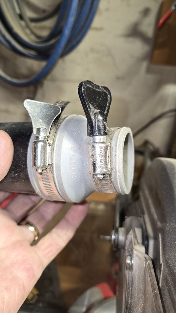

I use rubber drain pipe reducers with hose clamps for adapting vacuums to tools.  They work great and can be found in the local HD plumbing isle.

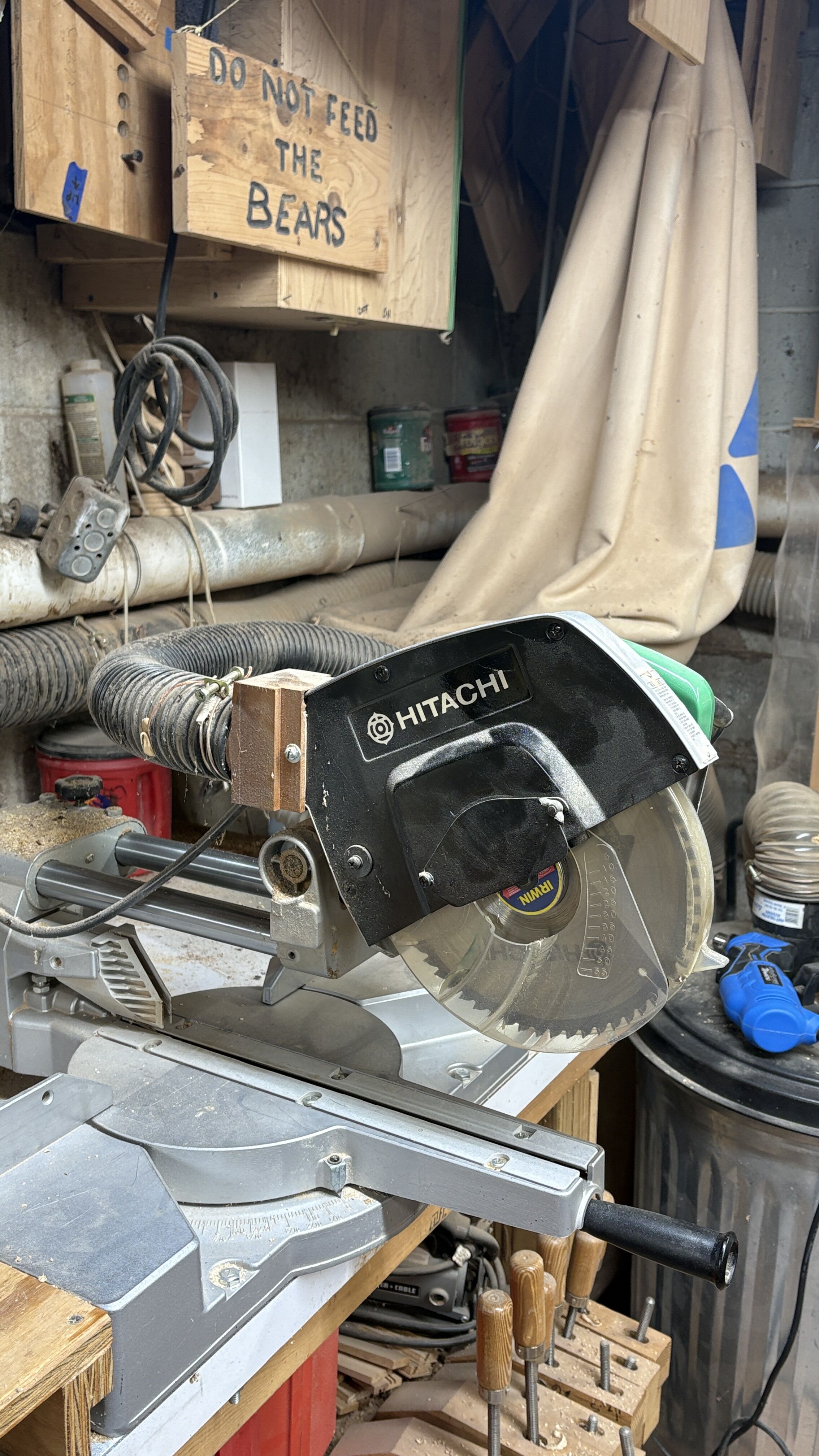

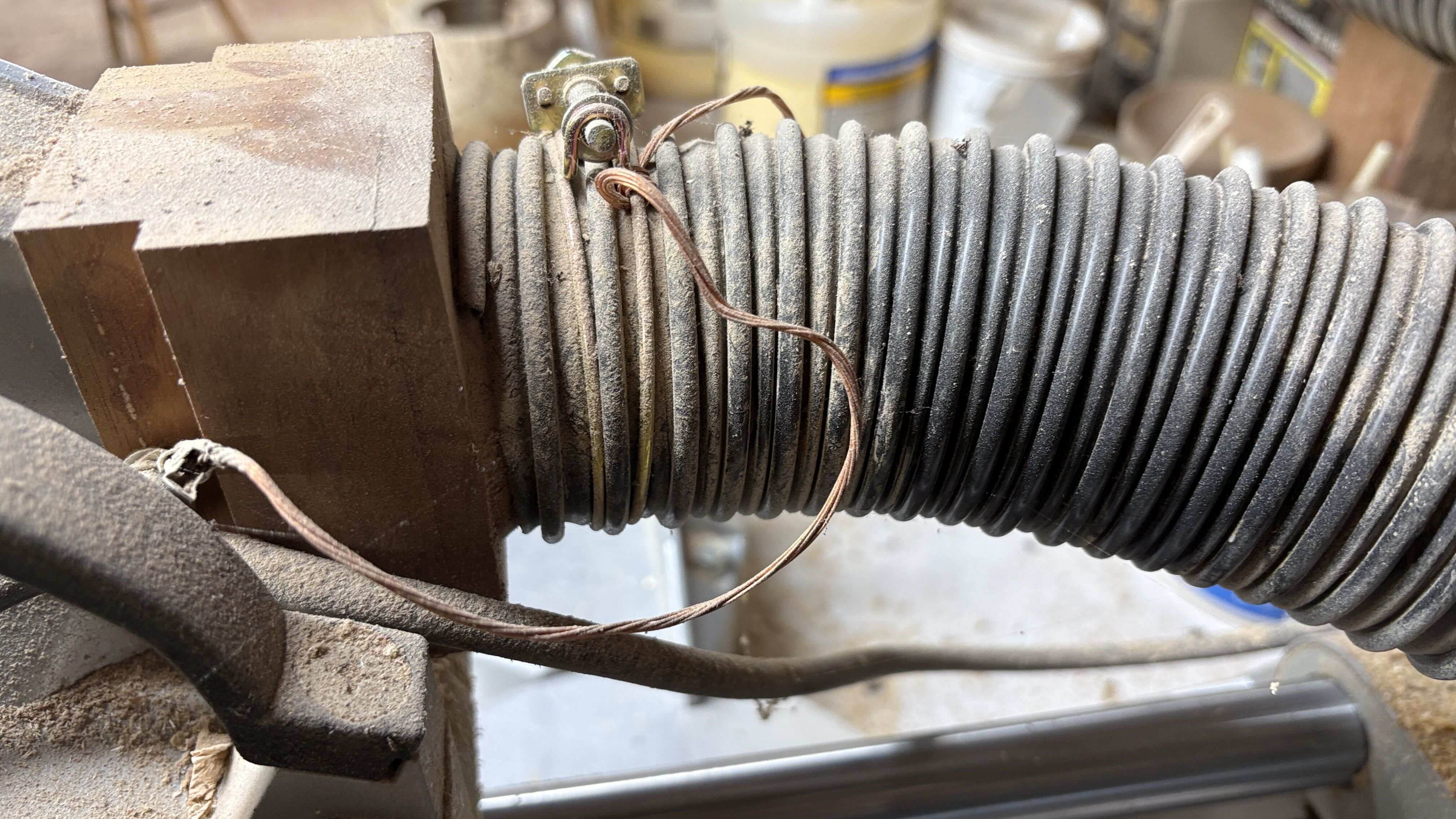

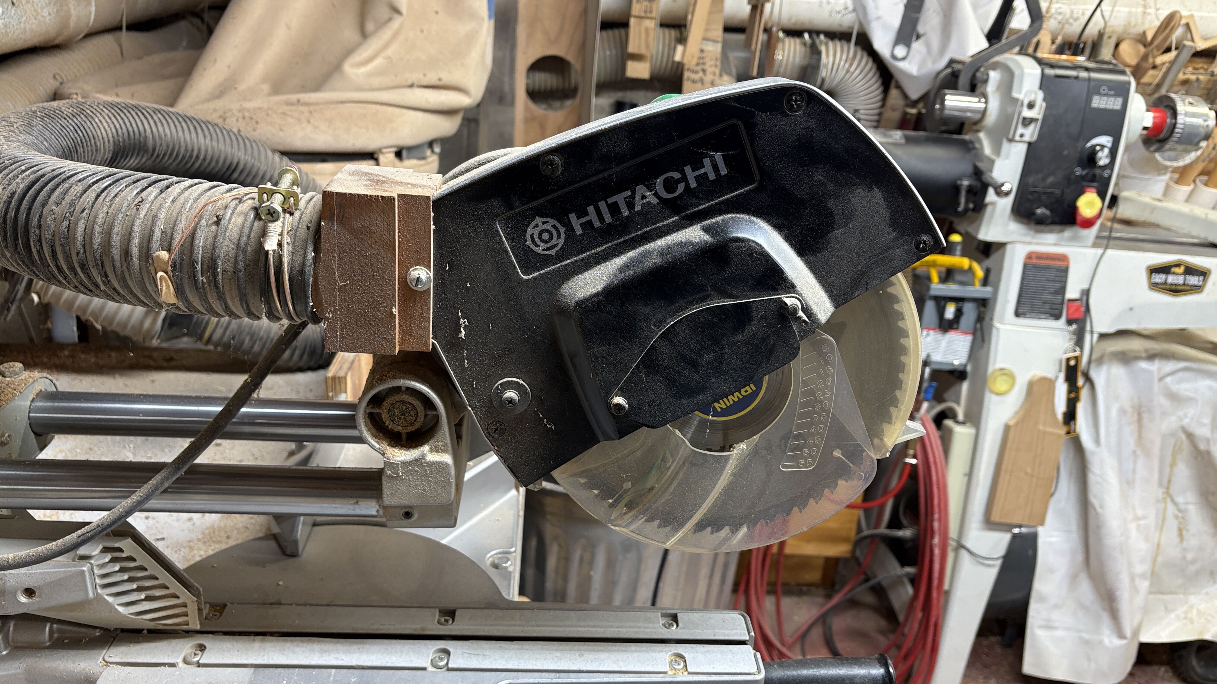

I have the very early Hitachi Slider. I'll take some pictures of what I made. May give you some ideas.
That would be great. This is the one I have. 20260113_110637.thumb.jpg.ed35883f3edecb6e4c6a9b2cdc60e17d.jpg
@BB1
Your saw puts my little one to shame! Don't think my garage engineered solution will help, but-
Mine does work, when I remember to turn on the dust collector...

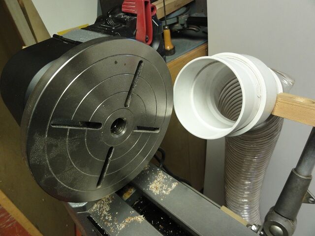

Having a lathe makes it easier to adapt fittings for use.  I've turned quite a few PVC pipes and fittings for use on my system.
Truth!!!

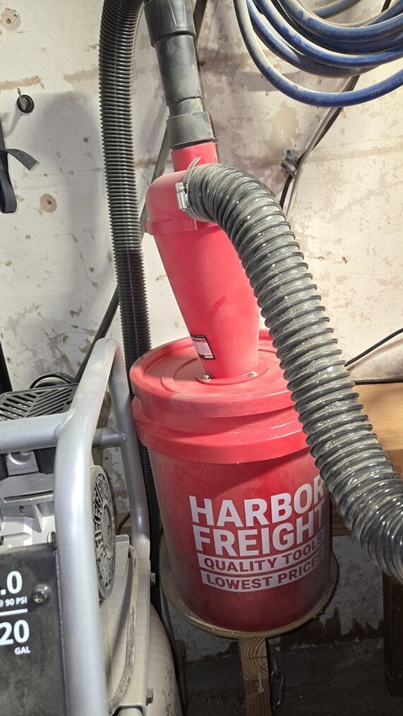

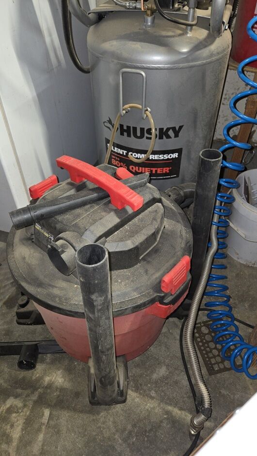

@BB1 here is what I did for dust collection for my miter saw. Like you I watched a lot of YouTube videos and came up with this.
I started with ha Harbor Freight shop vac.
I connected the shop vac to a HF cyclone dust separator attached to a 5 gal. bucket.
I highly recommend the separator, it puts most of the dust in the separator and saves having to clean the shop vac filter every time you turn around. Then the separator is connected to the miter saw dust port using one of the plumbing reducers someone else mentioned.
I use these butterfly hose clamps I got off Amazon because it males it easy to move the dust hose to my band saw and belt/disk sander on a cart next to the miter saw. With a heat gun and PVC pipe or fittings you can make just about any adaptor you need (YouTube it).

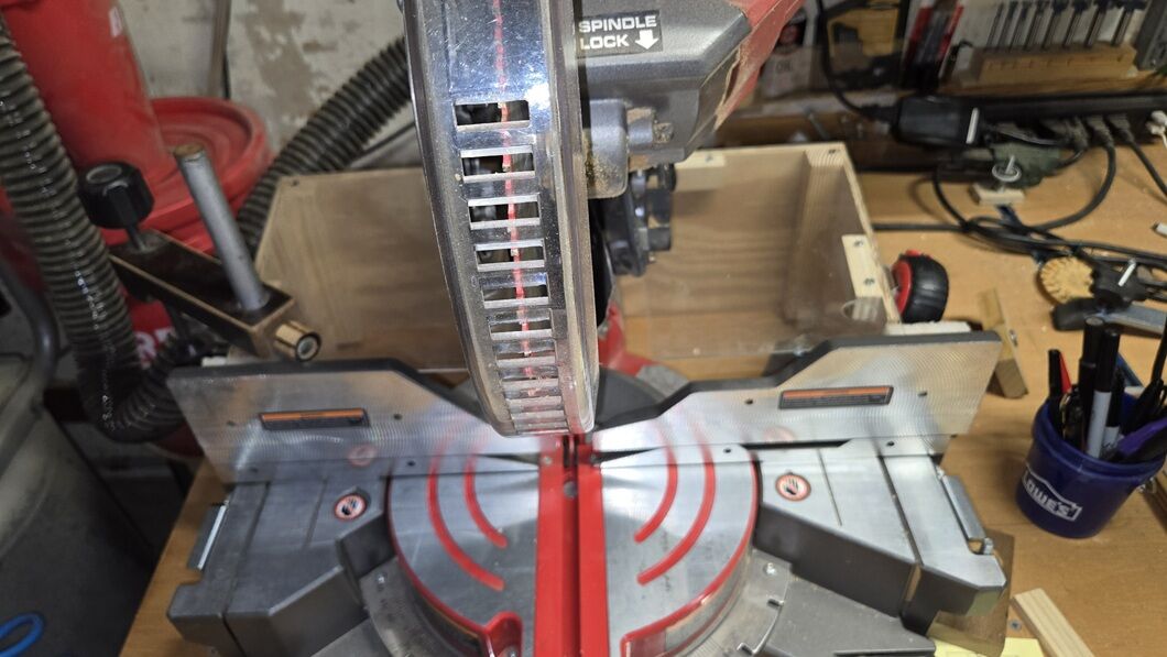

I also built a box at the base of the miter saw that catches a lot of the dust that doesn't make it into the miter dust port. The top of the box is plexiglass so I can see when I need to vacuum the box out.
I built the box in two pieces with a magnetic latch at the back. This makes the box easy to move when I need to rotate the saw for angle cuts.
I have this helps
