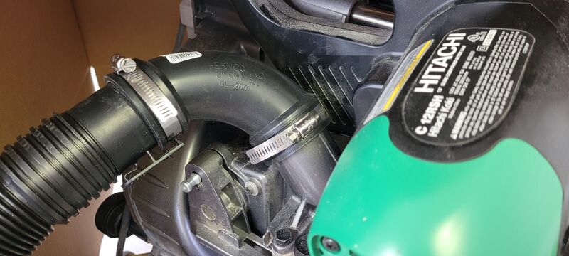

Miter saw dust "control"
After a bit of searching, found a fitting that works on the "dust port" of my miter saw. Much thanks for all the recommendations and pictures provided.
Unfortunately, even with my large Ridgid shop vac, still a lot of dust is escaping. Will need to get the box built and make a connection to my dust collector. Hopefully the combo of vacuum on the port and dust collector for the box will help address the distribution of dust.

I have a Hitachi miter saw (one of my first tools!) and need to get better control over the dust generated.
I've just been using the bag on the port (actually fills) and vacuum up the spray of dust. With my incoming minisplit I want/need to do better.
First I looked at hooking up the vacuum to the dust port. If course nothing in my box of fittings is a match. Will need to see what I can find.
In the mean time, I started on building a box to contain the saw. I'll have removable front panels so I can vacuum inside. Have watched a bunch of YouTube and am trying to merge all of those into a workable solution.
Open to any suggestions or recommendations as I move forward. Thanks!

So I've added the connection to my dust collector at the back.
And built the box around the saw.
I also have a shop vac (with cyclone) on the miter saw port. Still wasn't capturing all that I hoped as the rubber "funnel" piece that is around the opening by the blade is limited im size so I added some gorilla tape (stuck it to itself) to extend the shoot after seeing a similar idea on YouTube (haha...so many ideas out there!). Really seems to help and is pliable enough so far to not hang up on the fence.
There are two kinds of "dust producers": confined and open. The confined ones (eg, a table saw or planer) work well with a tool connection/port to a DC/shop vac. Open tools (miter saw, lathe) are REALLY hard to clean up with just a tool port, and these benefit from physical isolation and containment. (And yes, there are some in between: band saw comes to mind.)

I agree. Trying to hit this with multiple "solutions" (none of which really are) - vac on the port, box to contain, and dust collector to help clear the air. Together its better than I had before!

@BB1 At one point I had a dust extension similar to the one you made out of Gorilla tape except I made mine out of plastic I cut from a two pound Folgers coffee can.
In dust control, "nothing exceeds like excess". To get decent capture, you need an air velocity of about 100 feet per minute across the tool space barrier/perimeter. An unconfined miter saw has a rough tool space perimeter surface of maybe 10 square feet. My plastic enclosure probably has an effective perimeter of 2~3 square feet. Multiply 100 fpm times square feet and you get cubic feet per minute ("CFM"). So, an unenclosed miter saw would need about 1,000 CFM; some kind of enclosure/shroud might only need 250. The typical shop vac produces 100~200* cfm, and a typical small dust collector might be 400* cfm. A 4" duct will support about 350 cfm. *The manufacturer will list the fan at about twice the "real" air flow (eg, in your shop, with hose, etc). Fans are rated with rather minimal resistance, so the official "test air flow" is considerably larger than a typical real world app.
