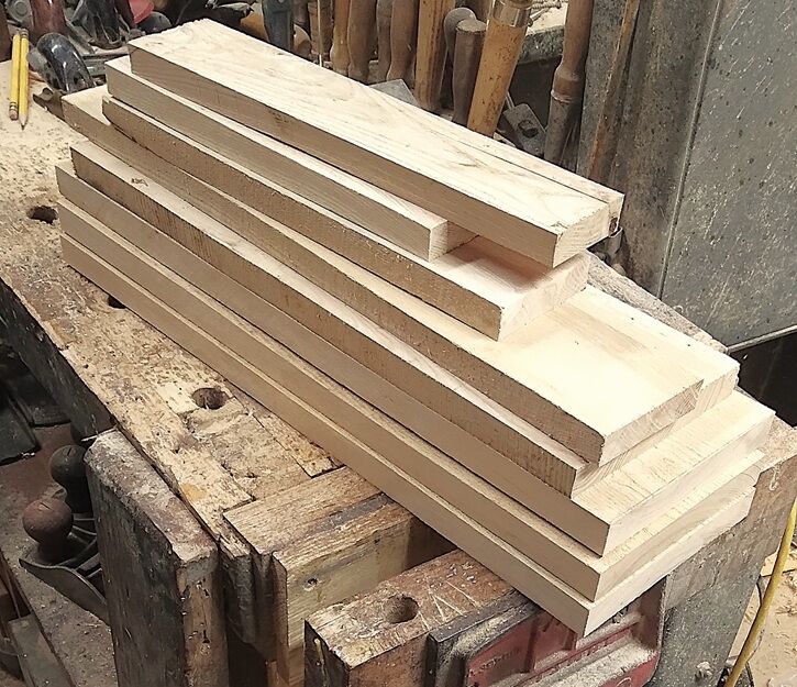

steven newman Posted Sunday at 03:08 PM Report Posted Sunday at 03:08 PM Have a stack of boards left over from the Last Projects... This will be how I sorted through the mess...and built a Shaker Style Table... Stay tuned.. 4DThinker, Grandpadave52 and lew 3 Quote

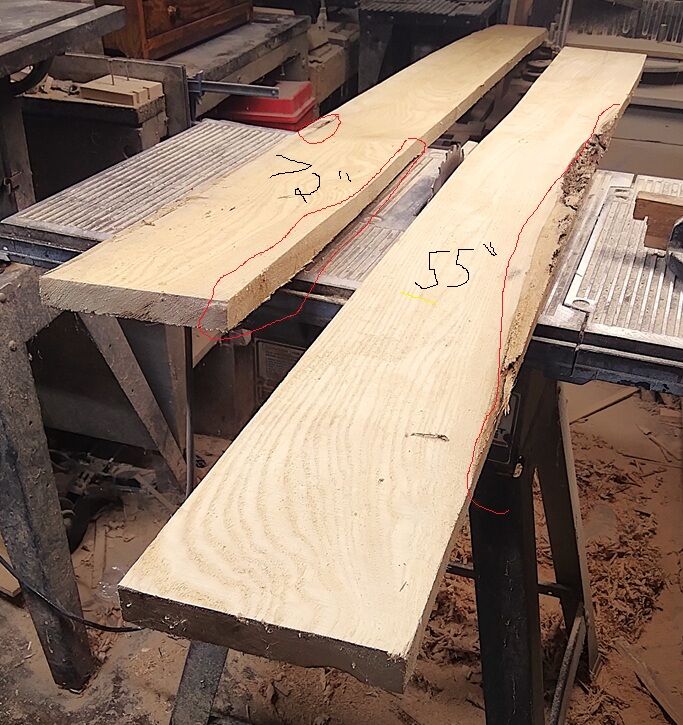

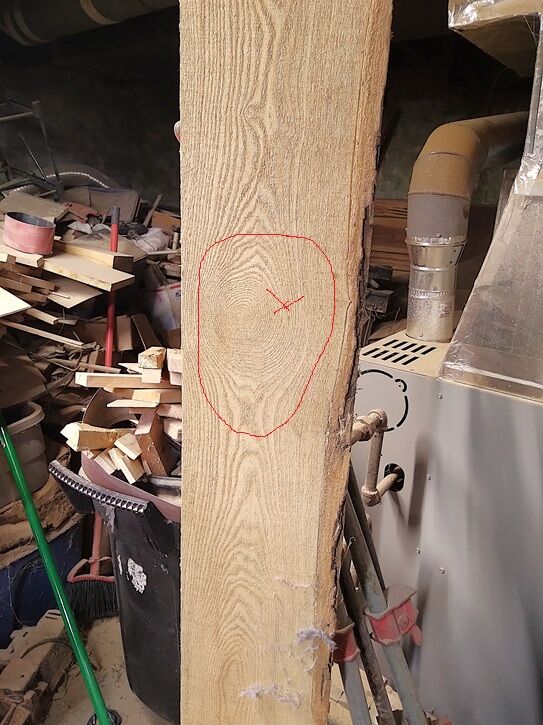

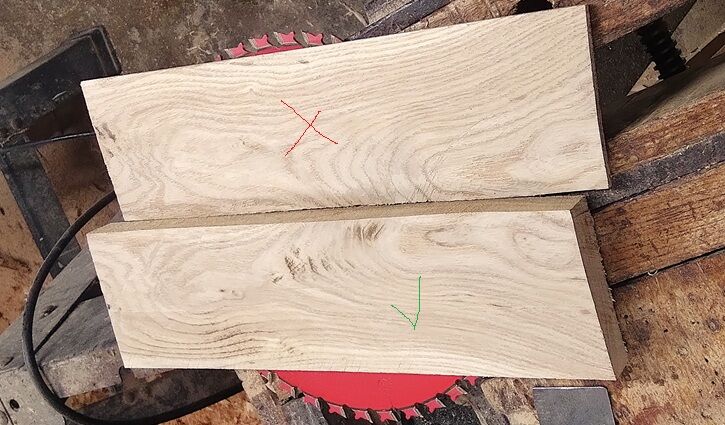

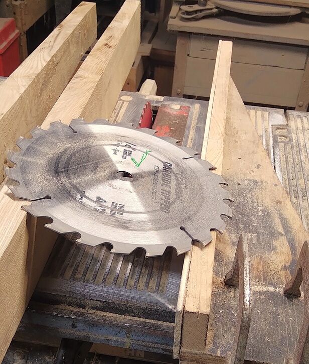

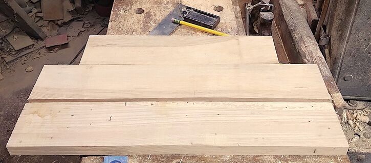

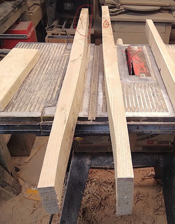

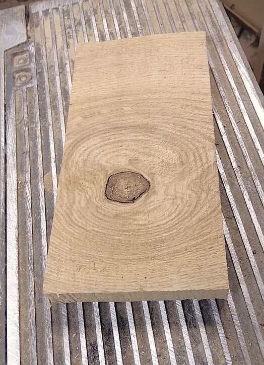

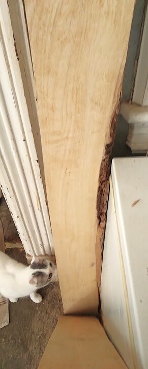

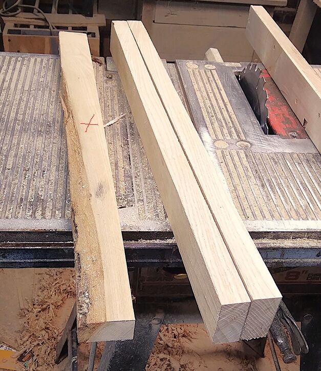

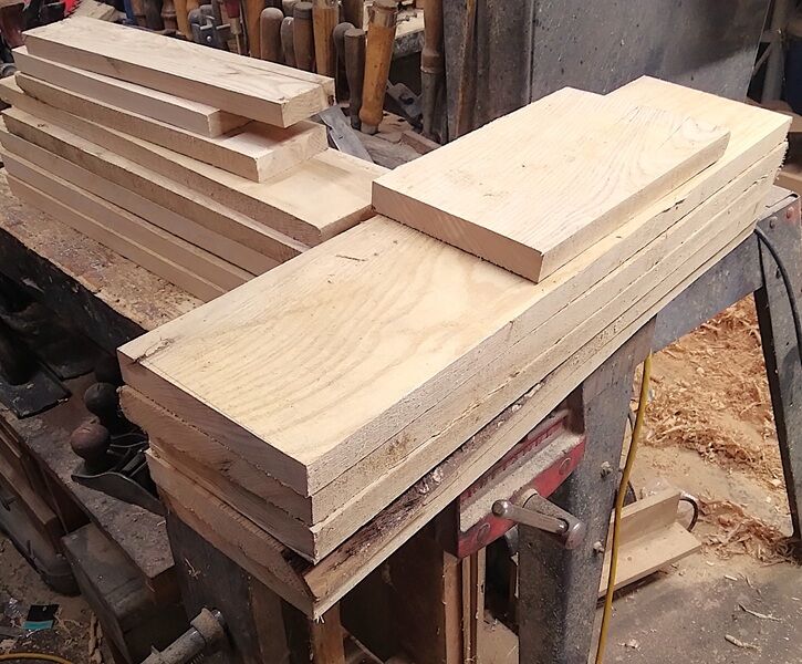

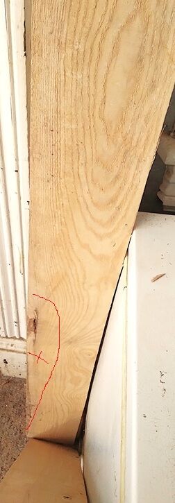

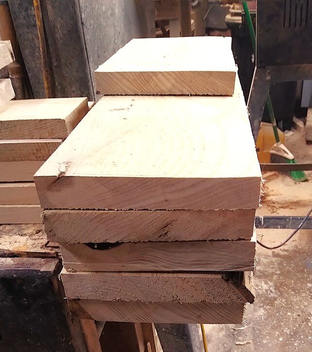

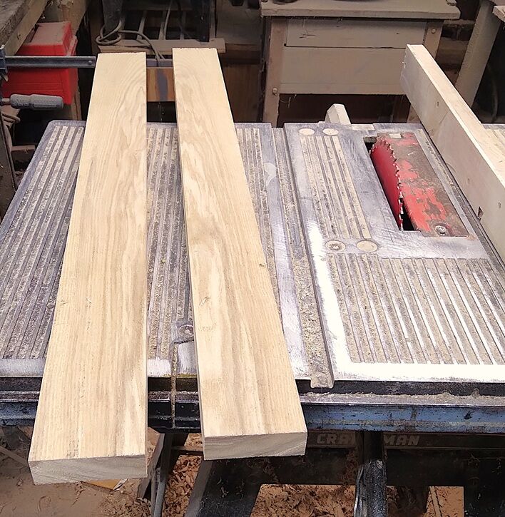

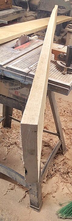

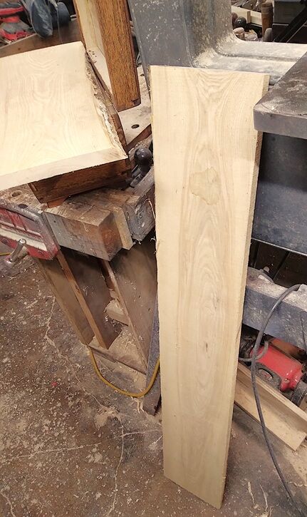

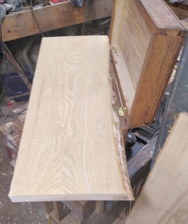

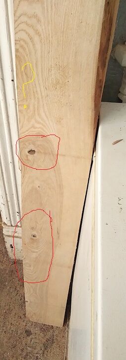

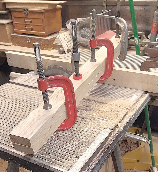

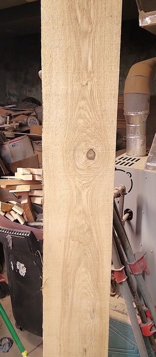

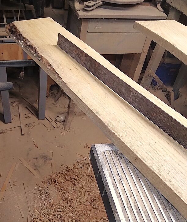

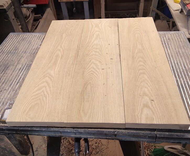

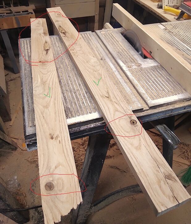

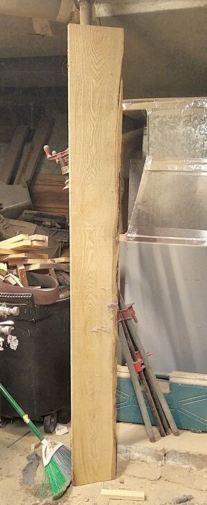

steven newman Posted Monday at 02:13 PM Author Report Posted Monday at 02:13 PM Ok..1st 2 planks? And #2.. Had a lot of "Issues" Plank #3 was a little bit better... First 2, were ripped down to get rid of all the splits.. What was left...#3 planks 3 pieces are at the bottom of the stack, then I also found a 1 x 6 in the leftovers stack..The rest came from the splitsville Duo.. There was this other Leftover.. After a few rip cuts.. I removed the barky stuff, and, because there was a big cup going down the center..it became these two... #4 Plank....had a Beer Belly.. I used that short cut off to set the fence for a resaw.. They are sitting on the Cross cut blade, because I needed this one installed.. Set the fence to a strong 3/4" and run the 2 "Fat Boys" through.. Not great, cut out the better stuff, burn the rest..which left this one IN the shop... 68" long, 1 x 8...there was one issue, other than the barky edges Was what was in this "Bullseye" feature... Should have known,,,well, two cross cuts later.. "Exit, Stage Right!" As Snagglepuss used to say... Left this And this.. Hmmm..trimmed the barky off.. Hmmm maybe IF I make another cut or 2... Maybe a Table Top? Last 2 planks... Hmmmm.. Hmm.. Well... I'll need blanks about 20" long for the legs ...so.. Stay tuned... Grandpadave52, Gerald, 4DThinker and 1 other 3 1 Quote

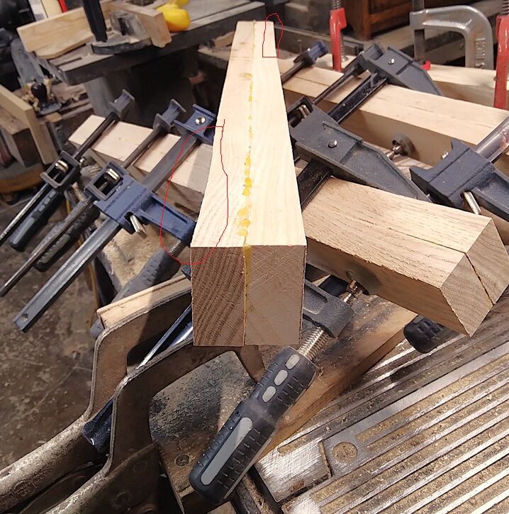

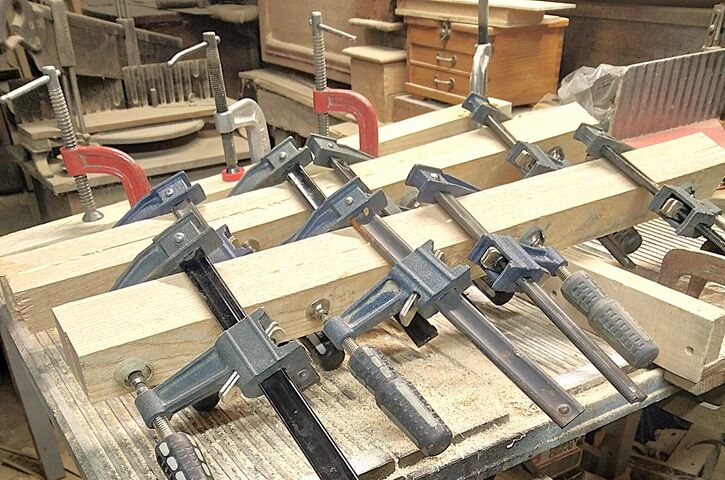

Popular Post steven newman Posted Monday at 02:26 PM Author Popular Post Report Posted Monday at 02:26 PM Ok..suppose I needed legs for a Table..a 3/4 by 1-1/2 leg won't work all that well...but, IF I double it up... So.. I take this mess, rip them down into strips.. Remove the barky parts Some didn't turn out too bad...had to work around a few things.. And, some had issues with NOT being consistent in thickness, so.. Some I had to plane the high spots on both faces..others I simply tablesawed the fat parts off to 3/4" thick.. Next...Glue and clamps.. 1st "leg blank" .. Then, 2 more...the 4th one? Always seems to be "The One"... We have ways... That needed a little extra pressure... Let these sit a day or so... Stay tuned... DuckSoup, 4DThinker, Grandpadave52 and 2 others 4 1 Quote

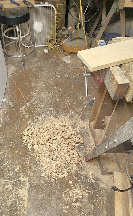

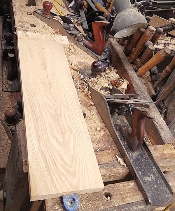

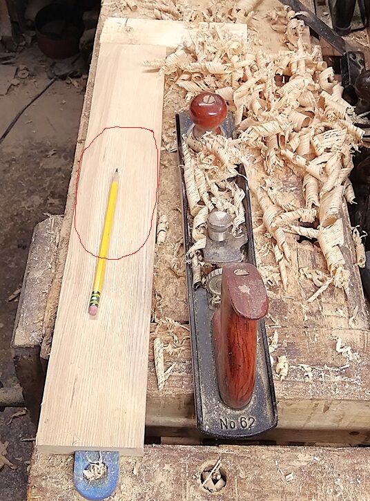

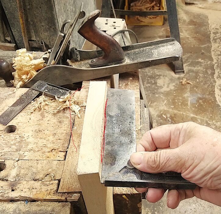

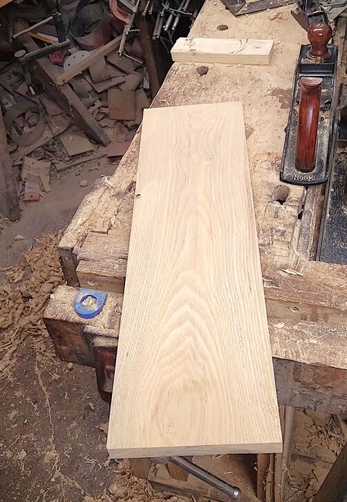

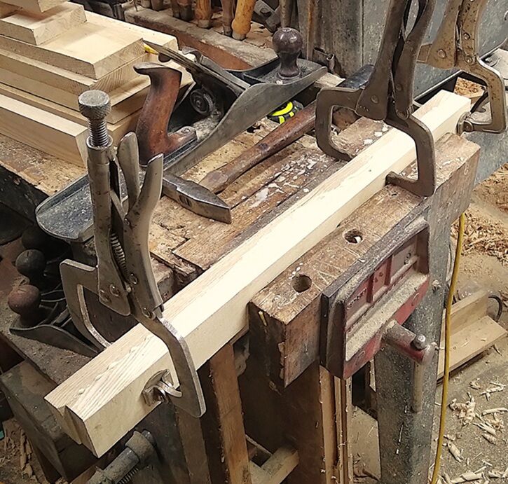

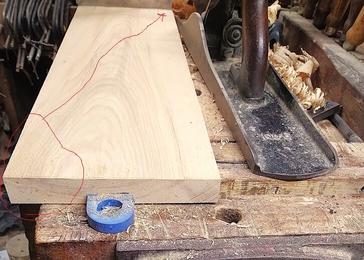

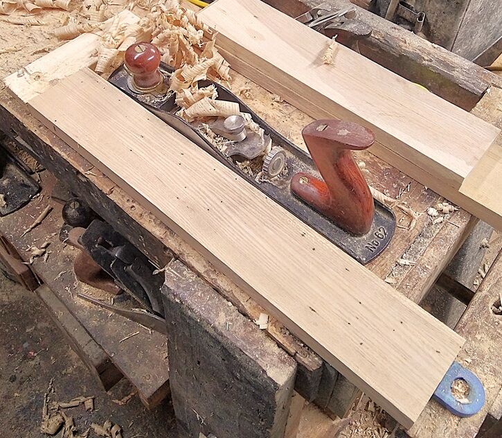

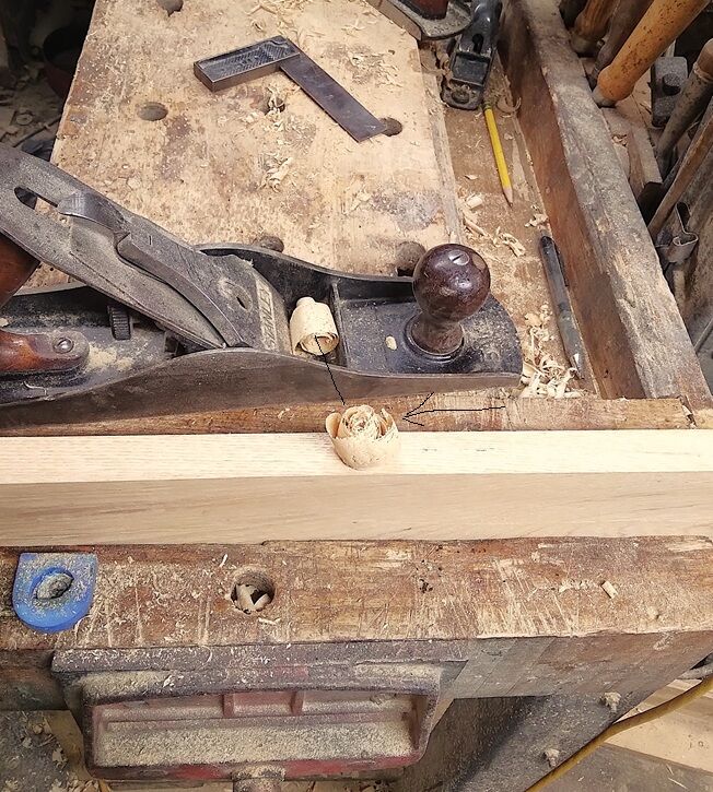

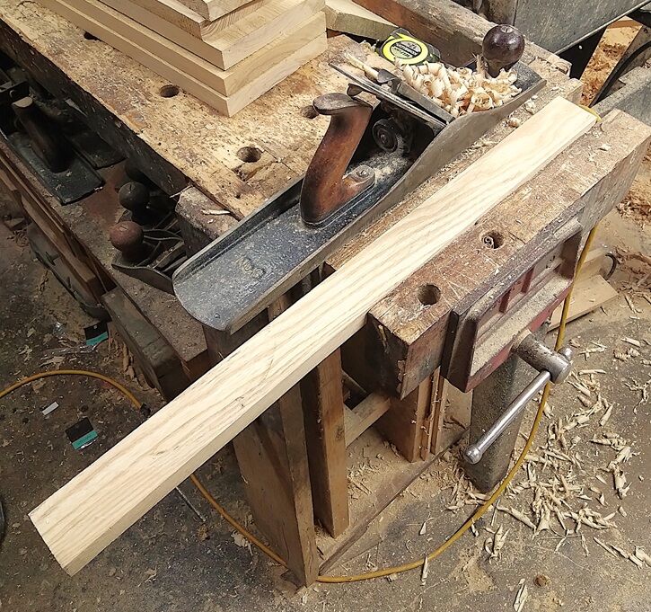

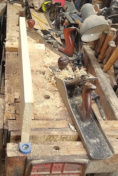

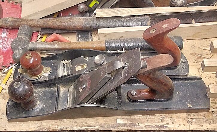

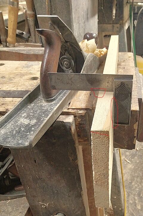

steven newman Posted Monday at 02:50 PM Author Report Posted Monday at 02:50 PM So..while waiting on the leg blanks to cure...might as well look at these 3 parts.. Need edges jointed, sure...but, I needed to flatten the boards first.. On another site, someone thought that holding a board in the bench vise to be planed..was "WRONG!" So..set up a plane stop, and a blue dog Faces were still rough sawn, and had a slight cup to them.. Just enough to throw things off.. Once I have things fairly flat with the No.6c.... The WR No. 62 would go over the surface, trying to get it a bit smoother.. There was a bit of a twist... That also got planed out.. So, in addition to getting rid of rough sawn stuff, flattening cups, I also had to remove the twists.. Same board...made a big mess on the floor... I had 2 such piles to sweep up.. Now, about the jointer work... Sorry guy, this is NOT going to work..so.. I went back to making Moxxon TP...when the "Roll" is full width and full length.. And that square FINALLY says the edge is square to the face...turn the board over, and do the other edge... Once all things are planed, and ready...spent a bit of time, trying the get the grain to almost match up... Spread some glue..add a few pipe clamps...and let it sit for a day or 3... 2 pieces from the earlier planks...will now be turned into Bread Board ends.. Show Face Option #1 Or, turn the board over.. Option #2....We'll see.. Today is a Monday...not sure IF I'll head to the shop, today.. Need to work on the blanks for the legs.. Needs to be 4-squared to 1-3/8", cut down and square the ends to 18" each...then...they will get a beaded corner, and then tapered on two faces.. Stay tuned... Grandpadave52, 4DThinker, lew and 1 other 3 1 Quote

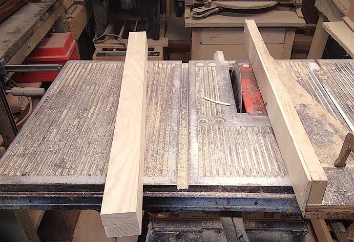

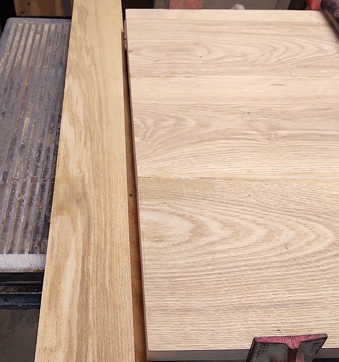

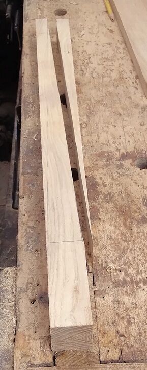

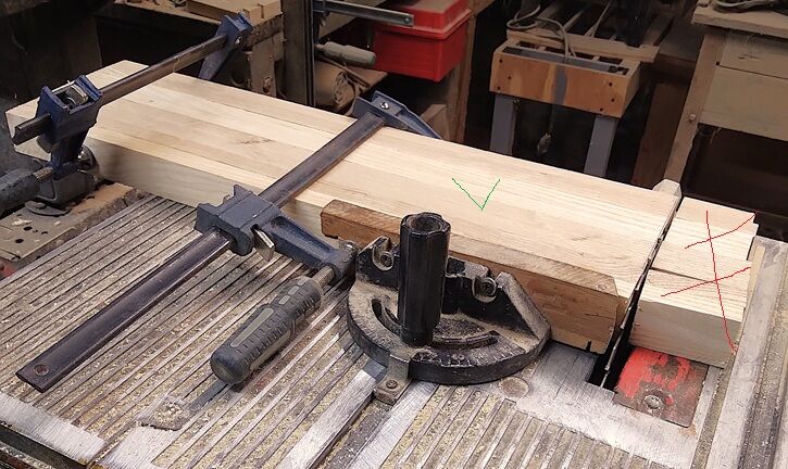

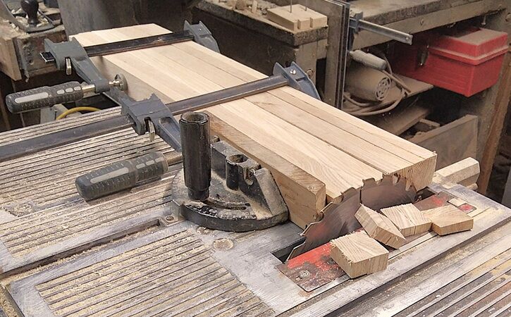

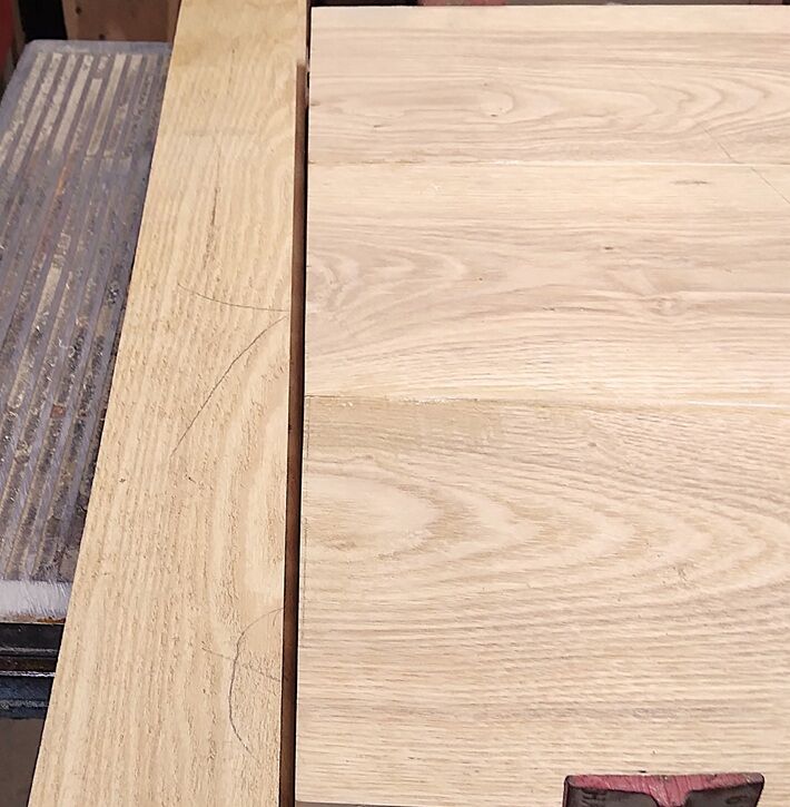

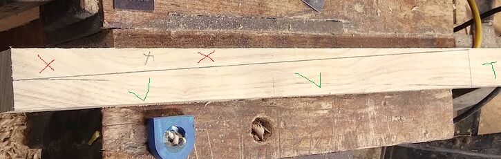

Popular Post steven newman Posted Monday at 05:59 PM Author Popular Post Report Posted Monday at 05:59 PM Well..Boss had her errands moved back to Tuesday...so..today is a Freebie Needed to joint one edge.. On each leg, that I can run along the rip fence...and remove the nasty edge 90 degrees from that jointed edge..once all 4 legs were run through, reset the fence to 1-1/12".. And run the remaining two edges through... Ends...gang the four legs up and clamp to the Mitre Gauge..once the fence was out of the way.. Goal was to get a square end...moved things around a bit..and extra clamp at the just cut end...before I removed the one at the other end...turn the mess 180 and clamp to the Mitre Gauge again.. Final length is about 21" or so..and they all match each other... Need Aprons next....because I need to lay out where the leg tapers will start/end...so 2 sides, and 1 Back.... Yep, these were a bit rough, needed to be a bit flatter, too...we have ways.. Roughness gone, cupping gone.. There was a big Hollow right about there...so I merely leveled the hills around it...so it is all "Flatlands" now.. Taper layouts.. came down 1" from the apron's bottom edge, make a mark...down at the far end, come in 3/4" and mark for the Foot of the Leg..connect the dots.. Bandsaw blade is starting to get too dull.. But.. I'll keep the cut-off as a pattern, for the rest of the taper cuts..usually on the worst 2 faces...keeping the best 2 for show... Hmmm..Monday? Meh... DuckSoup, 4DThinker, Gerald and 2 others 4 1 Quote

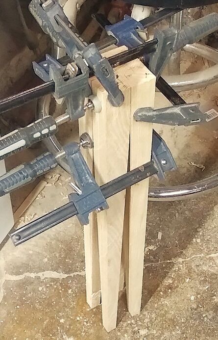

Popular Post steven newman Posted yesterday at 05:21 AM Author Popular Post Report Posted yesterday at 05:21 AM Thought MAYBE the blade was dull, so.. Tried this one out...turned out, it was even duller than the one I just replaced...it burned it way along..so.. These 2 had quite a bit of work to do...plus a bit of work with a No. 3... yeah, almost too much work...but.. They didn't turn out too bad... "T" stands for Taper...it also stands for where a Tenon will be... Let them sit for a day or 2.. Let them just stand there..yes.. There is 4 legs standing there... Stay tuned... Grandpadave52, lew, 4DThinker and 2 others 5 Quote
