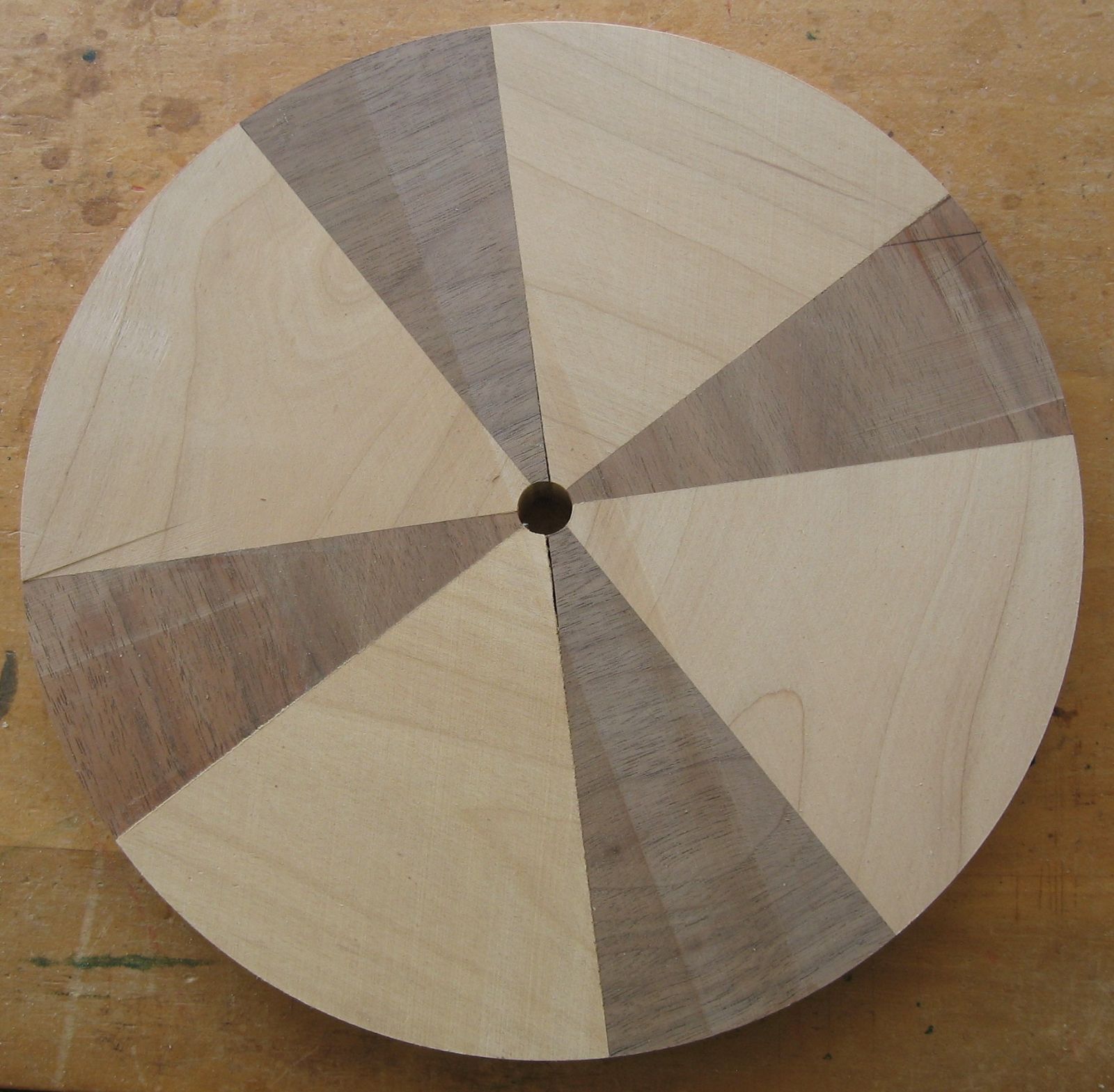

Are you limited to segmented rings or can you do a wedged circle? Cut your full thickness wood into the appropriate number of wedges and glue it up like a platter. Drill a 1/2" hole in the center and put a 1/2" bolt and nut through the hole and put the bolt into a chuck and turn as you are wanting to. This gives you the opportunity to shape the face and edges and then reverse the blank to cut a recess for the plywood backer. Use a parting toll to cut the frame free from the rest of the blank and finish.
Something like this but with the desired number of wedges.

OK, couple of replies to the above. I'm not limited to segmented rings, I chose that method because it's something I'd like to try. That said, Gerald and Tony mention sort-of the same thing, do a platter or wedge circle and I like the mixed woods idea that Tony pic'd. Since I'm doing 4 and I didn't plan on them being identical I may try all the ideas. Lew asked about my cole jaws and the OD large dimension is 9 7/8", my rings will be 13". ID of my rings is 10". But Gerald also mentioned the MDF backer, which is kind where I started only I was thinking plywood, so I have several options here to work from. Thanks Guys, once (if ever) I get started I'll post back with success, or more likely, failures of my attempts.
