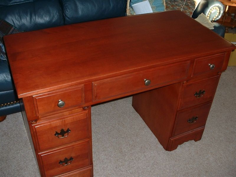

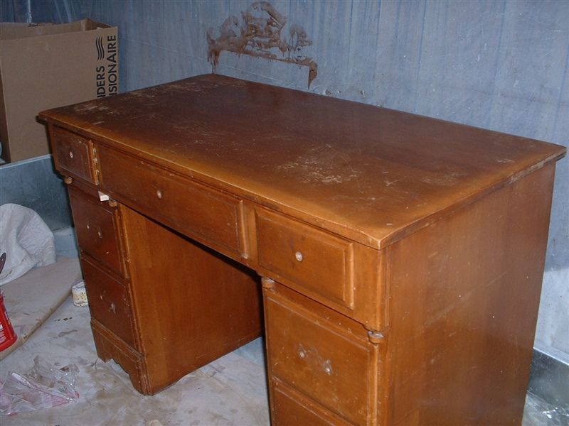

strip and refinish job
KeithMealyDeskabeforesideresz.jpg.97303a4a5955350f3a2bda53e5985ed3.jpgKeithMealyDeskbafterresz.jpg.d36ee542e0e380cf7f341c2cc214080b.jpg

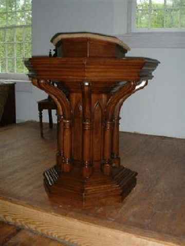

strip and refinish job for an historical center

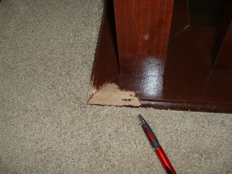

repair job, one of about five for this customer

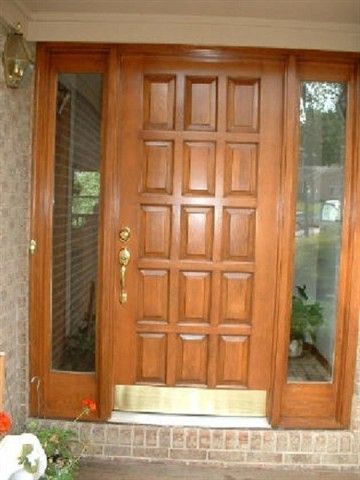

door_before.jpg.bb93853c71846dd08db81eef960f2d28.jpgdoor_after.jpg.22022dd7a603646493303cae2d07c090.jpg

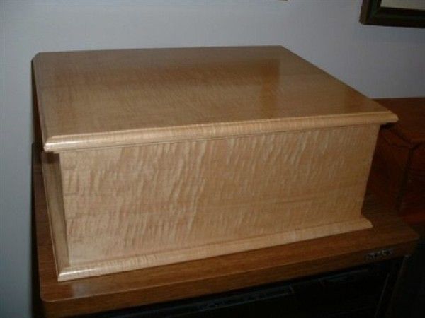

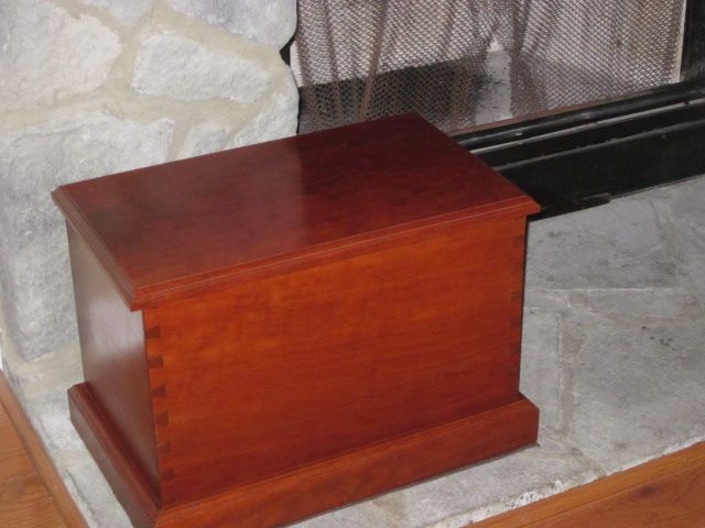

Box I made featured in a finishing book

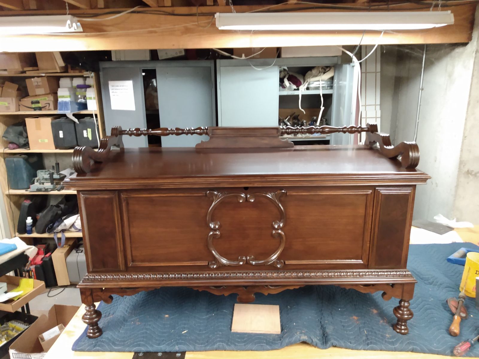

strip and refinish job, 1930's cabinet for daughtercedarchest.jpg.4c0f8ae7bd005c0b5e09d031c2ecce0d.jpg

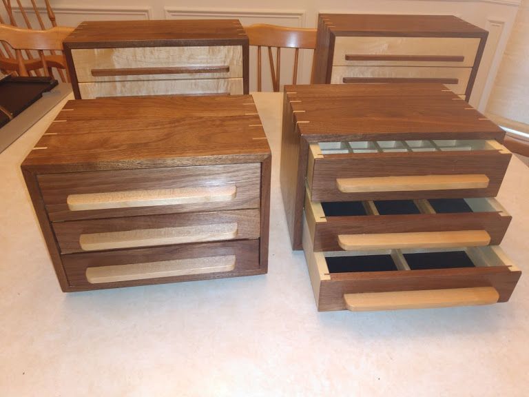

Jewelry boxes made for granddaughters, walnut reclaimed from church door
Box made from one piece of cherry

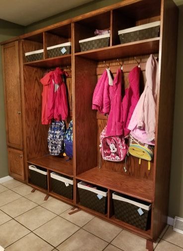

58574764_361818851207509_8248696794632945664_n.jpg.92214c0341cde275b522fab5075fb478.jpg

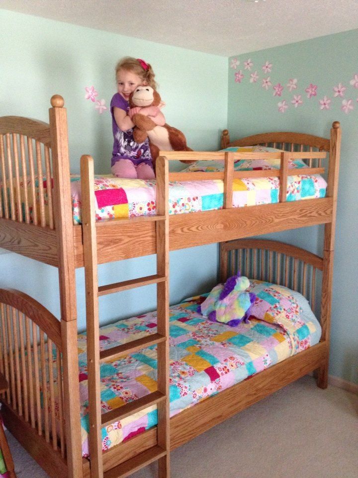

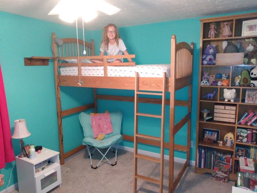

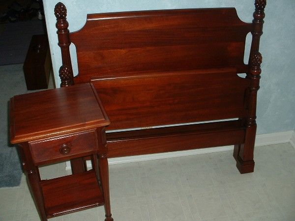

Bunk beds for granddaughters, later converted to loft for one of them.1209265_10201710221342107_2007454753_n.jpg.214f7c7aa69e930f2c0a26018fb42961.jpg

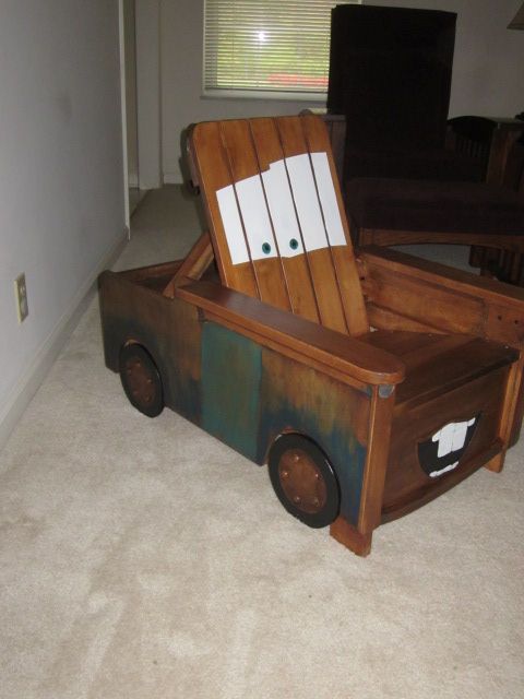

Tow Mater Adirondack chair made for grandson who was a fan

They are all a little different.  A variety of sprayed on water-borne finishes, shellac, lacquer, varnish, stain, glazes, and toners.   Some sprayed, some brushed, some wiped on.  One finish does not suit all applications.
I can highly recommend Bob Flexner's "Understanding Wood Finishes".   It was an eye-opener for me that had previously found one finish that worked and I used it on everything without really understanding how it worked.  Another was Sue Nobel's book who did a number of different projects and frequently used glazes.  Sue was a local refinisher that I got to know.
