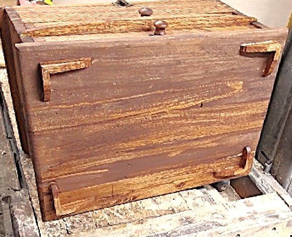

Popular Post steven newman Posted November 25, 2024 Author Popular Post Report Posted November 25, 2024 Got the 2 drawers fitted to the case...so.. Base needs work... Rounding over tools? To turn a square edge.. To match the other 3 edges...Beveled with a plane until almost round,,finish up with the sandpaper.. And done...glue and clamps, next.. Only 3 edges, because... Nothing to glue to...Had a bit of trouble, getting one drawer to fit... As for the other drawer? Compost happens..despite pulling diagonals to fit the same exact center point to drill a hole? Tomorrow's task? Turn that strip into a pair of bread board edges, and add them to that panel..to make the lid.. Stay tuned.. HARO50, lew, Grandpadave52 and 3 others 6 Quote

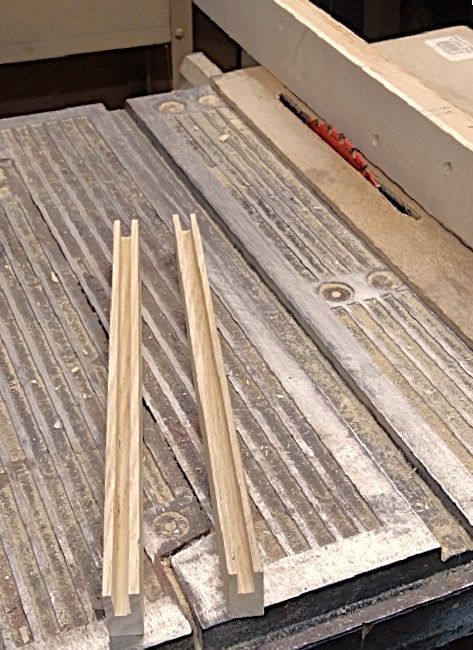

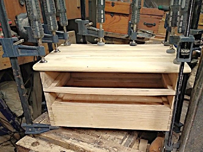

Popular Post steven newman Posted November 27, 2024 Author Popular Post Report Posted November 27, 2024 Square the lid's panel.. Trying to get each task done, before I need to reset the saw..so.. cut for length...next..rip fence required... Ripped right down the middle...note the push stick...Next reset.. A pass each way, left a thin center...note the Zero Clearance Overlay? reset the fence a a bit.. And clean out the center...groove was made to match the tongue on the ends of the panel.. Which needed a jig to keep itself FLAT.. This end was bowed a bit more than the other,,,this pulled both flat..then .. Run both ends through, on both faces...Jig was set to the top of the fence for clearance... Next..spread some glue along the tongues ( yummy?) Clamp the Bread Board ends in place, and let this sit a spell...Bench vise and the 2 red clamps are pinching the end of the grooves flat... Stay tuned... lew, HARO50, Harry Brink and 3 others 6 Quote

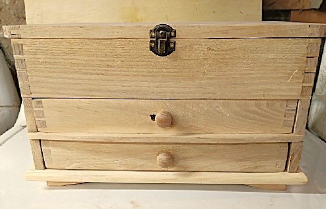

Popular Post steven newman Posted November 29, 2024 Author Popular Post Report Posted November 29, 2024 All cleaned up... And ready to install the Hardware... Then work on adding the feet to the underside of the base.... Stay tuned.. Harry Brink, HARO50, Gerald and 4 others 7 Quote

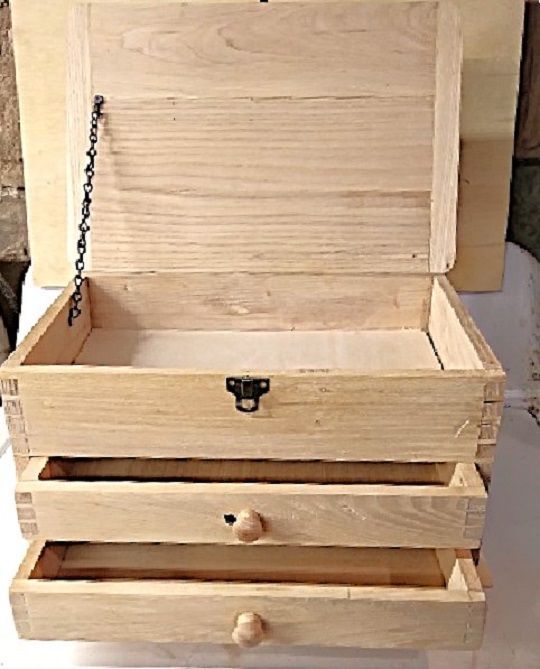

Popular Post steven newman Posted November 30, 2024 Author Popular Post Report Posted November 30, 2024 To install the hinges and other hardware....a few tools were needed.. Eggbeater ( Stanley/ Defiance) has a 1/16" drill bit. Screwdriver is a Phillips...and a sharp pencil...and the candle to wax the threads of the screws..Hinges first... Brass plated screws, in "antiqued Brass hinges..Clamps so things don't try to run away... Before the latch could be installed.. Had to level where it will sit, front of the case was a hair higher...we have ways...then... Latch was installed....then a handle on each end.. And..make sure the lid works as needed... Will add a chain stay later... Case gets feet! Mitersaw to make both halves...then bandsaw a bit of detail... Then glue to the bottom of the base... Will sand these smooth and clean, once the glue has cured...along with a chain for the lid... Cut for length later.... Was NOT happy about the one drawer knob being offset from the other..so.. Sliced off the old knob, turned the remains to look like a knot, and remade a new knob and glued it in line with the other knob... Waiting on glue to cure... Stay tuned... DuckSoup, Fred W. Hargis Jr, Harry Brink and 3 others 6 Quote
Popular Post steven newman Posted November 30, 2024 Author Popular Post Report Posted November 30, 2024 Lid now has a chain to act as a "Stay" And..opened up.. A view of a handled end.. And round in back.. And..all closed up... Awaiting a final sanding, a coat of Witch's Brew...and a shiny Top Coat... Stay tuned.. Harry Brink, DuckSoup, HARO50 and 3 others 6 Quote
